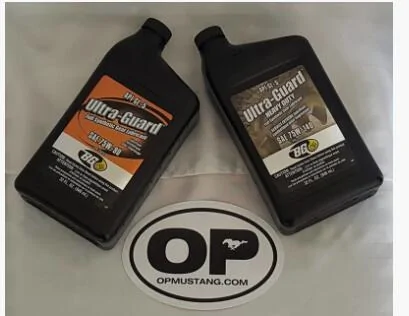

It is likely the additive is broken down and the Torsen is just 'working' better. Ford uses the additive to calm down the Torsen. The 140 will just offer better resistance to heat, maintaining viscosity while hot. It flows the same cold.

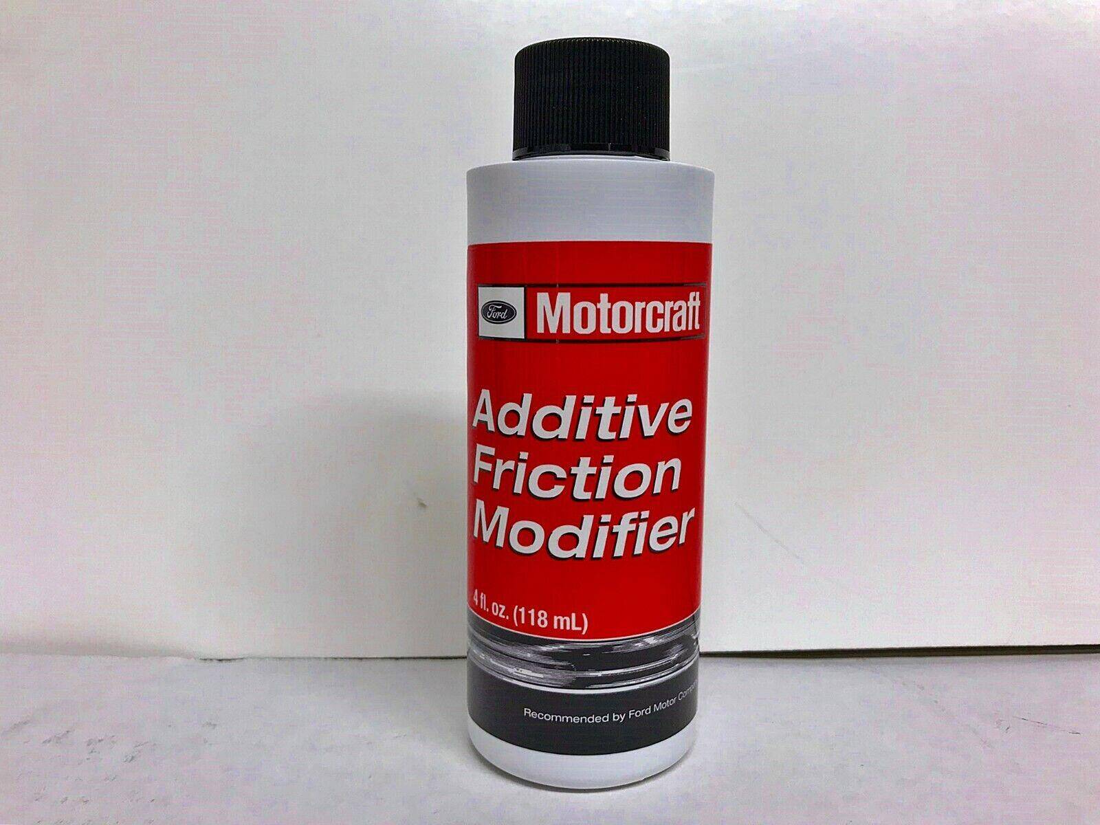

Most auto parts stores carry this. Use the OEM spec weight and this according to the direction in your manual.

If your Diff. is making noise there is a problem. Thicker lube is only a Band-Aid. You may have scored races or a bearing going bad, or even a chipped tooth. Pulling the cover and checking things out is the way to go.
It makes noise at low speed turns. My car brand new did this from the factory likely because there was no additive in it or not enough. Changed the fluid to BG Ultra Guard LS and it went away, 8 years ago. Its the additive package in his current oil with ??? miles on it that is broken down, not the differential.
