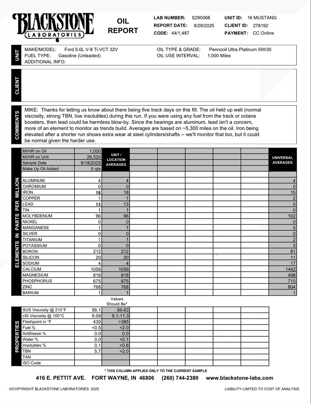

Should I be concerned about the iron and lead? With a perfect engine those should be zero, right?

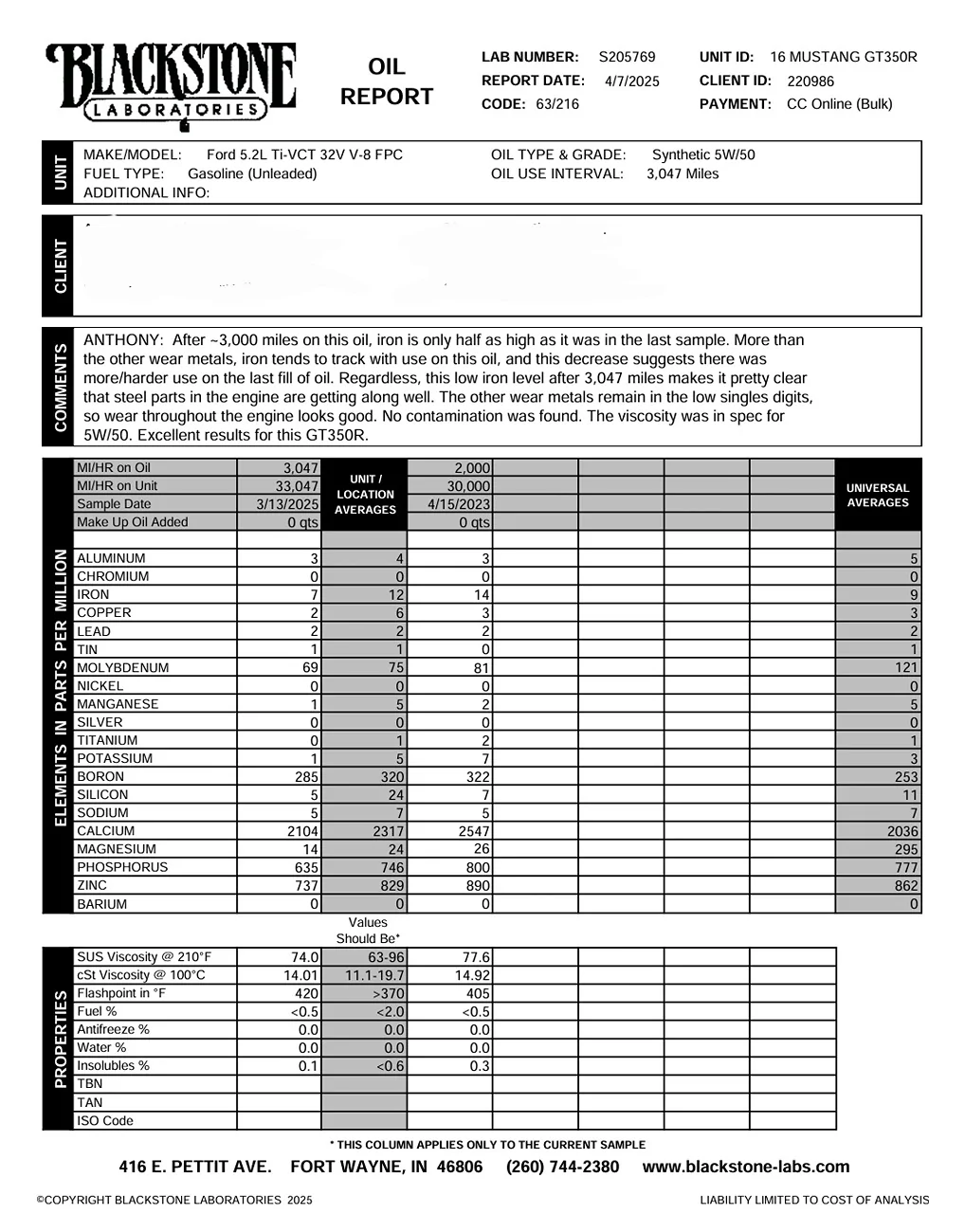

Here are some comparables. 30k 350R and a 11k mile GT500.
Do another oil change after 3k and no track time and see where you're at. It will most likely clear up.

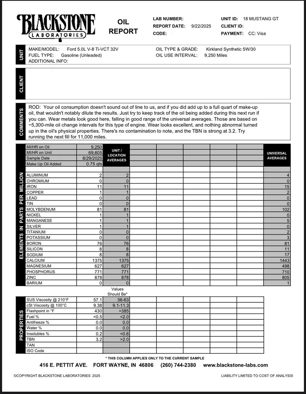

I usually change my oil before 8K miles but I decided to see how results would look if I pushed the mileage out more. I did not track the car on this oil and I can’t remember if I added 0.5-1Qt within this 9K interval, but made a note that I may have to blackstone. I also paid to include TBN analysis for oil health/life. Results were great, despite now having very audible and random typewriter tick after most recent oil change. Blackstone even suggests pushing the oil change out to 11K to see what happens.
Your iron and lead levels don’t seem too out of place compared to the norm or to my results, especially considering you had multiple track days on it.
Here are my results testing wear on an extended oil change:

Driving 3k miles without going to the track might be a challenge lol. I space my track days out and change the oil at the end of the season.
Neither of you seem to have much if any lead. Kinda confused where the lead would come from, even with Blackstone's statement. I only get 93 at the track and it's a separate pump.
I guess I'll take two samples next year and monitor the iron?
At least PUP 5W-30 appears to be holding up well for my usage. No need to get TBN again.

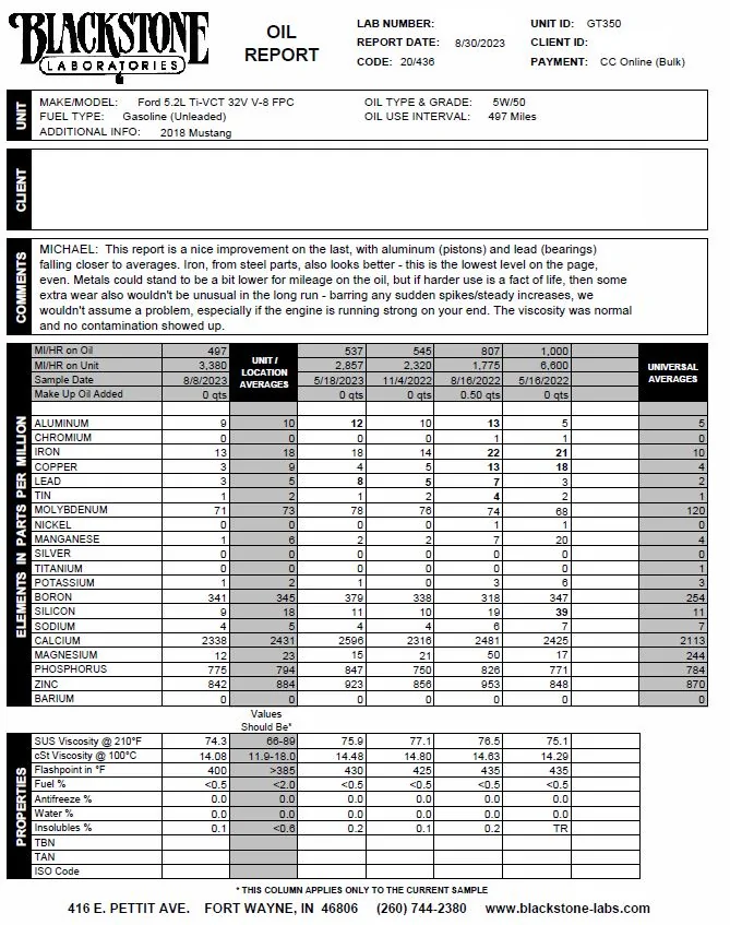

This is 5 reports from my old GT350. These reports were right a brand new gen 2 motor was installed. It was basically only really driven at the track once the break in miles were achieved on the new motor.
This will give you more to compare to. The column on the far right was after a 1,000 (break in) miles on a brand new gen 2 motor. Then moving from left to right is a sample after 807 more miles then 545, etc -- which would have been basically all track miles. I changed the oils that often because of track use.

I understand that this will not catch everything and they’re only targeting small pieces of wear items. I did not see anything large in the filter or drained oil.
To those not a fan, are you stating I should not worry at all and this is flat out nonsense?
Do they use lead in the bearings on the Voodoo and not the 5.0?
Yes this is the main thing I am confused about.
I am assuming I have increased wear from track use but lead>=10 seems very uncommon on these motors which is why I am concerned.
The iron is a given. Many have noted higher wear resulting in elevated iron from track use.
I am saying sure, be concerned, but realistically, the physical oil change, and your own findings in items I've listed (And I am sure other users can chime in on what they look for), in combination with what an analysis says, should be your decision maker.
The lead....I don't know where lead is in your engine. I just don't know enough about the Coyote. AI tells me there isn't any in a stock GT set up.
Have you owned the car since new? Is it possible another owner replaced the mains with a trimetal of some sort?
I have owned the car since new.
The engine has the FP power pack 3, FP aluminum cam covers, and the FP VCT solenoids.
