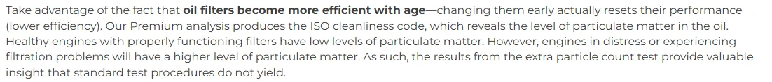

SpeedDiagnostix offers a service that also include particle count. It's their Premium Sample. It counts the big pieces, along with the ones you cant see.

Do they do an ISO code? I work at a power generation plant and when our oil is analyzed and we see ISO particle counts to better assess oil cleanliness. That would be ideal versus relying upon Blackstone reporting concentration of wear particles and level of silicon.

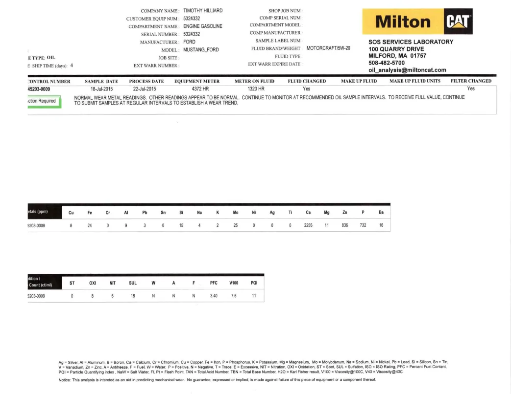

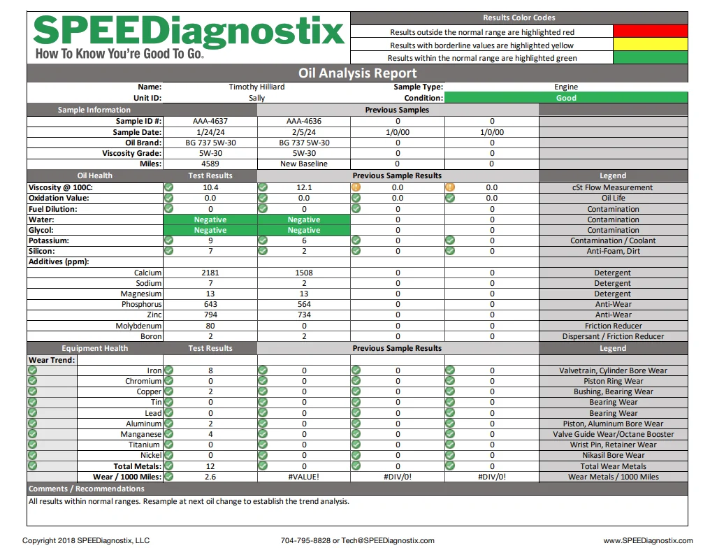

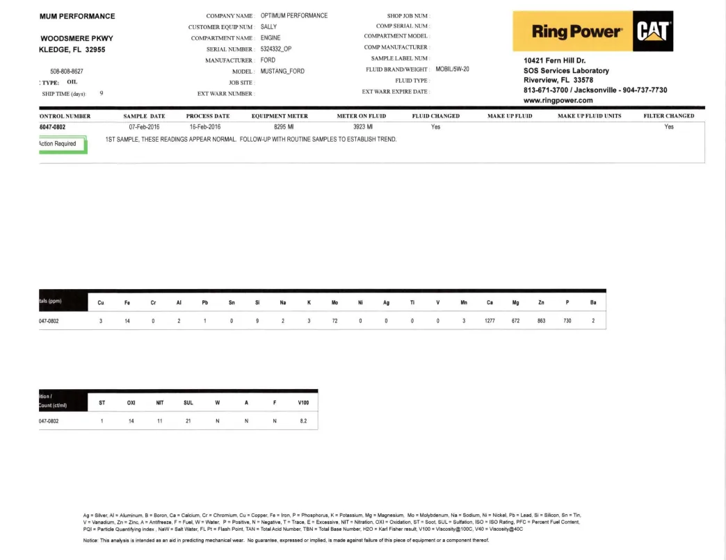

Our Shop car, sample from around 4K, 8K, and a sample from last year with around 20K on it. That last sample was 5 year old oil. Take note of the metals dropping over time. Does Blackstone ask you what fuel you are running?

This is awesome. Thanks for posting, bookmarking it now!
