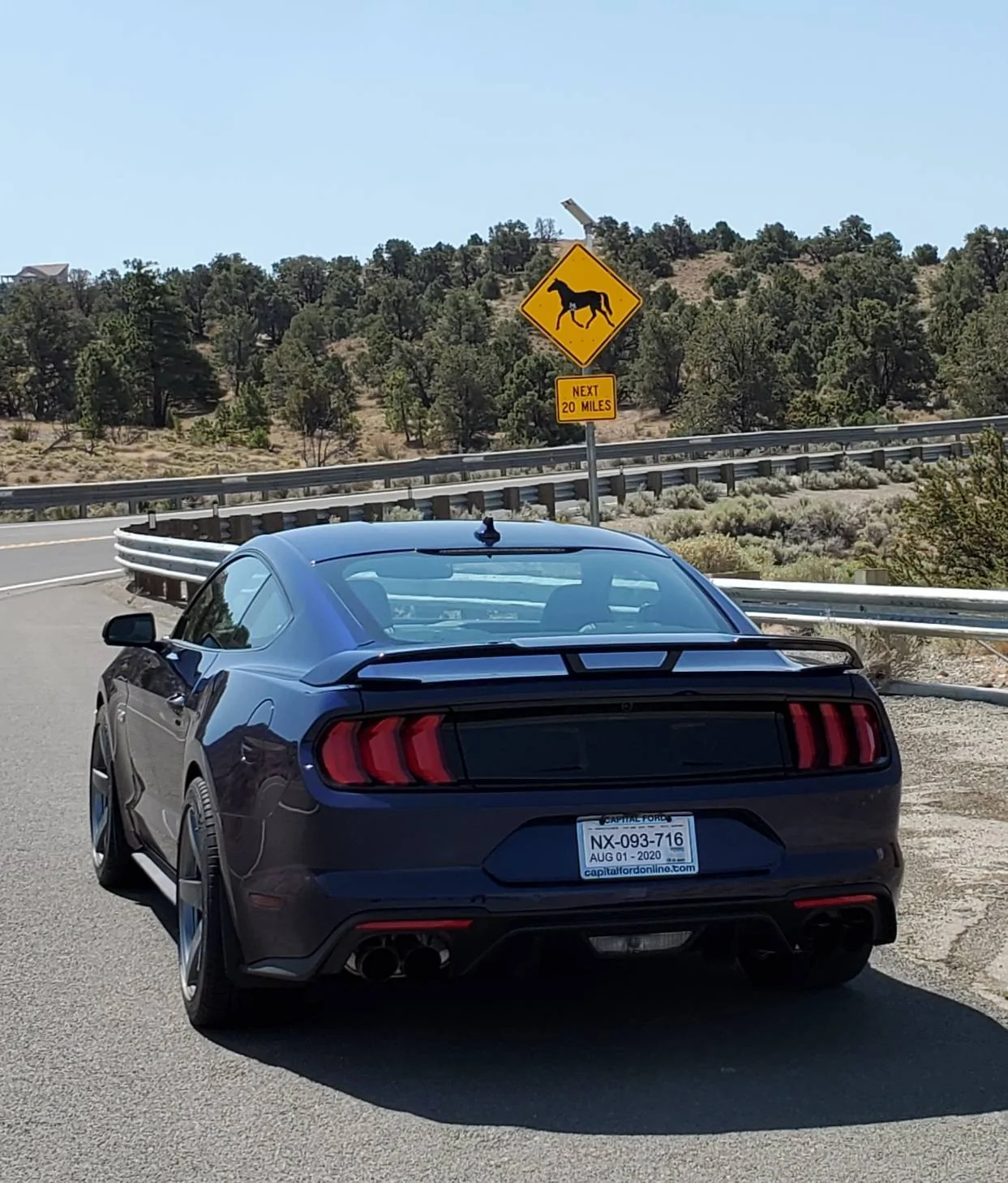

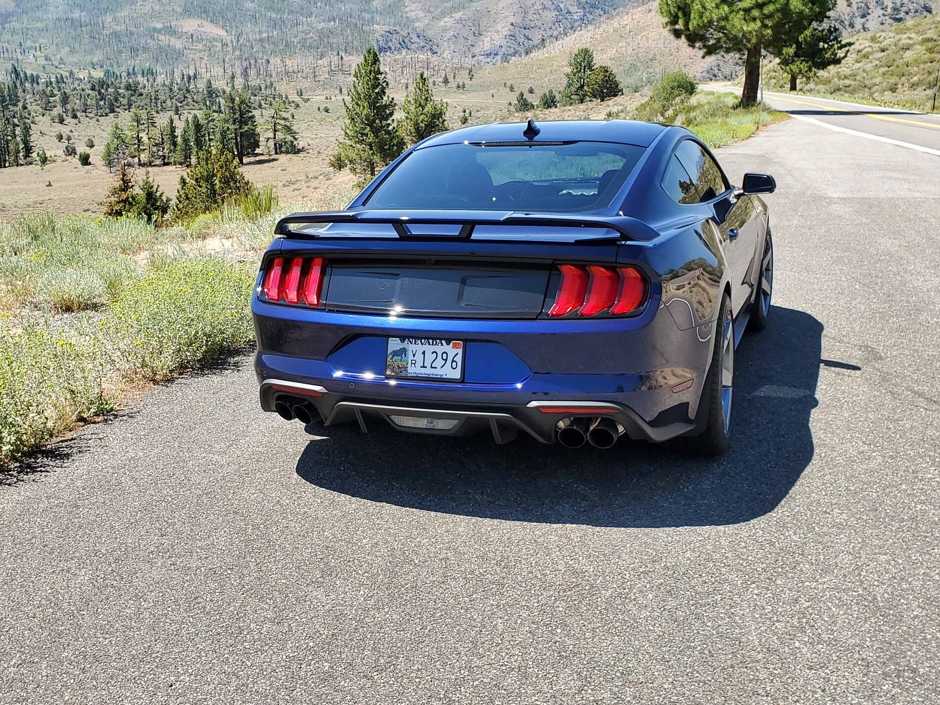

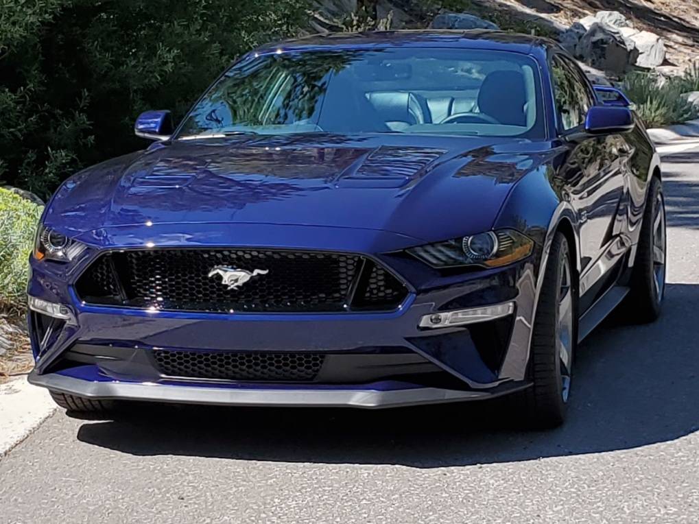

Not the best pictures, but these are 19x10 +35 front and rear. 9.5 +35 fronts will be tucked in a little more, while 10.5 +35 rears will poke out a little more. Anything less than +35 will have more pronounced poke, in addition to possibly putting more stress on wheel bearings.
For reference, these tires (tyres to you) are 275/40 all around.

Yes. 10.5 ET45 is nearly perrfect on the rear. An ideal fit IMHO. Ita about 4mm less poke than a 10” ET35 pictured above.
The 9.5 ET35 front would be fine too but I think 10” ET35 is perfect on the front so whatever. Thats only a 1/4” less poke on the outside edge.than the fit above so not much more inset.
Frankly, I prefer the 10” ET35 pictured above with 285 square tires which you can rotate. The stagger doesn’t help handling or grip really and going square makes it so much easier to rotate and extend tire life. Staggered setups are conservative for drivers who aren’t used to balanced handling, but its just not needed IMHO.

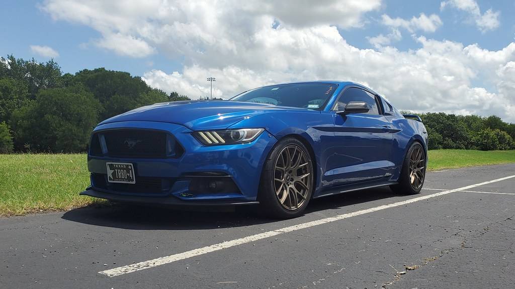

These are 19x9.5 +35 with 285/35R19 tires all the way around.
