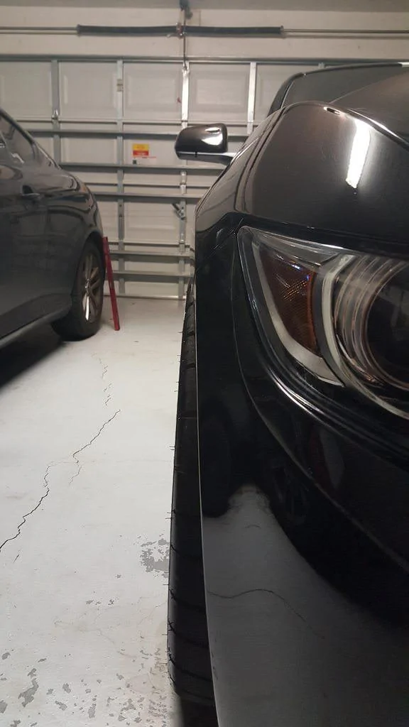

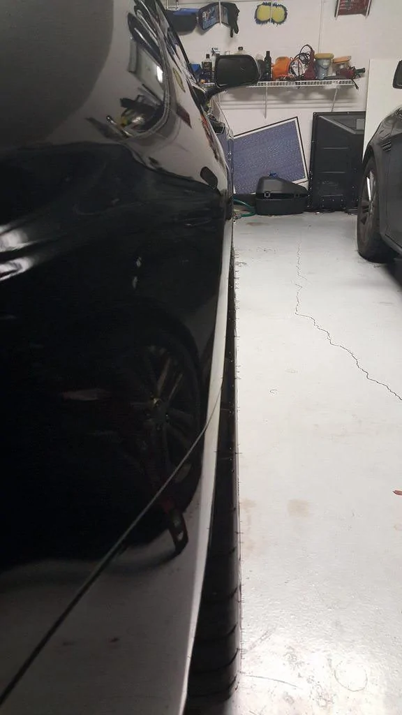

Here's some pics that Paul set me up with for that wheel size but with a +30
