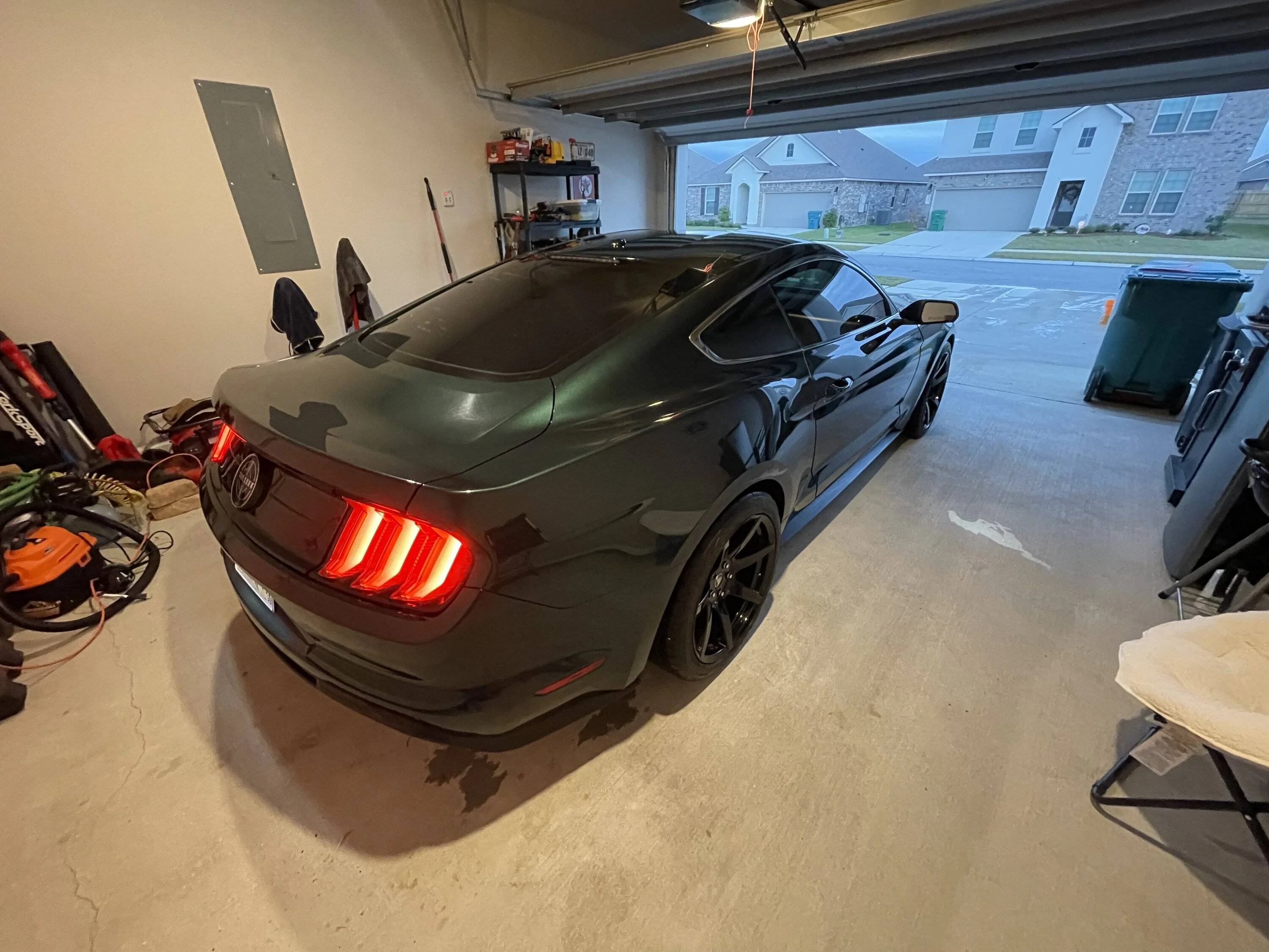

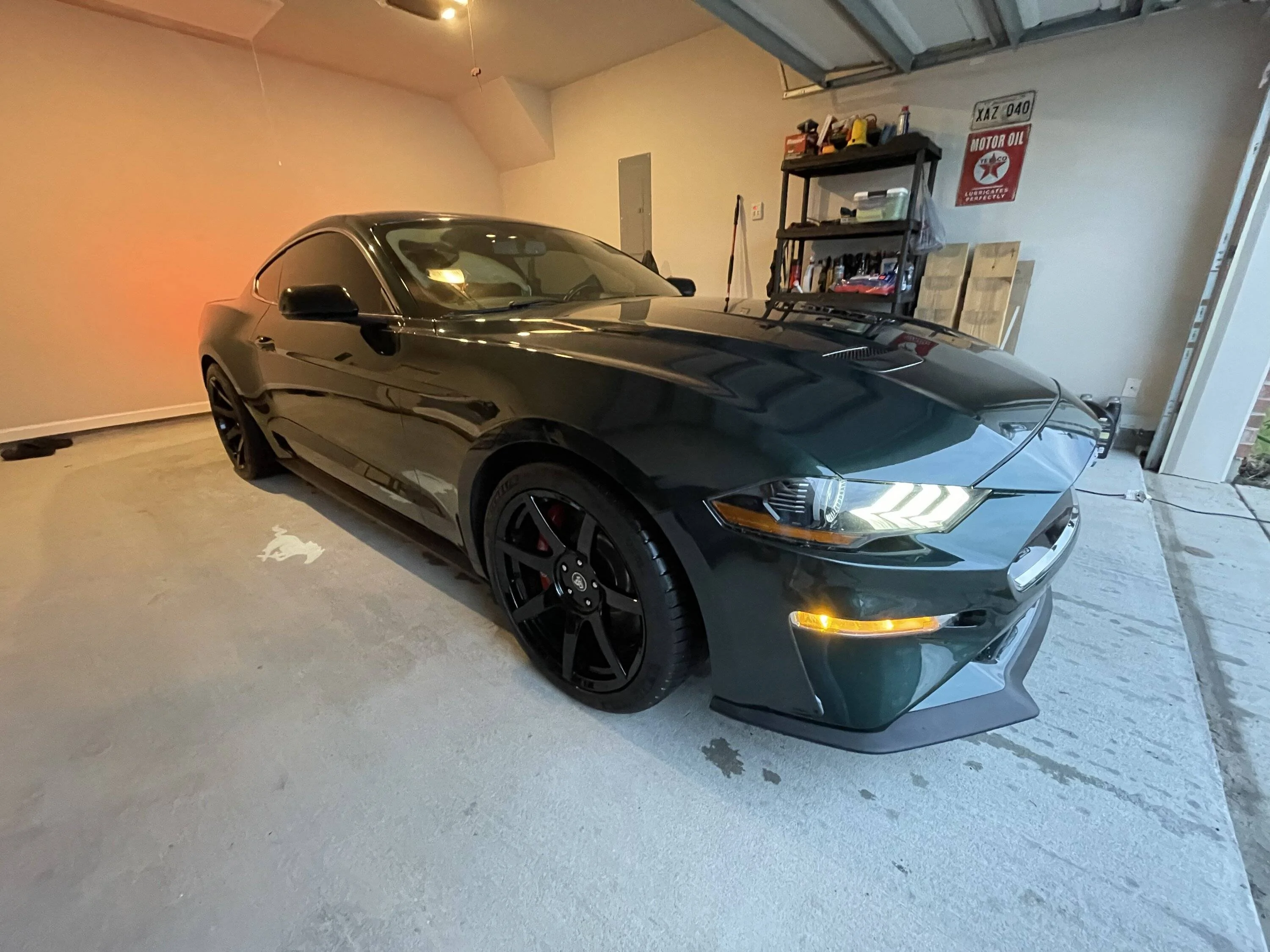

Hey all, first off thanks for the add! Long time lurker here.
I have a 2019 Bullitt currently on project 6GR seven wheels, and I’m looking to get a set of Gramlight 57CRs soon since I found a potential deal. Looking at 19x10.5 +25 and to ideally run 285/35/19s (or 295 if that would fit better) squared so I can rotate my tires. Currently staggered with 305 rear and 285 fronts.
From what I’ve found, the +25 should work on the front with 285s, but for the rear am I going to need a spacer? If so, what size would be ideal for the 285s? No plans to lower the car for now, so that’s not a concern, car is stock otherwise.

The front likely would be fine (depending on your camber), but your rear will poke out significantly (by about 16mm). Nothing that you can do with a spacer to help that. you'll have to run pretty aggressive rear camber to try to get them to tuck in.
You'd rather have a wheel which is more conservative offset and fits the rear better, then use a spacer to get the front fit correct.

10.5 +25 is somewhat aggressive. No need for spacers since that would poke out your wheels even more. I would say the front is doable with camber around 2.0 degrees. The back will definitely poke unless you want too add a lot of camber back there.
I personally run 19x10.5 +35. I personally would not go more aggressive then this for the rear.
