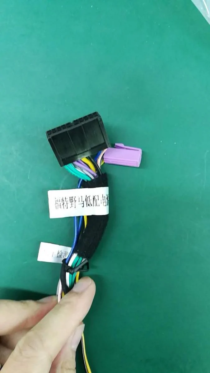

My theory for testing this is, I had an old cell phone that I wanted to flash a recovery image to, but the standard "VOL + Power" routine didn't work, and you had to pull the battery, then plug it in USB and voila, it was in "Download Mode" and I was able to use Odin to flash the files to it. If that works with this, then I'm gonna be happier than a pig in shit.
I made some other interesting findings too, but it may be useless information.
With just the MAIN power harness plugged in, and the screen connected, the screen will not come on. If the small purple connector was plugged in, then the unit booted- Here's where it gets strange- I could then disconnect the purple connector, and hit the Start button on the car to kill power to the unit, but it would still continue to boot! With "RUN" power off, if I reconnect that purple plug, it shut the unit off. That tells me the "On/Off" connection is somewhere in that purple harness, if it helps at all, @StangATX .

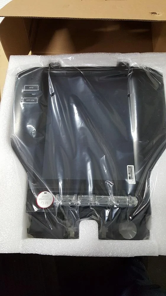

I got my Tesla today. My question is do we remove the old head unit and Sync? Can we sell our touch screen with Sync to someone with a base stereo, or do we still use some of the factory stereo?
PatrickHenninger
PatrickHenninger
Jan 20, 2016
1,185
645
Richlands, NC
2015 Mustang GT - Oxford White
It all comes out, Sync and touch-screen. Sending you an email about the touch screen.

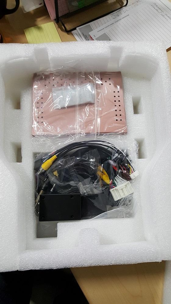

WOHOO mines in (mostly)
I have a few questions though.
1. There is 0 voice at all? Not even a google voice or siri through the stereo?
2. No play store or google maps in the apps launcher (I did find the play store and google maps installed though and they work flawlessly)
3. I have non performance pack, does that little 2 ended wire with (the one that can loop into itself) go anywhere on my car?
1. Not yet. We're working on it.
2. Once you install an app through Play Store, it should show up there.
3. It does (optionally) See the first post in the thread, it covers connecting it for more CANBUS integration. (Makes tachometer and door warnings work)
