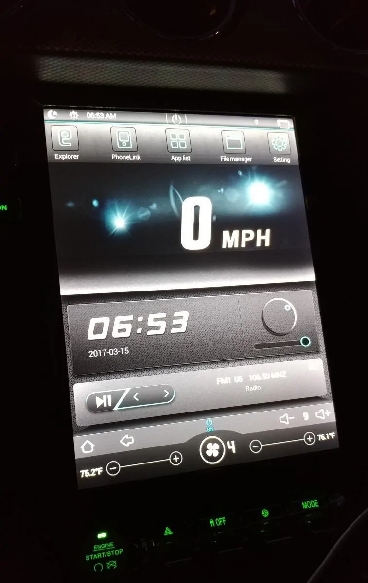

This unit only works as a replacement for those with the Base model radio (4" screen.)
Latest UI:
This thread is dedicated to things KNOWN about the 10.4" Vertical Tesla
Style Head Unit running Android. This unit is Plug & Play. No cutting, splicing, or soldering required for installation.***

Here's what it looks like when playing Spotify using BT audio. It displays an oliscope and the track name. You can make this full screen and get rid of the mustang and Tach/Speedo.

Just a finding, the password for advanced settings is 8861 but there's not much in there.
Also, this unit DOES give you auto climate control! Set the temperature (which is now in Fahrenheit) and hit auto, you're done!
