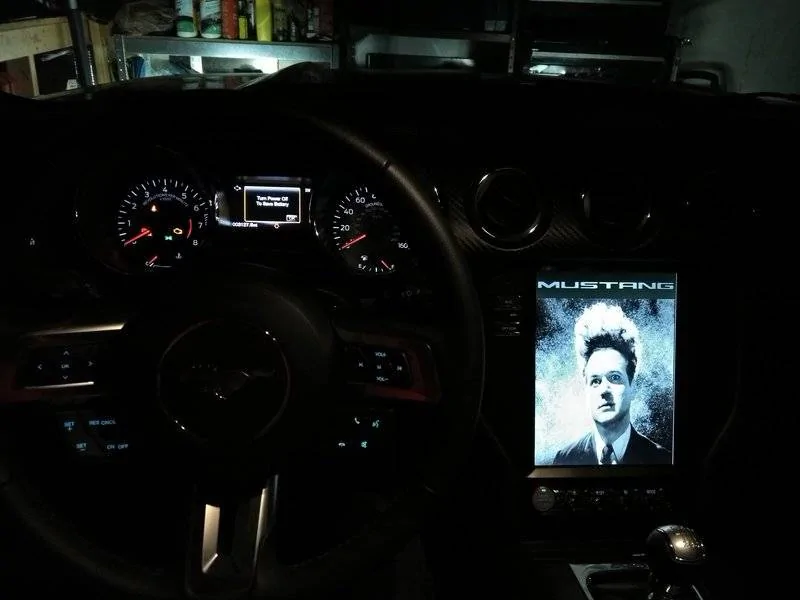

I use a custom boot screen... There's an app on the unit named something like "boot screen" and I was able to choose a file from my USB drive. I take it that's missing from the 2nd gen...?
I'm talking about an animation though... Kinda like a video boot up not just a static image :)

Ah, awesome. Then I can have a gif image of Eraserhead instead of just an image. Lol.
But it sounds like some people are having issues even changing the boot screen on the 2nd gen. Side question, do we know if the AC and On/Off boards on the 2nd gen changed or if they're the same.
