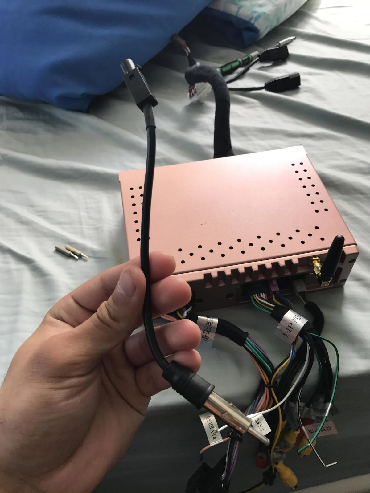

Blue connector is gps and i ran mine into the glove box.
And the white connector is antenna for radio? That white wire for me was only like 6 inches long and it looked like I was supposed to plug that into the head unit but the other end is supposed to plug into something else? But didn't know what.. any input would be appreciative.
Yes blue connector goes to blue plug in. And the white connector with the round black tube goes to white plug in. The black tube doesn't connect to anything.
Interestinggg. Okay well I am an idiot. Thanks!!

For the Radio I believe they forgot to include this harness. (it's from 1st gen) It seems that it'll do the trick...
http://i.imgur.com/Yh4vWH9.jpg
I will try to contact the manufacturer for it.
Please do! I was going to say, seems like I'm missing something lol I wonder if we can find something like that at an audio place?
