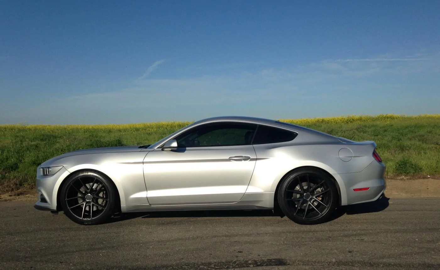

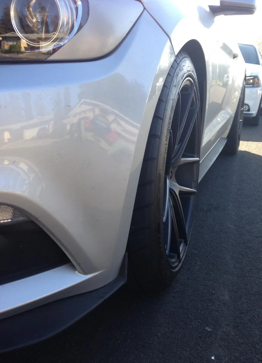

Very nice stance! What springs did you install?Boss 302S 19x10 wheels with 285/35r19 Continental Extreme Contact DW tires.
+47.5 offset with 5mm hubcentric spacers all around. It's very close, like 1-2mm of clearance from the strut. I will be fitting a set of 7mm spacer up front to check my comfort level on the lug nuts.

I'm running BMR springs. Minimum performance fronts/Performance rearsVery nice stance! What springs did you install?

Thats the exact combination i was looking to get! Did you have to cut the bumpstops even with the minimal drop front springs? How are you liking them so far?I'm running BMR springs. Minimum performance fronts/Performance rears
