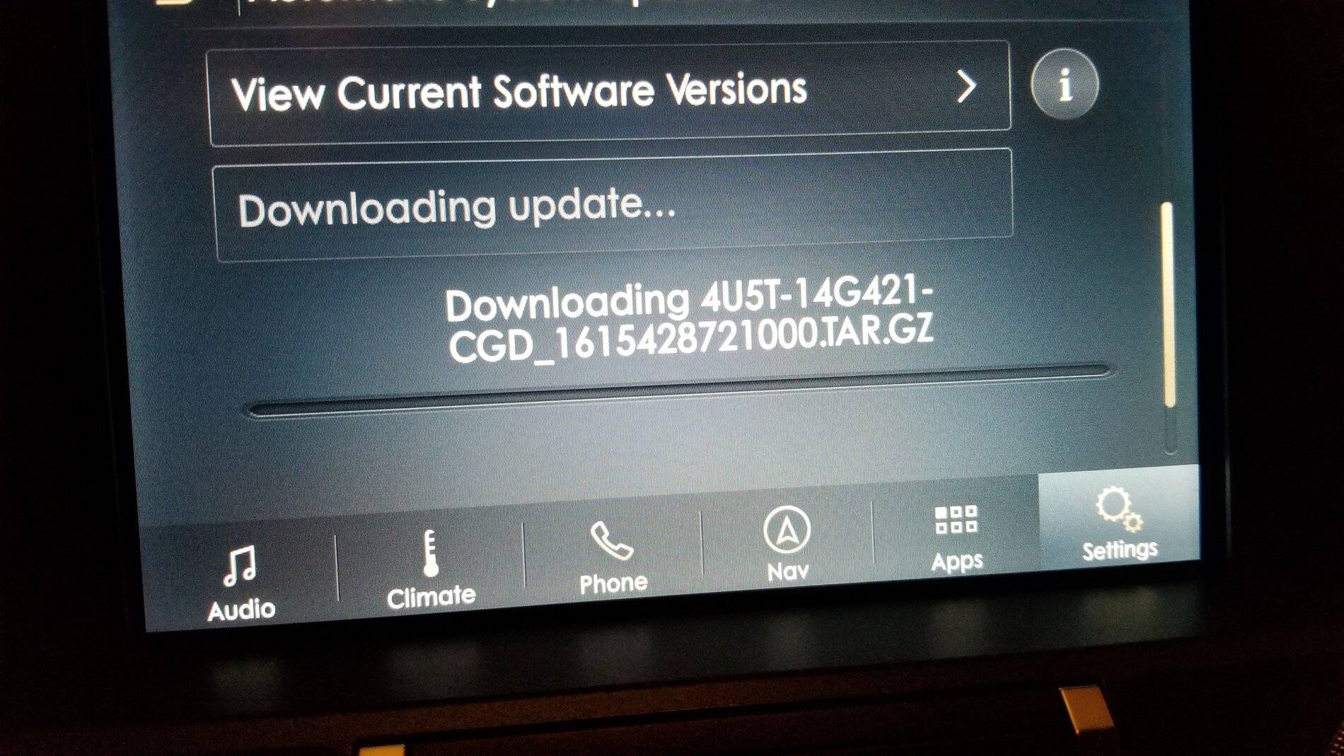

Downloaded via WiFi now. 1st download done. Now it’s doing a different one

My car just finished another download. This time I got the new map package NA 220. That's more cool than Gracenotes. :clap:
I take back the double face palm meme. Ford grabbed the wifi by the horns and is running with it.

Now yet ANOTHER download. What is it this time?

According to the resident Ford Sync technician on this forum, there will be about 10 downloads total. It's downloading languages, voices, etc

So what you’re seeing with all these extra files coming down is the latest map update. This consists of 13 files in total and is several GB in size. You may see NA 20Q2 as your map version and it’ll still be pulling files for other areas, Nav voice packs for the languages, etc. You don’t need to leave the car on for hours to get these. Use it normally and when it hits WiFi it’ll continue on in the background.

The confusing part is "when it hits wifi", it will download in the background. I don't think it downloads if the car is off and or not in accessory mode. I put mine on a charger and go out and hit accessory every 30 minutes to allow the downloads. I am on day 2 of doing this and still not finished.
