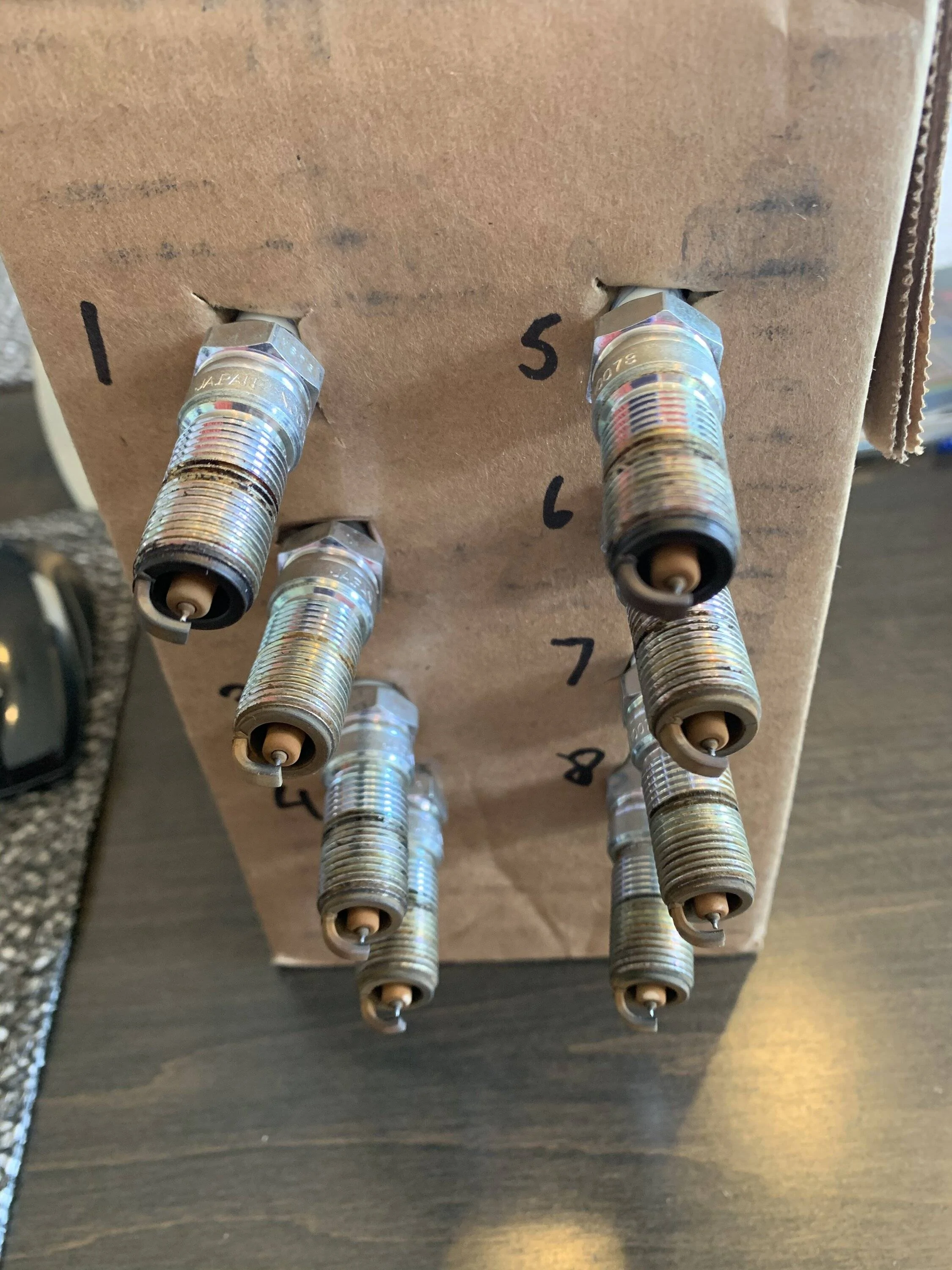

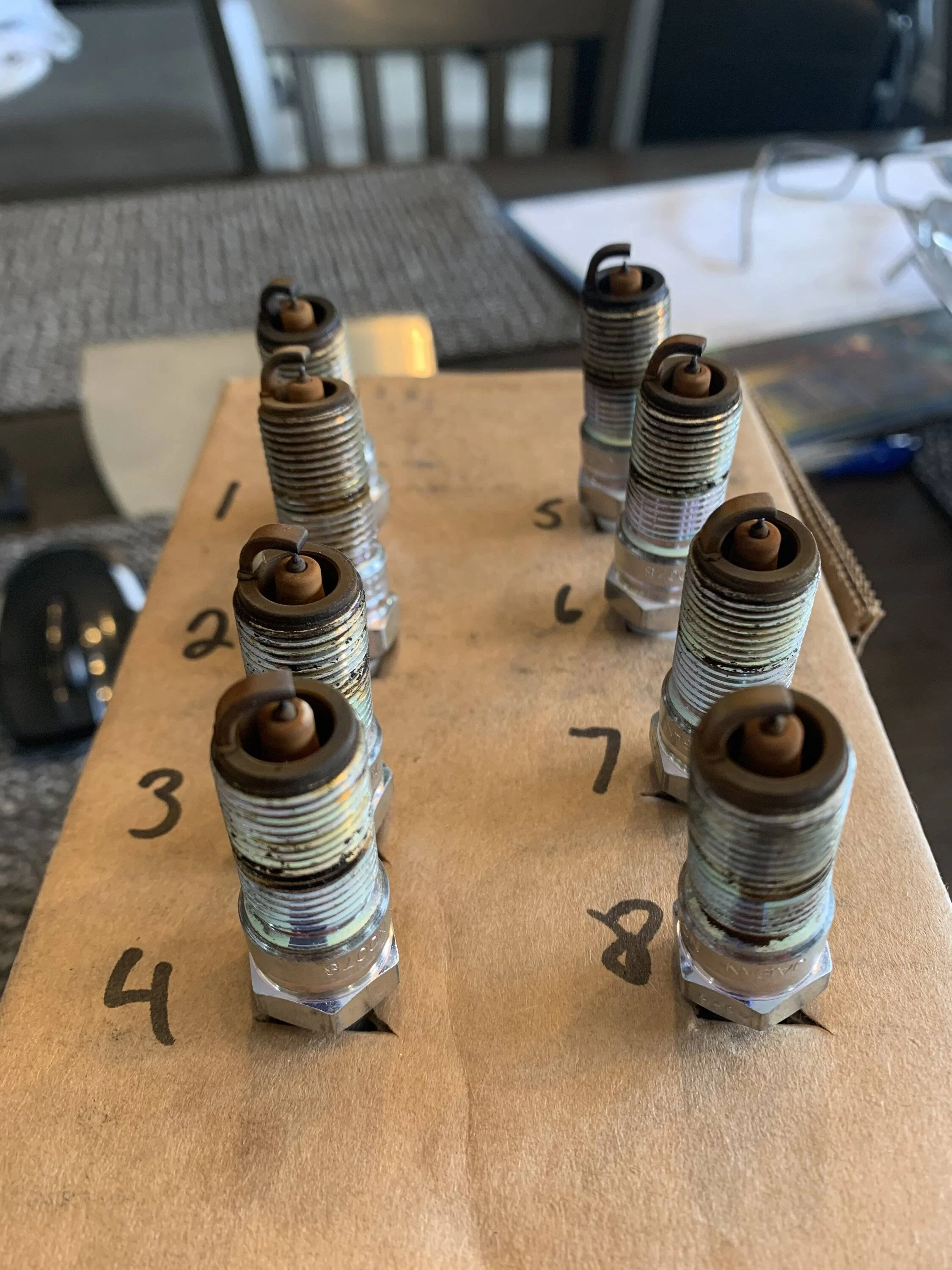

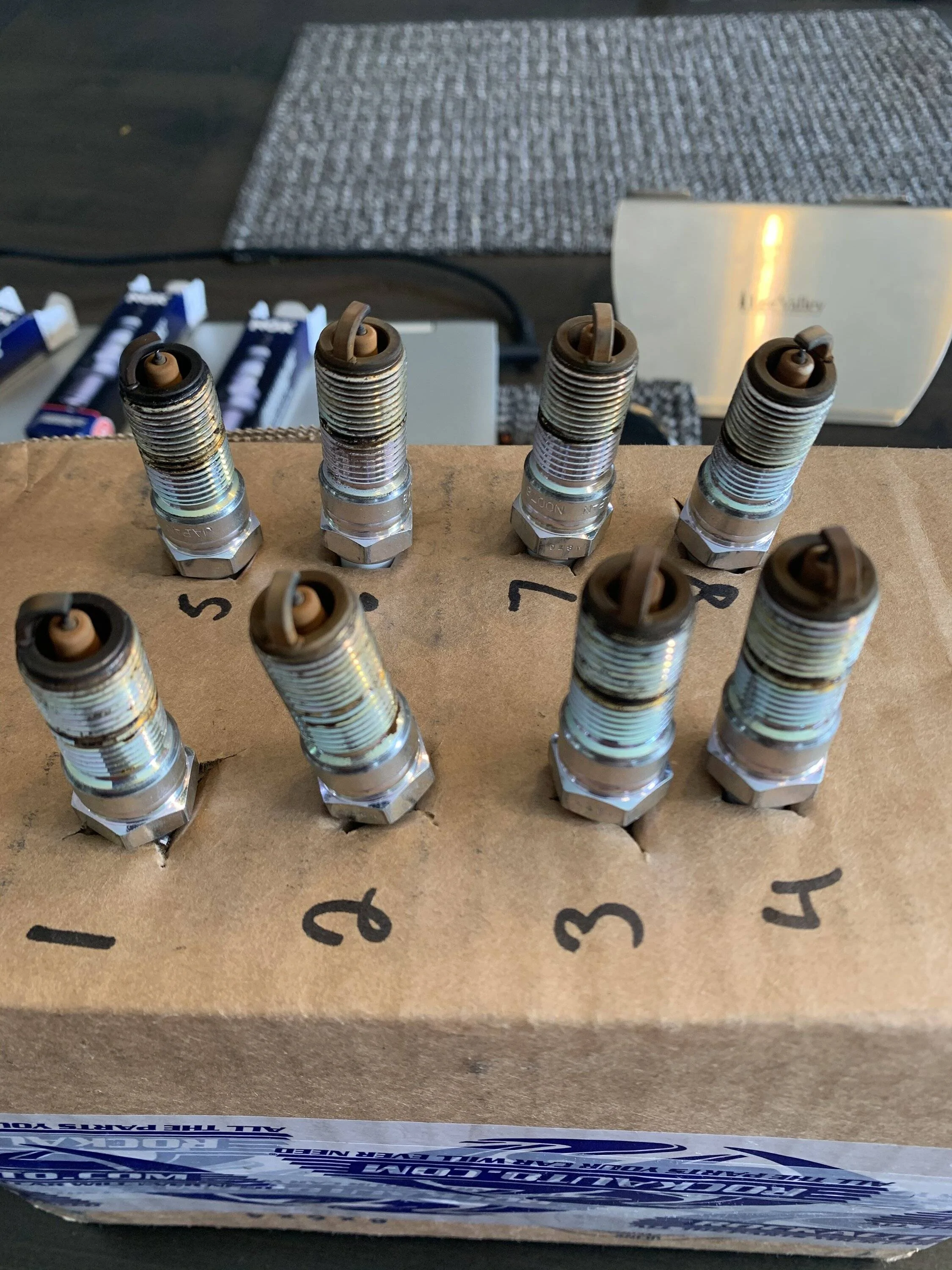

Just got a chance to change plugs this morning. Haven’t had a chance to drive or start it yet.
Couple of pics. Interesting - the #1 and #5 appear a little darker and “wettish” than the others.
Have a look and let me know your thoughts on what may have caused that. Car was driven about 700km since pics of the plugs last time. Babied for these miles - long easy tour on the weekend.
Thanks
Thanks
Fouled plugs that are wet points to ignition coil system that isn't firing properly. Those 2 plugs could indeed be the trouble cylinders of the coils. If the new spark plugs doesn't eliminate the misfires then it's your coils as suspected

Plugs aren’t wet per se. Shiny bottom and a little shiny ground strap. Insulator and electrode are same as the others. Can’t wipe anything and no wetness with a Kleenex. The other 6 plugs are basically identical. The 2 odd balls are 1 and 5 - both at the front of the engine for what that’s worth. All gaps checked in at 28 after removing.
Hopefully the new plugs correct everything. If not, perhaps coils. Would it be odd for 2 coils to go out at the same time?
Haven’t cleaned the injectors yet. Keep putting that off as the fuel AFRs in the logs don’t point to a fuel issue. But it could be I guess. I did run Royal Purple injector cleaner through it in the hopes it would make some difference but no luck.
2 coils bad at the same time isn't uncommon lol. I think that’s the only thing that haven't been officially changed. That's the bad part with the s550 coils. It will start your vehicle as should but it may not function 100% as it should. And it's no real definitive way of checking coils besides switching cylinders which you have done with no improvement. Did the new plugs help by chance?
