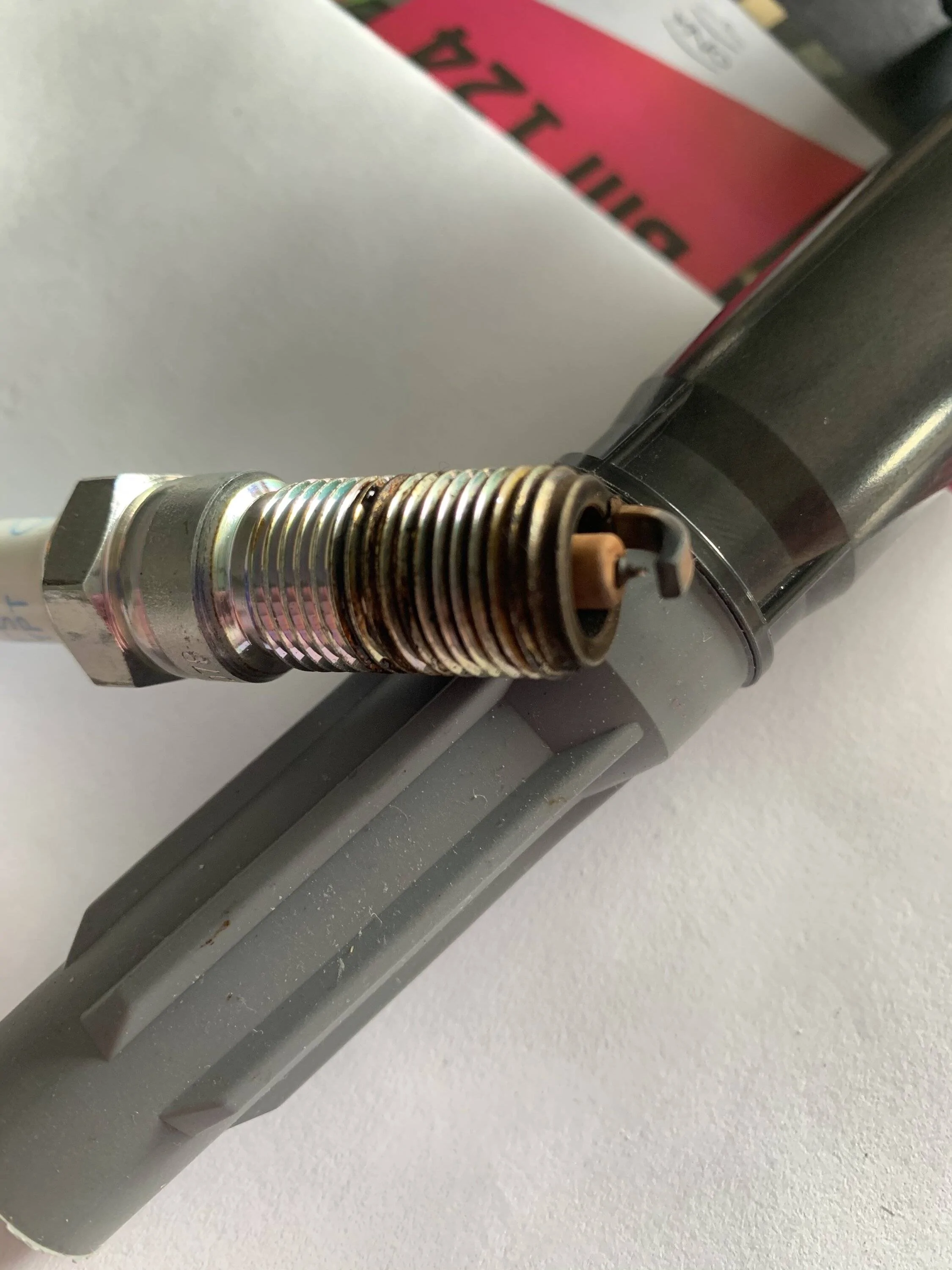

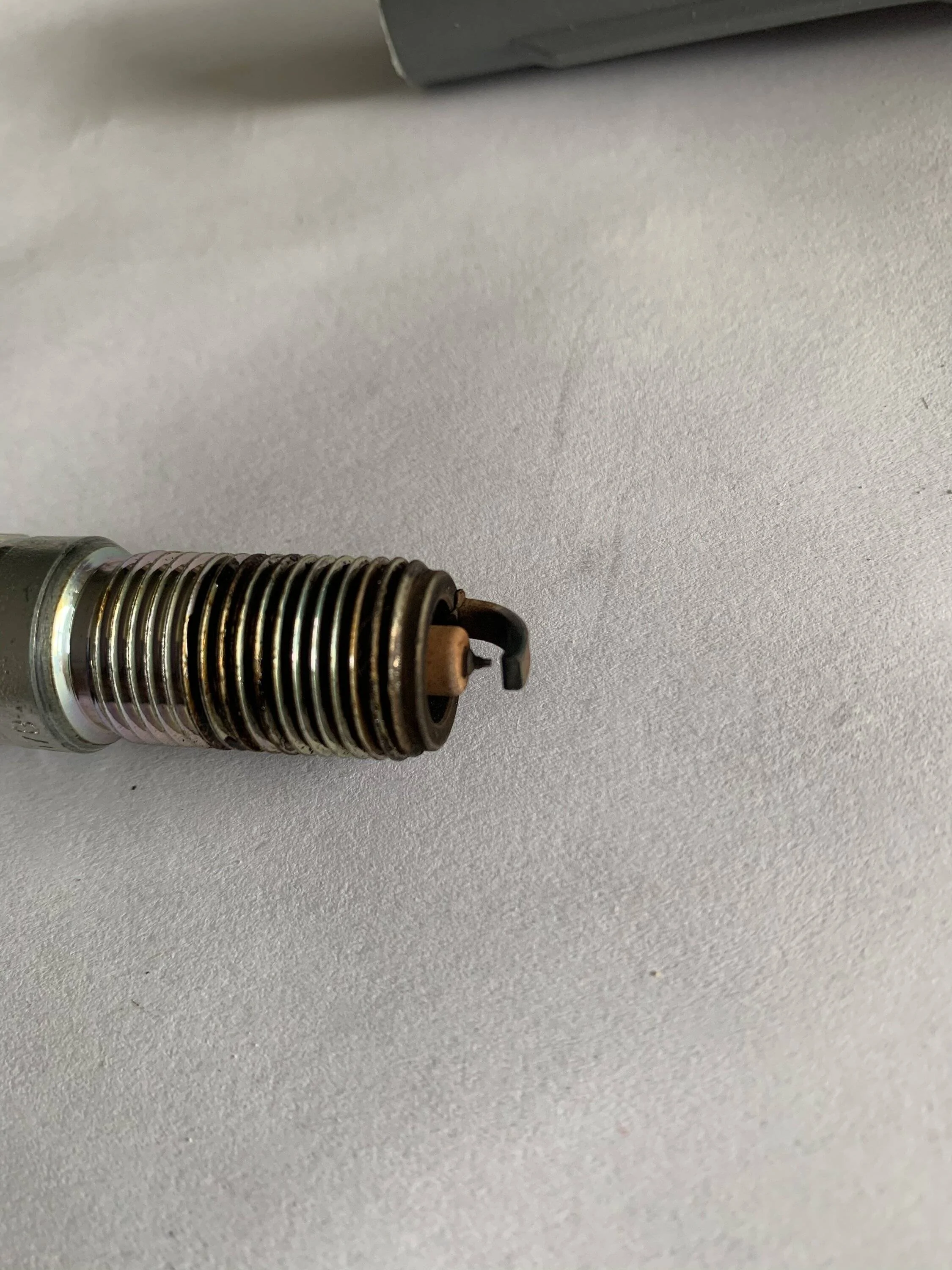

I hear you. Pulled plug 1 again for another look. It was the highest misfire count. Coil looks brand new.

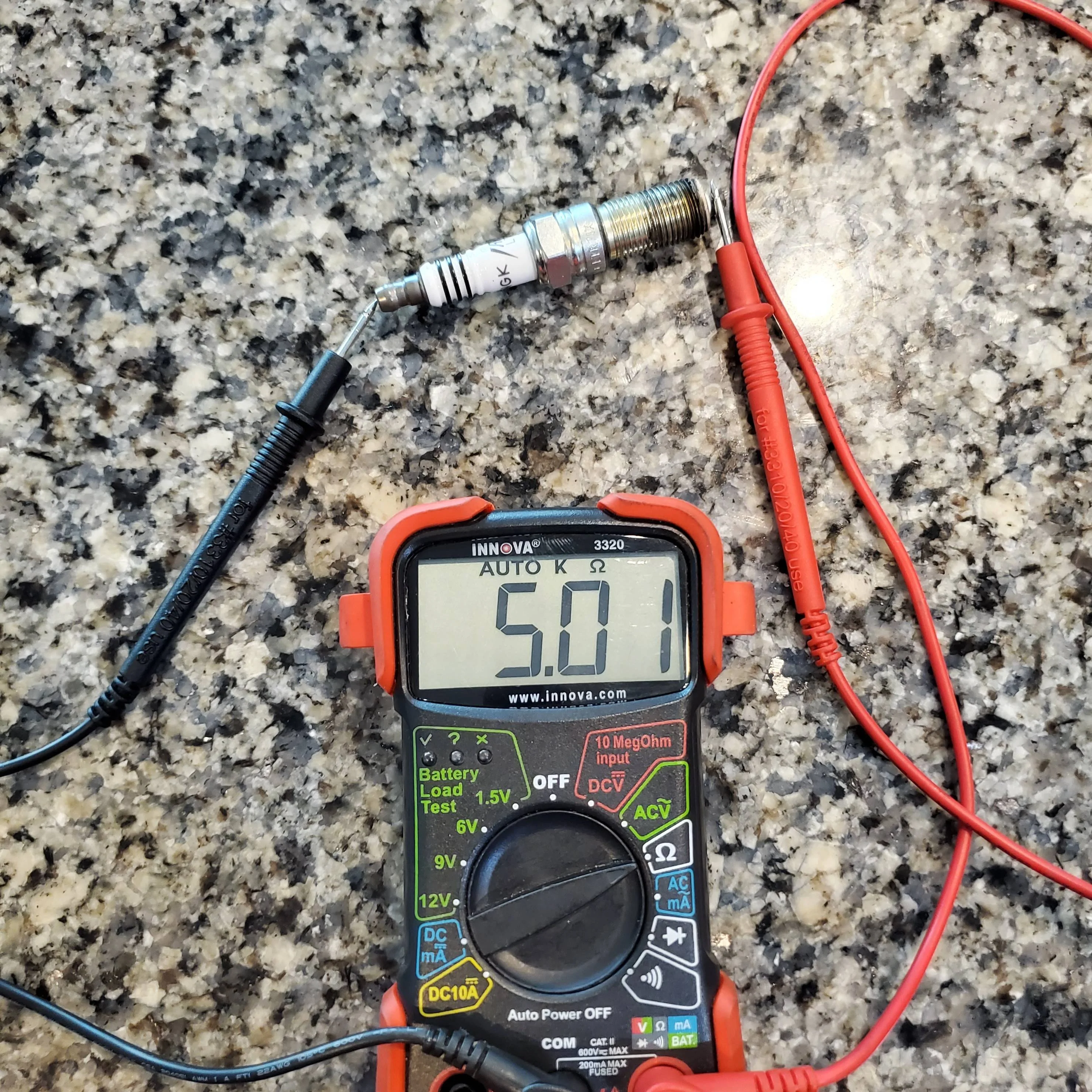

Spark plugs don't look bad. Have you ohm all them to check the internal resistor wasn't broken? All my spark plugs showed 5 ohm on my voltmeter

I have not tested voltage on them. Put it back in. Also changed by bypass valve hose again to my usual 34 pill. Tried without the pill again and boost is an on/off switch. Then tried the stock 15 pill and it felt lazy!! So back to what I’ve ran the last 2 years.

Yep. Your car is displaying the same exact symptoms how mine did. Over time the coils will go bad. They may look brand new but over time heat destroys the internals and they stop functioning properly. How many miles are on your plugs? They looked normal just looking at the tips and color. Only other way to rule the plugs out is to ohm them. I believe they all have to fall within the recommended factory range to be normal. A dropped plug could cause a misfire because the electrode could break easily. Checking gap as well. If you haven't tested the cam phasers with the voltmeter then you can do that to. My issue came down to my cylinder #1 coil. My code specified multi cylinder misfire and it provided the specific cylinder code. I had a cylinder #5 but that was were I had a clogged injector from letting e85 sit to long in the rails.

5000 miles on the plugs. Car has not thrown a code. That’s the challenging part. No starting line to figure out what’s wrong. Gaps were exactly what I gapped them at when I put them in - 28. They all looked great.
