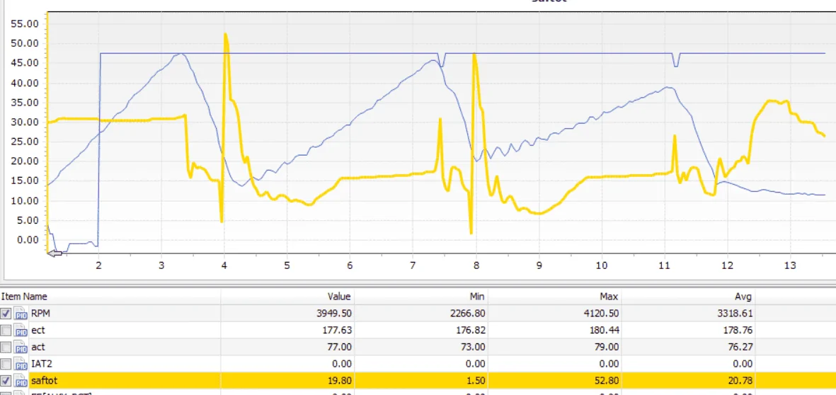

Installed a Paxton a few weeks ago and it was running great. Only in the last couple of days have I witnessed that the car seems to stumble a bit when at half throttle around 3k to 4k rpm. Feels similar to when an engine is lugged.
The car also doesn't feel like it has as much pep.
It will be Monday before I hear back from Lund but would like to know if there is anything I could check for on my own that wouldn't be tune related.

Not enough to tell from what you posted. Need log of it happening to start.
Side note.. why such low timing on e85? Pump gas levels but can't see airload either.

I'm happy to post a log, but the forum didn’t like the file extension.

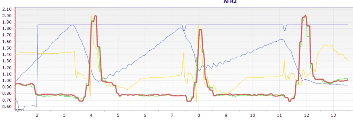

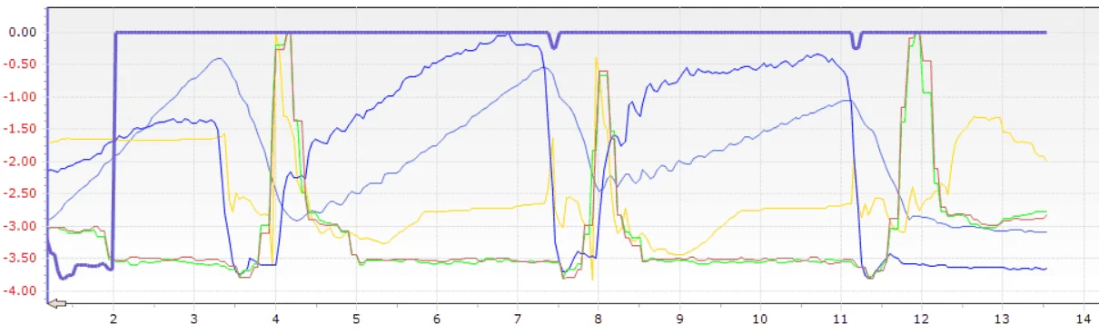

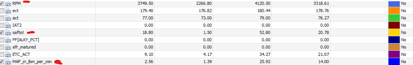

These logs are showing when the issue happens which is right where the RPM line goes jagged upon acceleration after every shift.
Without being able to actually post the log here, I am a bit handicapped. lol
