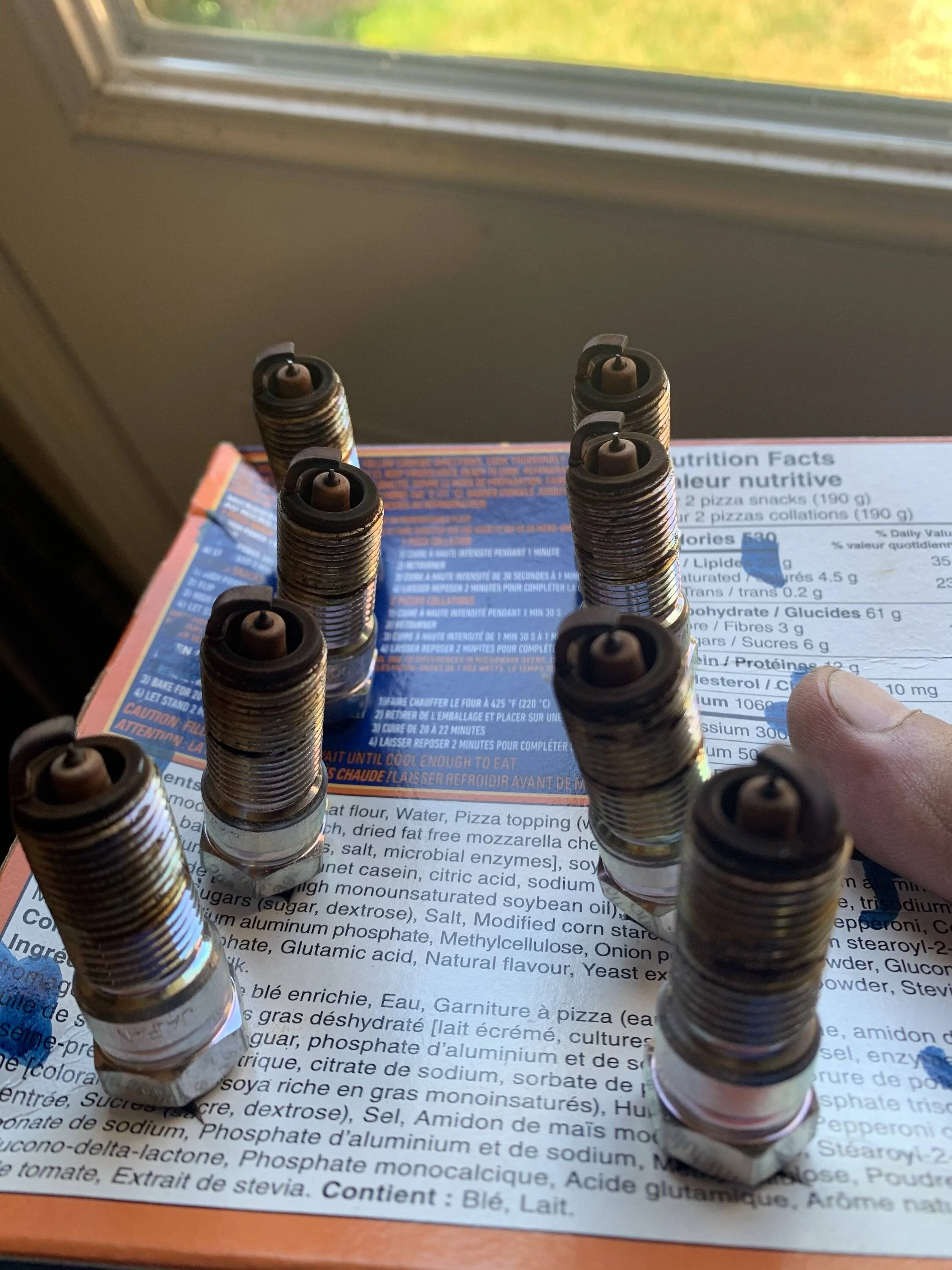

Going to pull plugs and have a look see.

Likely the culprit... any way to find out for sure?
Plugs were great - like new. Trying to download the logs I took last night but can't seem to get them off the nGauge.

2016 Edelbrock supercharged auto. 3.55. Lund tuned. 18+ Air intake, NGK 6510s gapped at 28 like new. Gap at 28. Stock TB at present. Stock headers with cats. Ran this tune for 2 years and with never as much as a hiccup until this issue.
Vortech BAP, stock pump, DW 95 injectors.
No codes. Have checked plugs (perfect), TB and intake is clean. Catch can in place. Changed bypass pill (removed it) no change. Pulled suction on bypass valve and functioning fine.

I’ve had plugs (and cats) that were bad but appeared perfectly fine. However, both usually only affect performance at heavy loads and/or high rpm.
