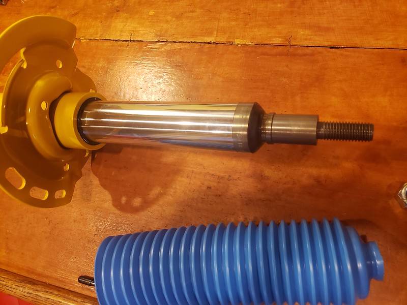

Not sure the frpp bump stops will fit in the Bilsteins.

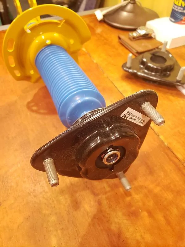

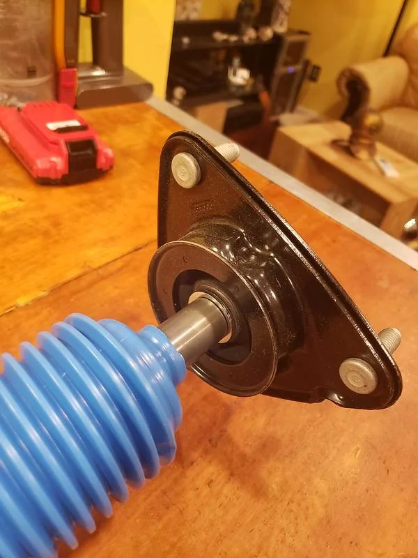

Here is the revealed strut.
20191121_162305 by chefjpd, on Flickr
And the new top mount fits like a glove 22mm nut
20191121_191228 by chefjpd, on Flickr
20191121_191233 by chefjpd, on Flickr
Definitely need a stop there. Looks good though.
