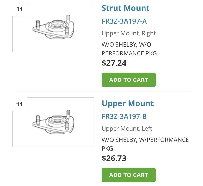

I may regret not going more aggressive with plates, but I opted to buy new OEM mounts to replace the old.
A fun fact is that there are two options in the Ford catalog for non-magnaride and non-Shelby mustangs: w/Performance Package and not.
I did a bit more digging, and the performance package mount has a stiffer bushing. It appears the non-PP mount only went on 2015s; in 2016 the PP mount went on all models less Shelby/magnaride.
If you have a non-MR GT, Ecoboost, or V6, get the PP version. The non-PP and PP options:
Here’s what to get:
Part #: FR3Z-3A197-B (Two of these; there is no difference between left and right).
Link to the PP strut mounts:
https://parts.autonationfordwhitebe...8-gas/front-suspension--struts-and-components
Thanks to @GregO ’s intel, it is also recommended to replace the upper spring seats. These seats contain bearings that wear over time. There is only one part used for the whole Mustang fleet: FR3Z-5A306-A.
Link:
https://parts.levittownfordparts.com/oem-parts/ford-upper-seat-fr3z5a306a
The value between ordering the parts independently versus ordering the Ford Performance Strut Mount kit (PP mounts + upper spring seats) is very competitive. My recommendation is to weigh in taxes and shipping to your location (or if parts are available at your local dealer) before making a decision either way. Here’s a link to the FRPP kit:
https://www.cjponyparts.com/ford-pe...kABF4YN5zrOG3fRtBWcIOa4s-9iaTTd8aAkykEALw_wcB

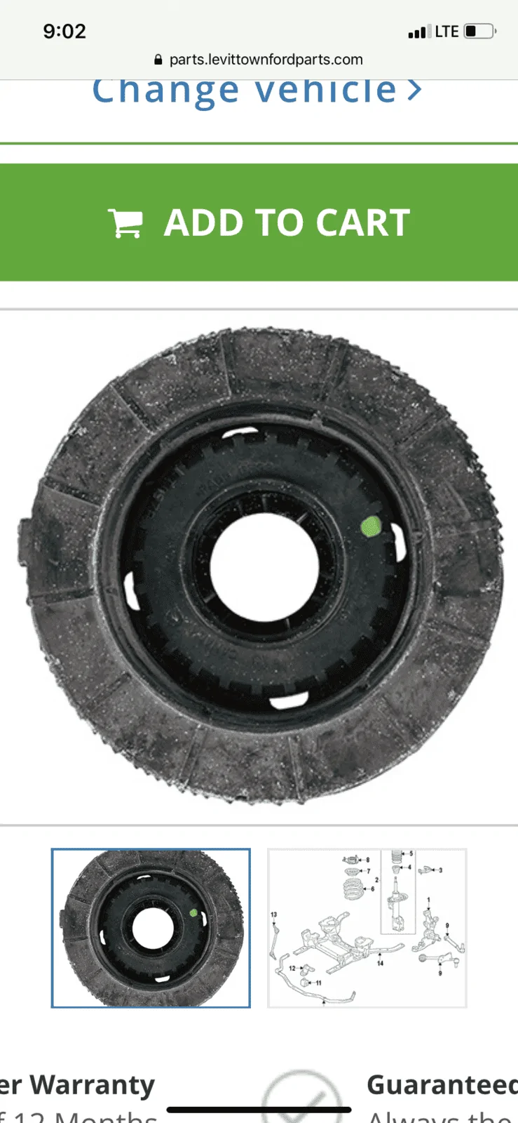

Pretty sure he's talking about the spring isolator.

I know the Ford Performance mount kit also comes with the upper rubber spring retainer, but nothing else.
The upper spring retainer your referencing has a rotary thrust bearing mounted in the inside diameter of the rubber spring retainer.
Open your link and scroll to item #10. The green colored plastic piece located on the inside of the black rubber contains the rotary thrust bearing.

That’s good intel. I assumed the rubber insulator wouldn’t have a bearing or anything to the sort within it. Thanks.
Yeah, it’s an important replaceable wear item that’s often overlooked due to Fords enigmatic item description.

Looking at the part itself, I for sure don’t see a bearing. Considering the spring just seats into this, I can’t imagine it would wear fast.
It’s there, the green plastic has ball bearings arranged underneath in a circle towards the outer diameter which contact the metal plate that the rubber spring isolator / retainer is bonded to.
The green plastic race is what allows the strut and spring assembly to rotate against the strut chassis mount while turning.
