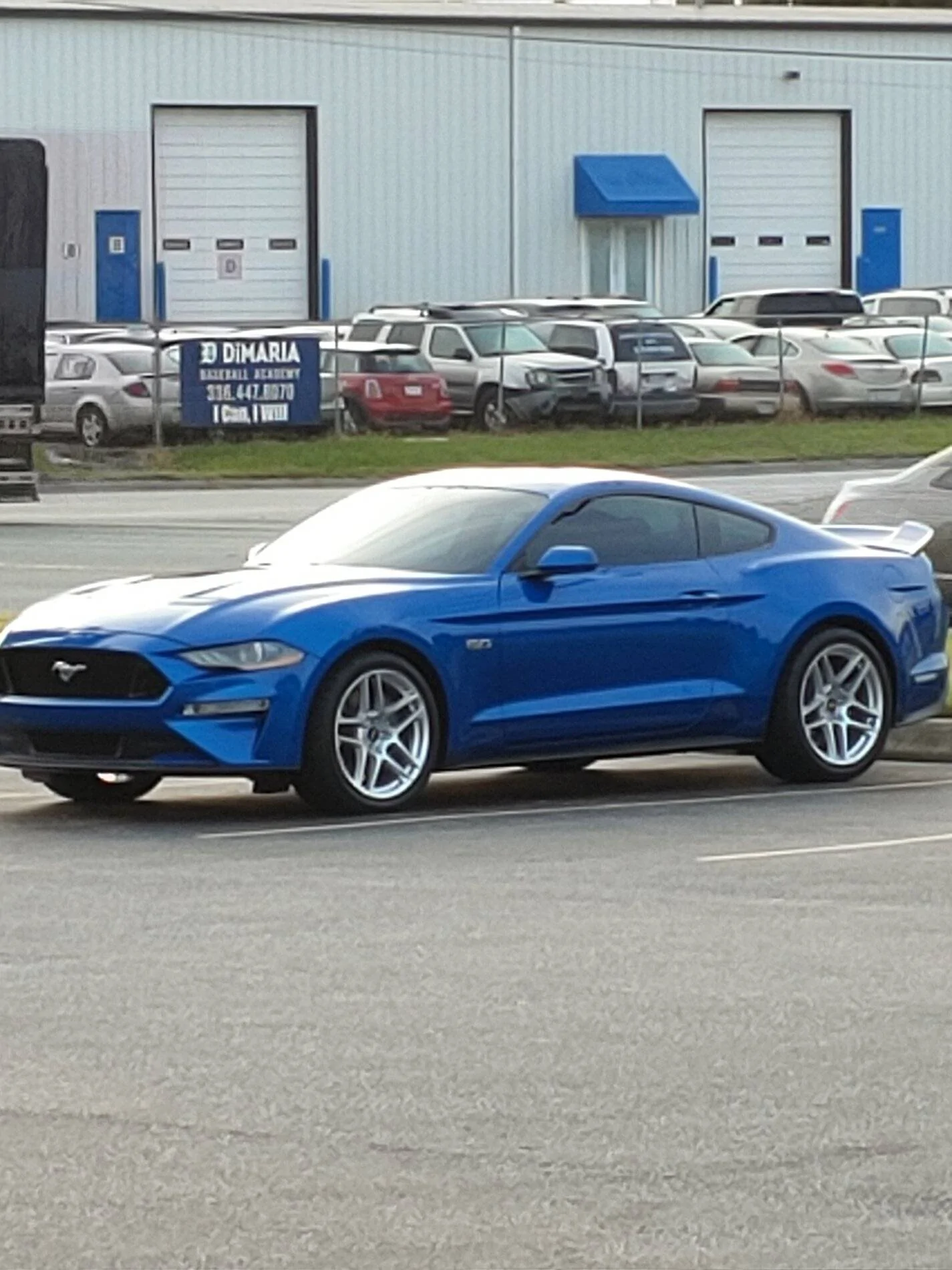

This is my first Mustang. I have a base GT A10 with sve 19x10/11 wheels on 285/35 305/35. I have the steeda irs bushings spacers, upper strut tower bar and g-trac brace ( stage 2 handling package ). After reading threads for months Santa Claus delivered the track suspension package. Are there any other mods that I should definitely do at the time of the install? This car will never be tracked. 90% of the time my wife will be in the car and the car is driven in a fun fashion but being safe. I'm only a few hours from great mountain runs in NC and we do enjoy that.
