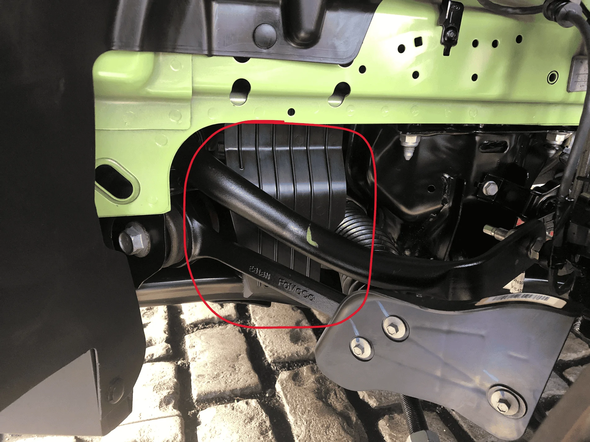

Maybe worth checking in the wheel arch at the liner. Mine was making a very similar noise and the vertical inner liner was caught on the lower wishbone. The bit circled in red was flipped over the arm

In my case the wheel arch liner flap was catching the inner part of the tyre which made the noise on full lock. Easy to see if that is the problem.
