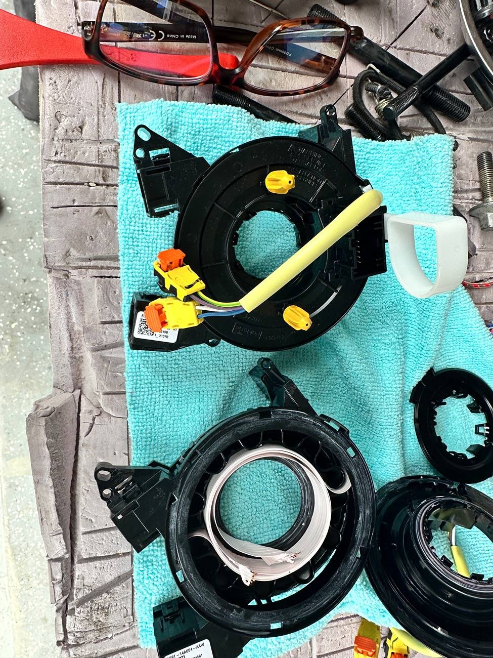

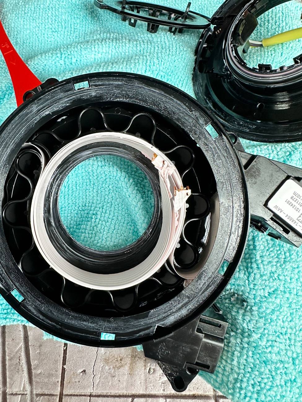

As a reference, attached are photos showing the internals of the clock spring assembly.
In the example displayed, the wiring inside the mechanism is broken, which was driving a replacement.
Edit,
The orange connectors of the assembly are Ford's way of identifying plugs involved with an airbag.
