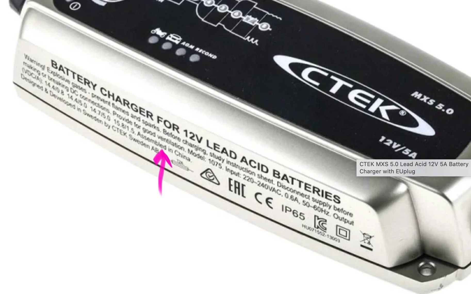

Actually CTEK units are made in Sweden. I don’t know if they’re made with Chinese materials though - I’m not an expert there. Reading their website it appears there owner invented the electric pulse tech now used in these chargers - so I guess they’re the OG for these new style maintainers.
Designed in Sweden, made in China.

I just checked mine - that’s correct.
still it’s probably the best unit out there though. But to each their own.
