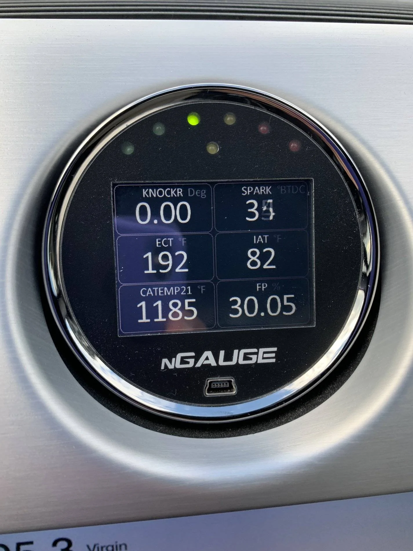

Ok. Here’s a couple questions - I know they’ve been asked before but wanted to see about more folks and more PIDs.
What is everyone monitoring daily?
What does the HP Fuel Pump % monitor? I watch this PID but not sure if it’s accurate / correct.For those that monitor this, what values are you seeing? Mine sits from 28-30 normally but under load it goes to 49.9 and stays there. I have no idea what this means.
I monitor STFT and Lambda, KnockR, spark * Btdc, IAT, cat temperaturethrottle position commanded in my round gauge, and KnockR again on my LEDs.
Hopefully someone can explain the HP Fuel pump %. I was hoping for an easy method to monitor my fuel pump /BAP.
Also, how accurate is the cat temp1 PID? Just started watching it but again, not sure of accuracy etc.
Thanks for your help!

It's the duty cycle of the pump, percent of time it is running.
I agree with solarflare on what to monitor.
Lambda will tell you if there is anything wrong with the fueling.

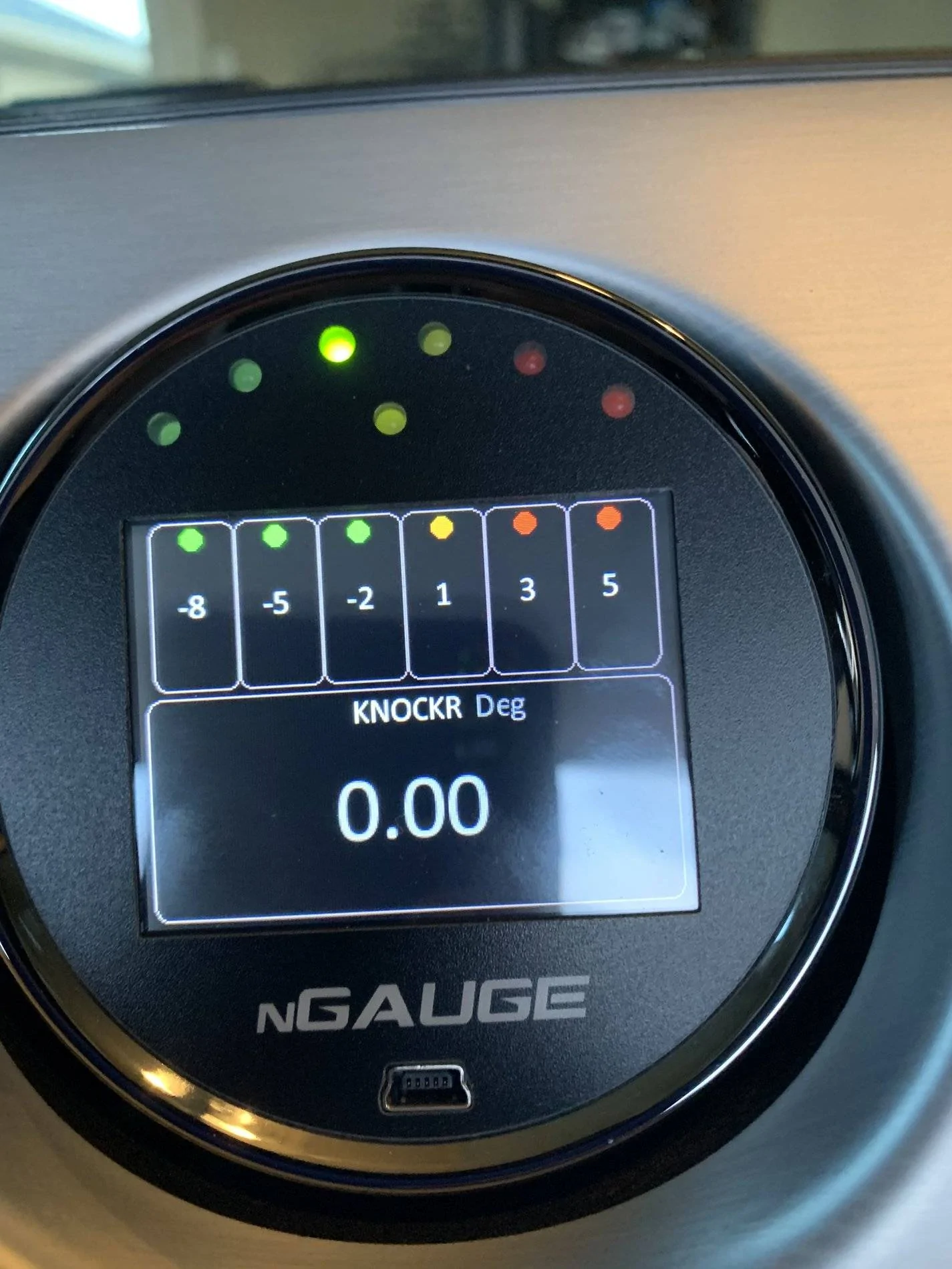

I have my LED monitoring knock as well. Basically first yellow is +1 then +3 then +5. The greens are my negatives so I can when adding or pulling timing.

The duty cycle on the pump will be on enough to keep the fuel pressure high enough to fuel the engine. Yours is at 50% at WOT plenty good. You don't want it at 100% Anything below 80% at full load is good.
Cat temp, the factory adds cooling at 1650 degrees.

While on the 4 or 6 PID screen click on the value you want to set up for. In my case knock, should take you to the screen where you see the value on the bottom and the lights across the top, you click 1 by one and a key board pops up to let you input. For example, -4, -2, 0, +2, +4. So if you doing a pull and it’s adding 2 degrees you’ll peek over and see green. If fuel is crap and you knocking 2 degrees off you’ll see red.

Here’s my set up for the LEDs.
