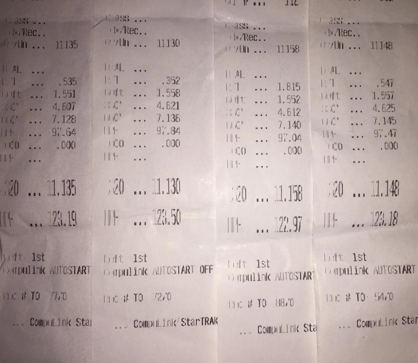

-7 to -10 is very conservative. Add 3-5 to your base timing 3500 to redline @.80 load . You will notice that for sure :headbang:
I will get with Lund on that for sure. Is your car N/A? That car is flying for a N/A. Will beat a lot of blown cars.

yes N/A ... its been known to hurt some feelings :headbang:
Man, what does your car 60 foot? How much HP do you make?

Bolt-ons and stock suspension MT82
What does the car Dyno. Is there weight reduction? There are supercharged cars that run close to the times you run. You have a runner.
