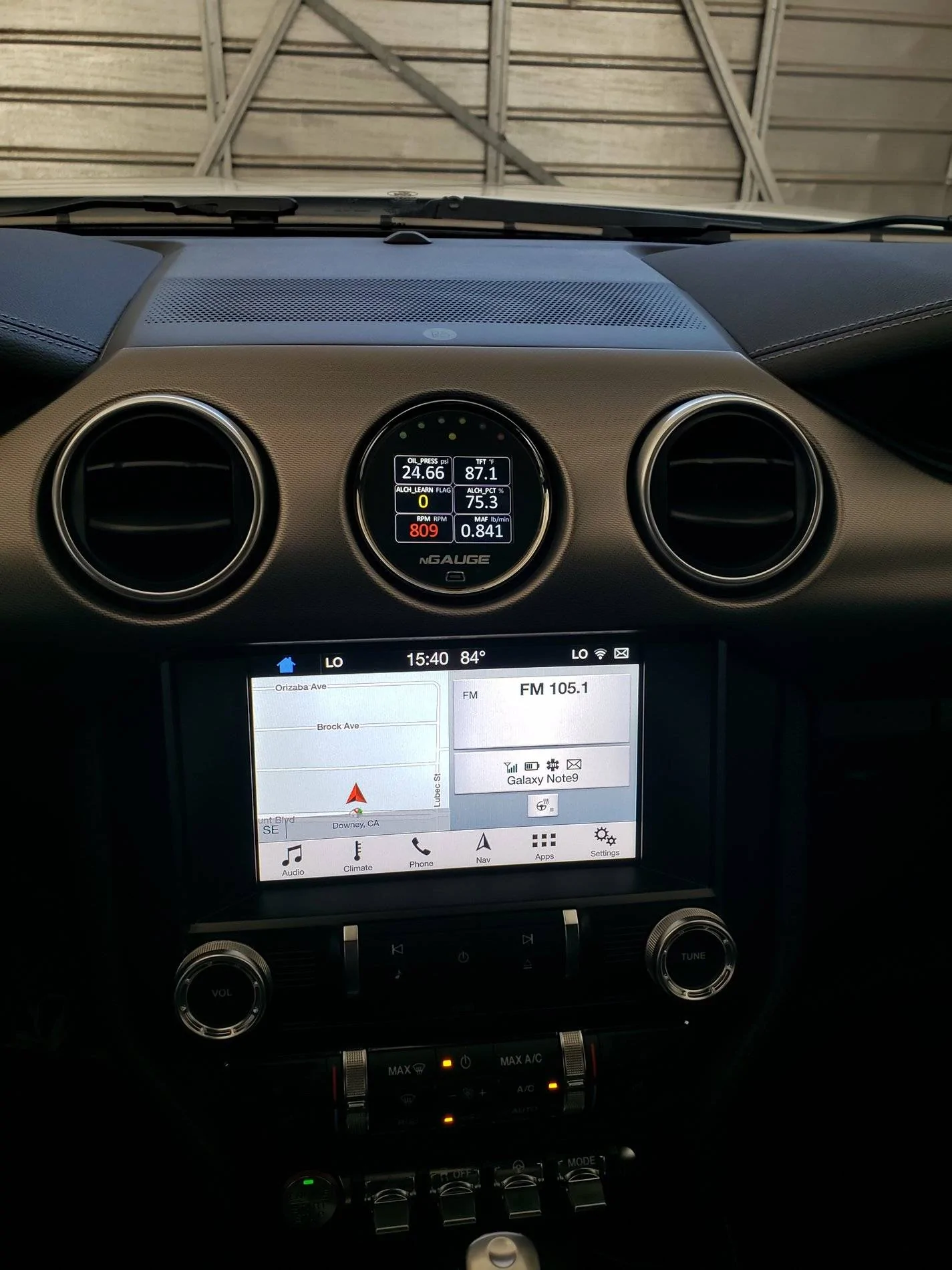

Also, don't bother on an AC mount. Just wrap the guage a couple times with electric tape and it will squeeze right in and be secure.

That looks awesome!

Jut make sure you block off the duct behind the vent you mount the NGauge in. Mind had condensation all over the dash when running AC until I stuffed a rag in the duct.

I won't be duct mounting mine, as mine is a PP car and I'm not giving up the vent.
I ordered the clip type vent mount for now which will work until I dream up something else. I like the setup in a recent post that's mounted to the driver A-pillar, but I want something even more hidden, to the left of the gauge cluster most likely.

Personally my tuner stays in my glove box unless I'm loading a tune revision or data logging. But living in the desert no way I would give up an ac vent either, that's valuable real estate in the heat :sun:
