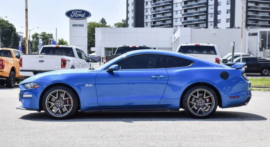

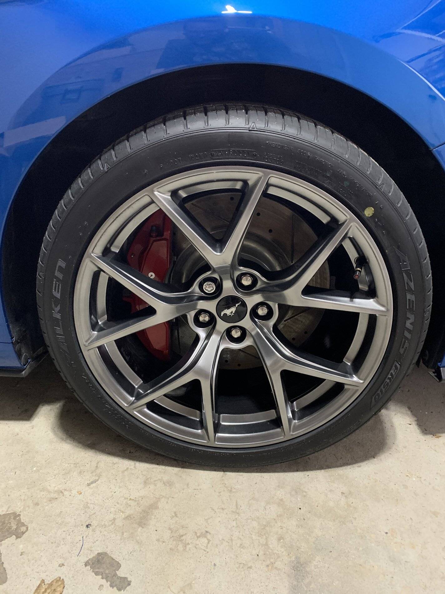

Hi all, so happy to have found this website. My wife purchased a 2019 GT PP1 after 20+ years of waiting to buy her dream pony car. The car is fantastic, velocity blue with Shelby stripes, red recaro interior, h-pipe, but has PP2 wheels. We purchased from a Ford dealer who replaced the Sport Cup 2 tires with Falkens, but wouldn’t listen to me about the size. I wanted them to put 305/35/R19 rear and 295 fronts to match the stock PP1 tire diameter as closely as possible. However, they argued the PP2 wheel always run 305/30R19 in a square setup. Although we ended up with brand new tires which is great, they went with the 30 series tires and now the speedo is out around 6%, and the wheel gap sucks.
I’ve called around locally to price new tires for the rear to correct speedo, but the 305/35R19 seems very hard to find. I ended up calling a fairly local mustang specialty shop that is well known here in the Toronto are, and they suggested to just buy an SCT tuner for the obvious performance gain and to correct tire size that way until the current tires wear out.
We are also noticing very quickly how the poke on the PP2 setup is ruining the paint! I’ve ordered some ABS sheet and am going to make my own splash guards, but would like some opinions on what experienced owners have done on here.

Those are definitely OEM PP2 wheels. The speedo will not correct itself. Mine is the same 3 years and 20K later. Have you verified your speed with a gps? I track right at 3-4 mph off at 65-70 mph. Not sure if you are A10 or M6, but you’re getting about a 3.94 gear ratio running those 305/30/19’s. Going 305/35/19 might be enough to feel in the butt dyno, particularly if you’re M6.
Curious if you’ve noticed any rubbing on the front fender wells as a true PP2 has different front fender linings than a PP1 to accommodate the wide front tires and offset. I’m planning on going 315/30/19 and 305/30/19 PS4S this next go around.
