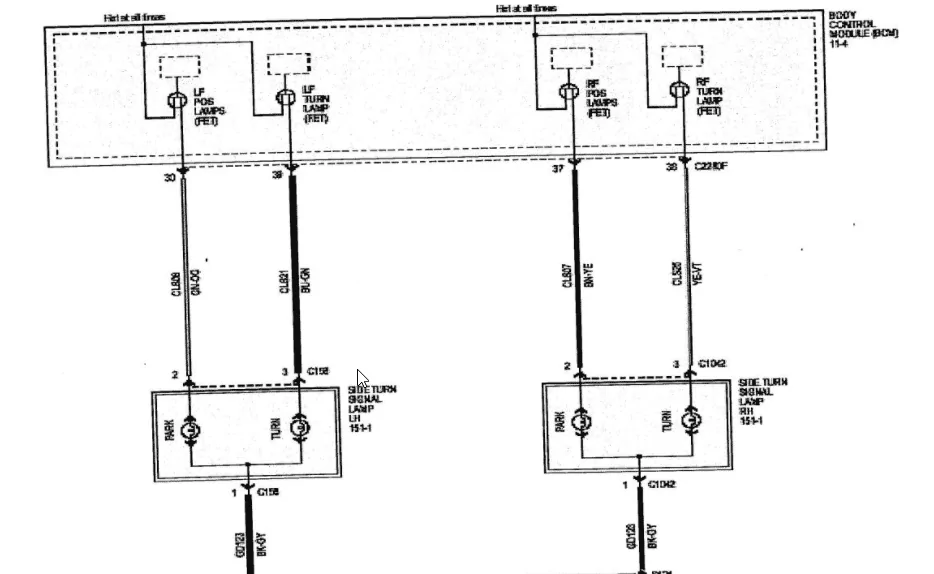

Hey guys, I am trying to set up turn signal lights in the hood vents of my 2015 GT. I realize there are kits to do this, but I already have the parts and materials that I would need and can do this myself without spending (what I feel is) a ridiculous amount of money for a couple of LED light strips and a few plugs.
The one thing I would really like to be able to find is a wiring diagram for the 2015 to help identifying the wires I need and hopefully help find a location I can tap into them closer to the fire wall end of the engine compartment rather than running wires all over the place.

Welcome!
Check out this thread. I didn't have a chance to look over all the diagrams posted, but I think I spotted the LH RH turn signal diagram in the posts.
https://www.mustang6g.com/forums/threads/wiring-diagram.33445/
Yeah man, I think that covers me!
Looks like Blue Green on the left and Yellow Violet on the right.
That should get me what I need. Now to figure out where that thing runs back to...
