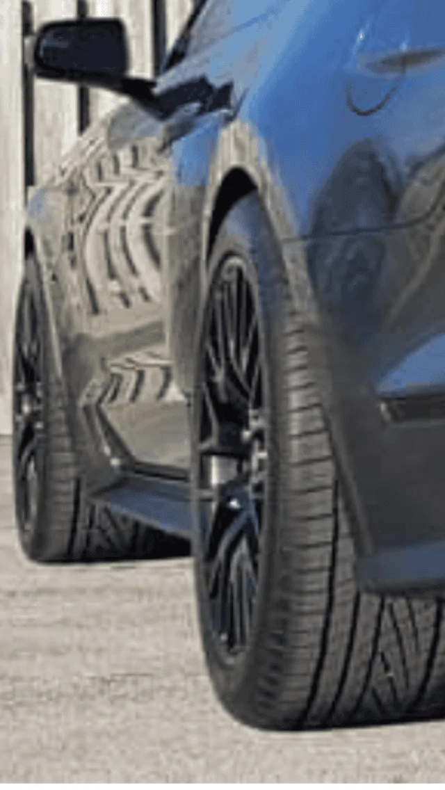

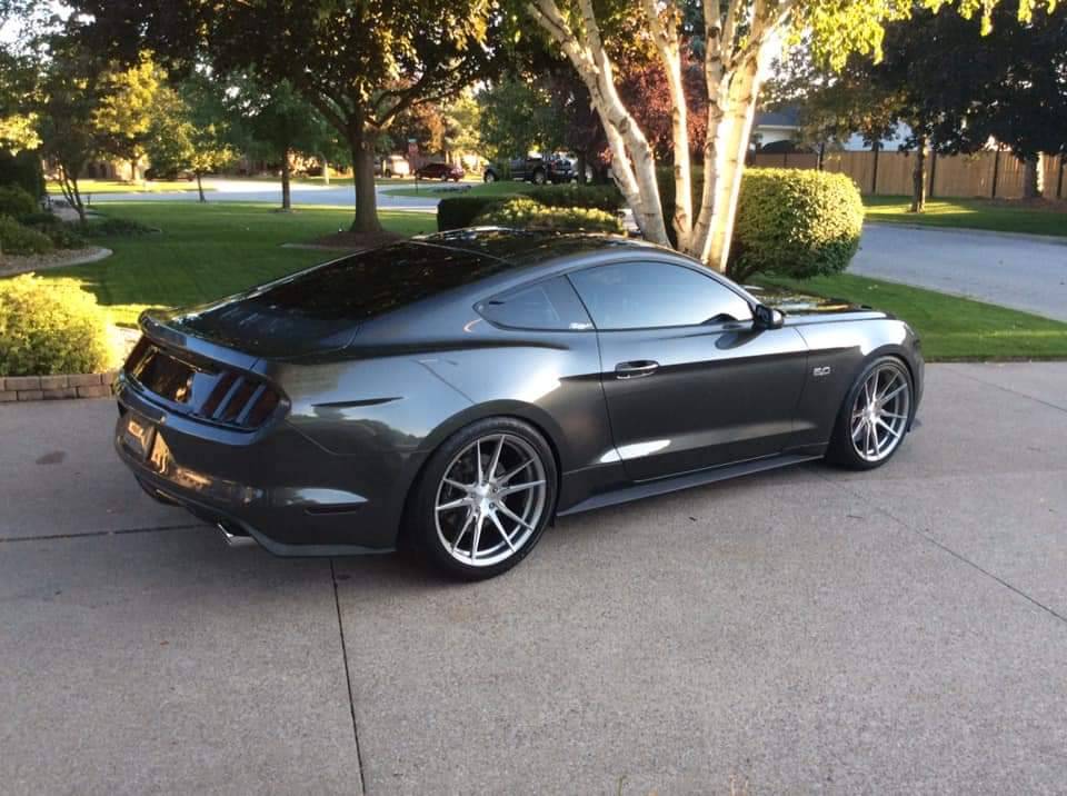

I’d like to have this look

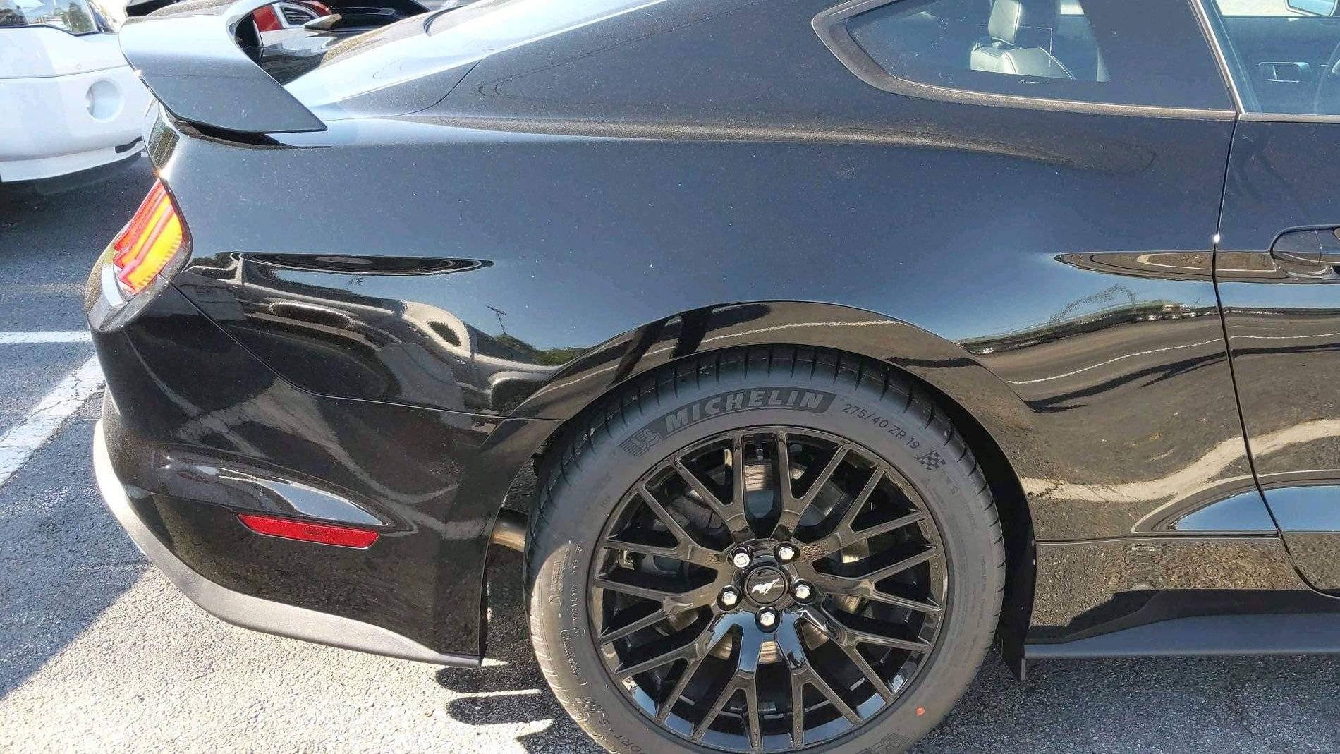

Here is the same 285/35/19 Conti tire is question on a 19x10 wheel for reference.

That’s exactly how I want my wheel:rim to look.
Will 275 do that to my 9.5? If I don’t get the same size protection edge for the rim I may go to 285 but I hope it wouldn’t look stupid for my wheel.
Fingers crossed my 275/40/19 has the same edge from rim to wheel.

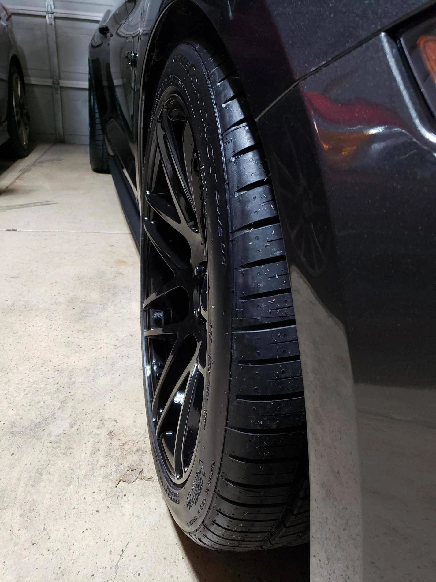

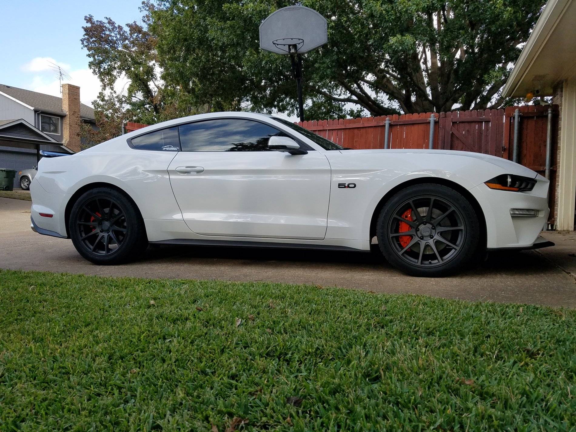

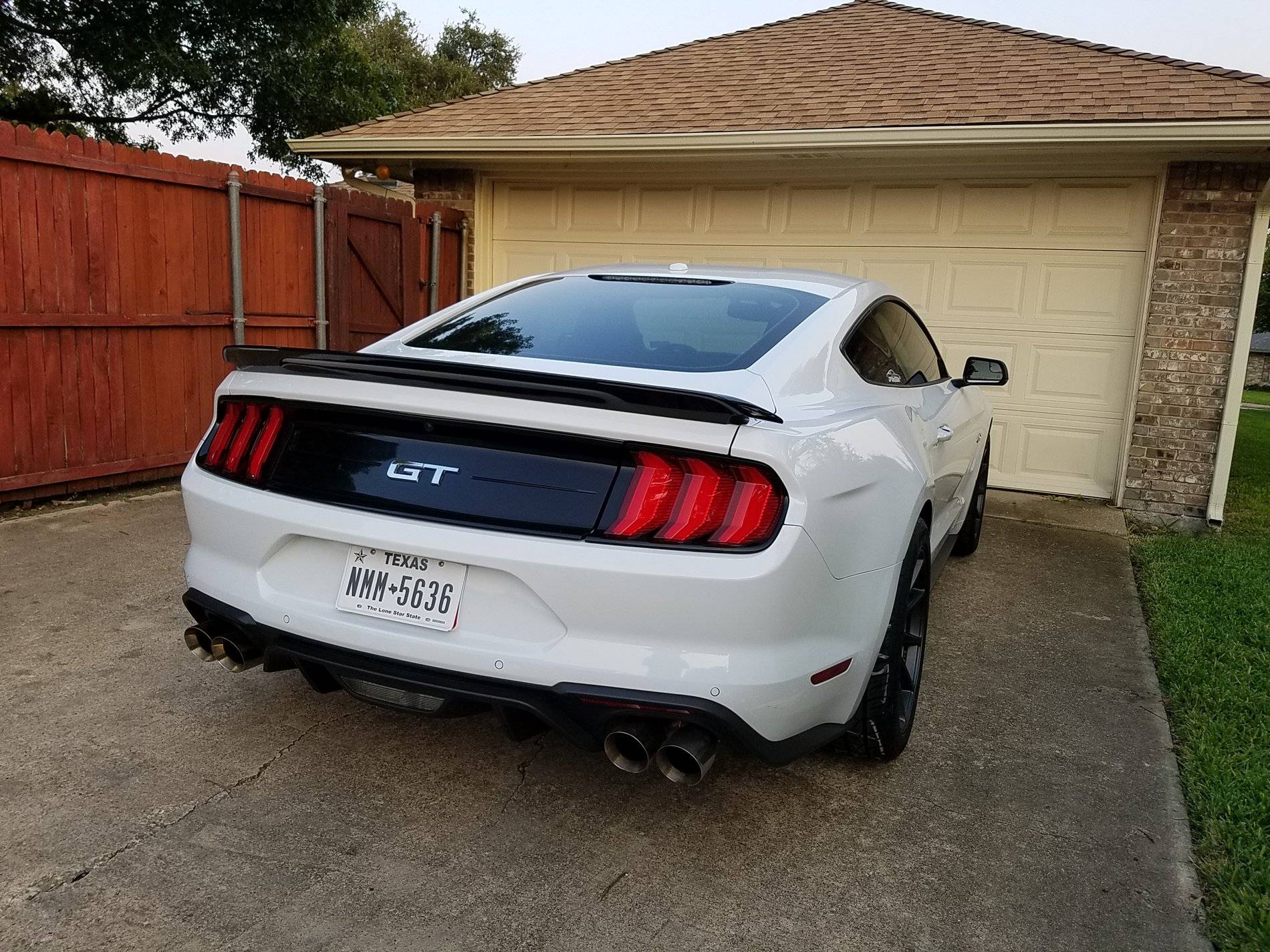

This is 275/40r19 on 19x9.5 with +33 offset. It's flush in the rear but does not poke. Right now I'm at stock ride height.

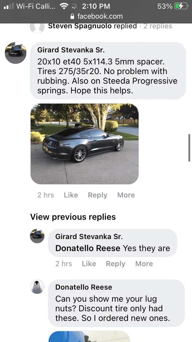

it doesn't hit the outer face, it bumps the inside, but on the off chance It did hit the outside, I want some protection. I will mount the wheels tomorrow and see how it goes. theres a guy on the Facebook group that I cant get to reply with closer photos, but he said this.
he may not see the messages or comments, but he said this and his wheels look normal. 275 on 10 inch wheels. so 275 on my 9.5 damn should work.

The problem isn't whether 275-wide tires will work on a 9.5" wide wheel. It's how well the tire will give your wheel spokes - or the back side flange, for that matter - any protection. I'm not at all sure that your fb contact fully understands what you need to know.

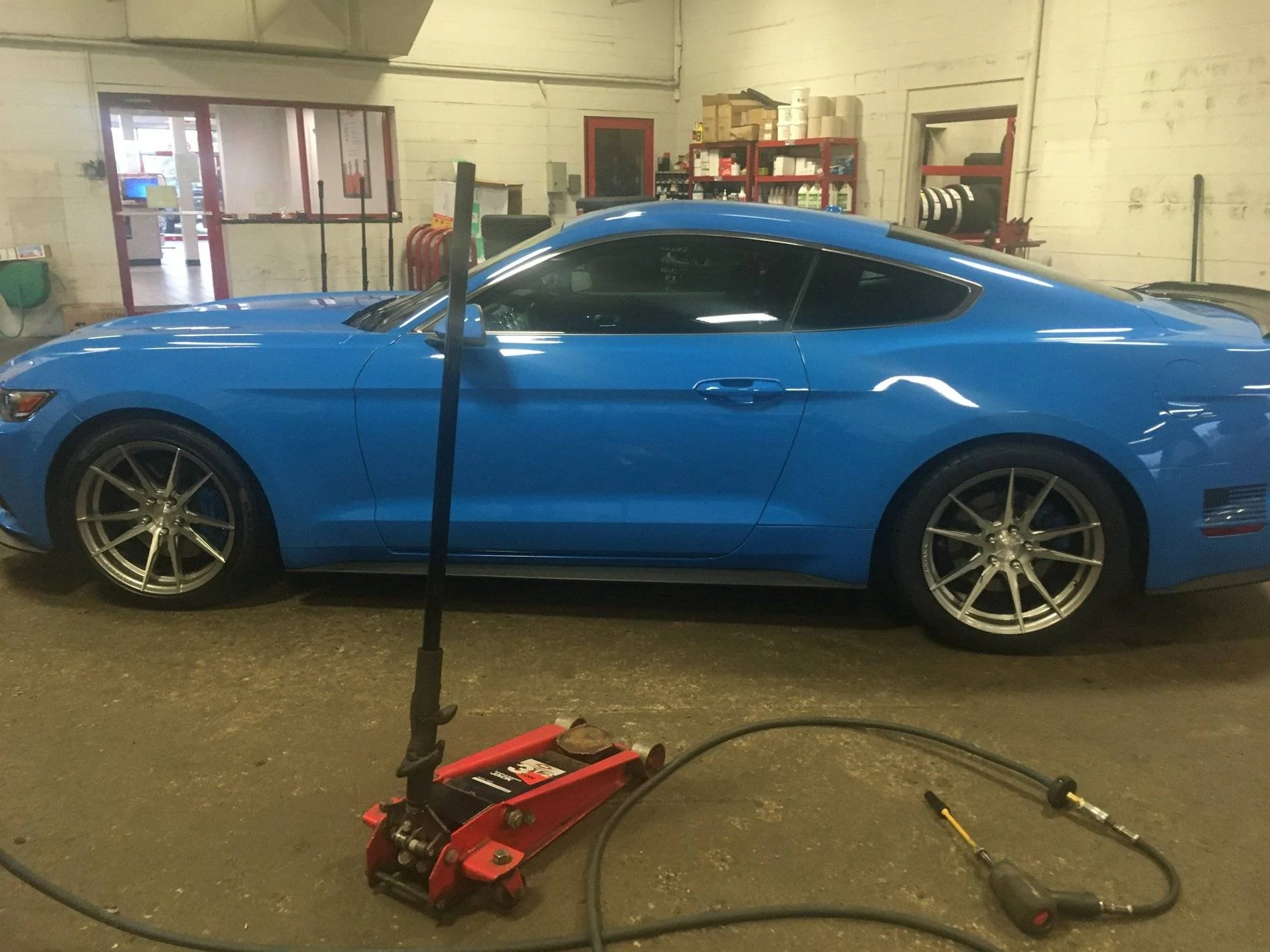

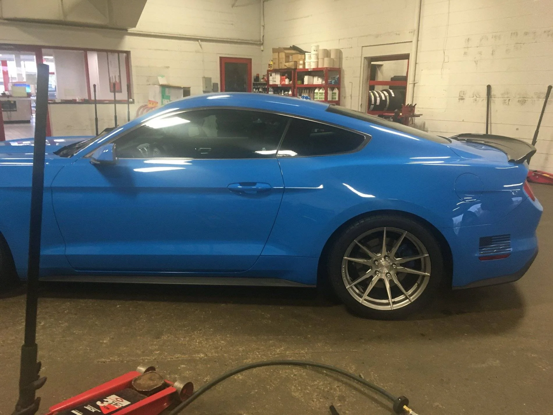

I put 275/40:19 and it was flush with the face
We put 285/35/19 and gave a solid look. Little past face
Ordered a new set 285. Back wheel tested on front and back. Worked no issues
