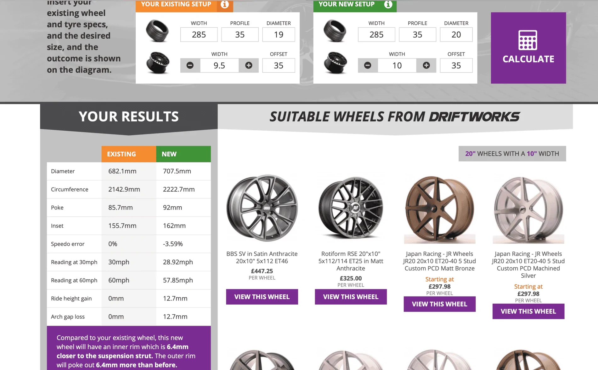

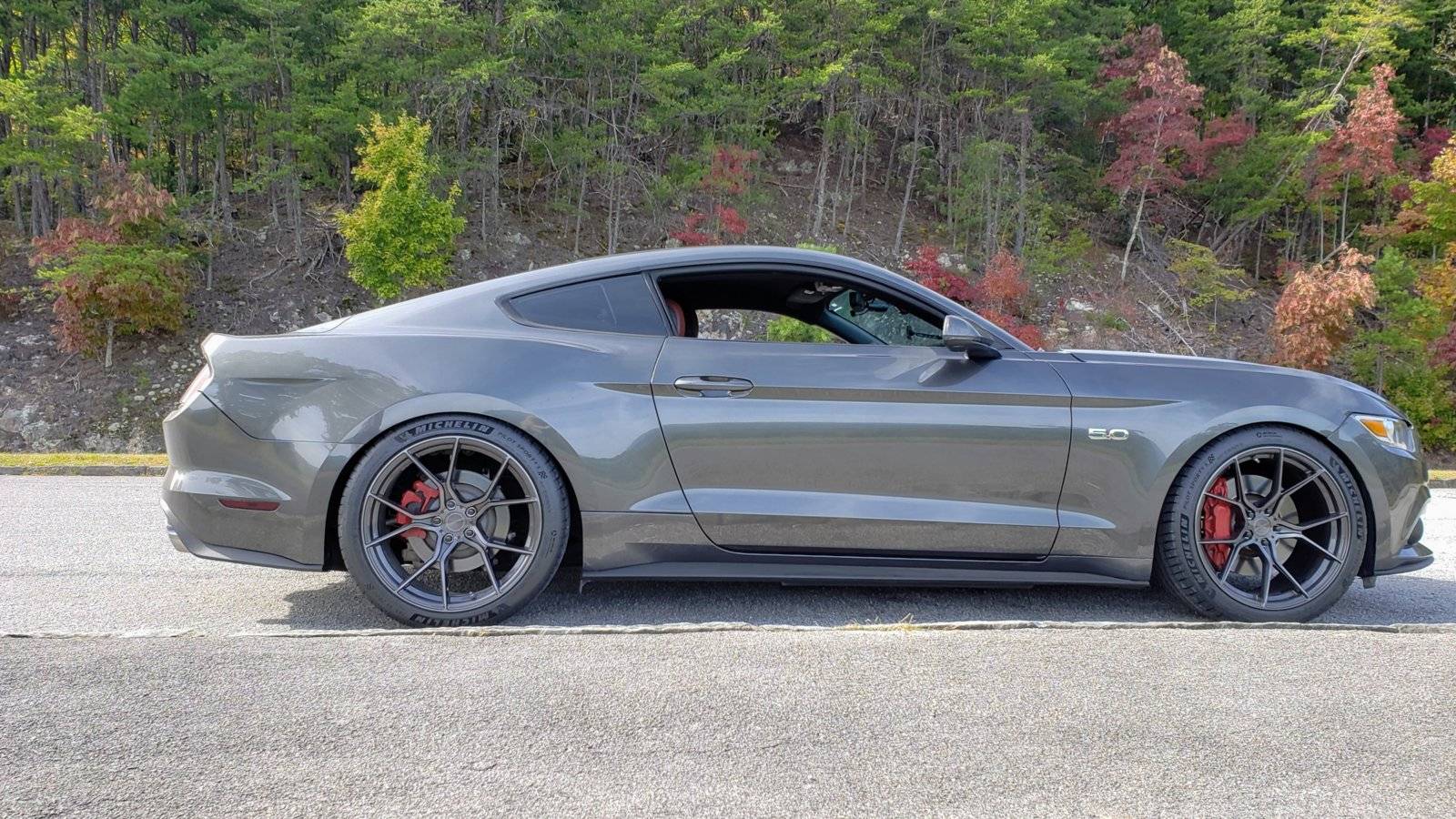

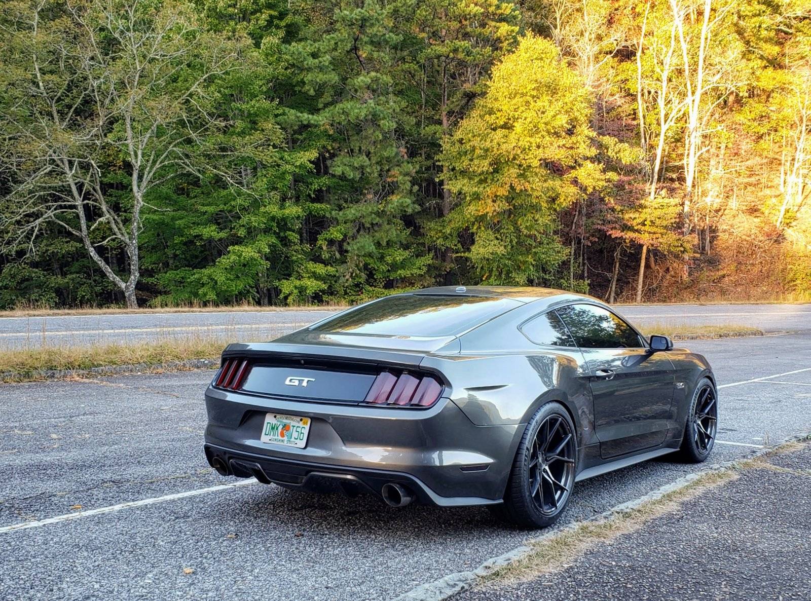

shouldn't my car look like this basically?
I compared his stats vs mine, but my rear looked like it poked a little. his photos dont look like he pokes at all, and in fact, he should be 5mm further out than me right?
285/35/19 on 19x9.5 with 35 offset all around
vs
285/35/20 on 20x10 with 35 offset all around
because his is beautiful! I have been googling a ton tonight

yes Brant's have serious poke at the back. Front is hard to tell from those pics. He's got 1.5" drop springs which brings the fender WAY down and accentuates the rear poke.
I would use the 5mm spacers only on the fronts and see how it shakes out.
