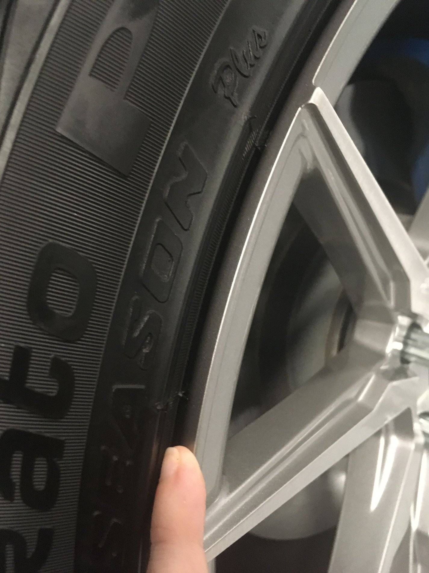

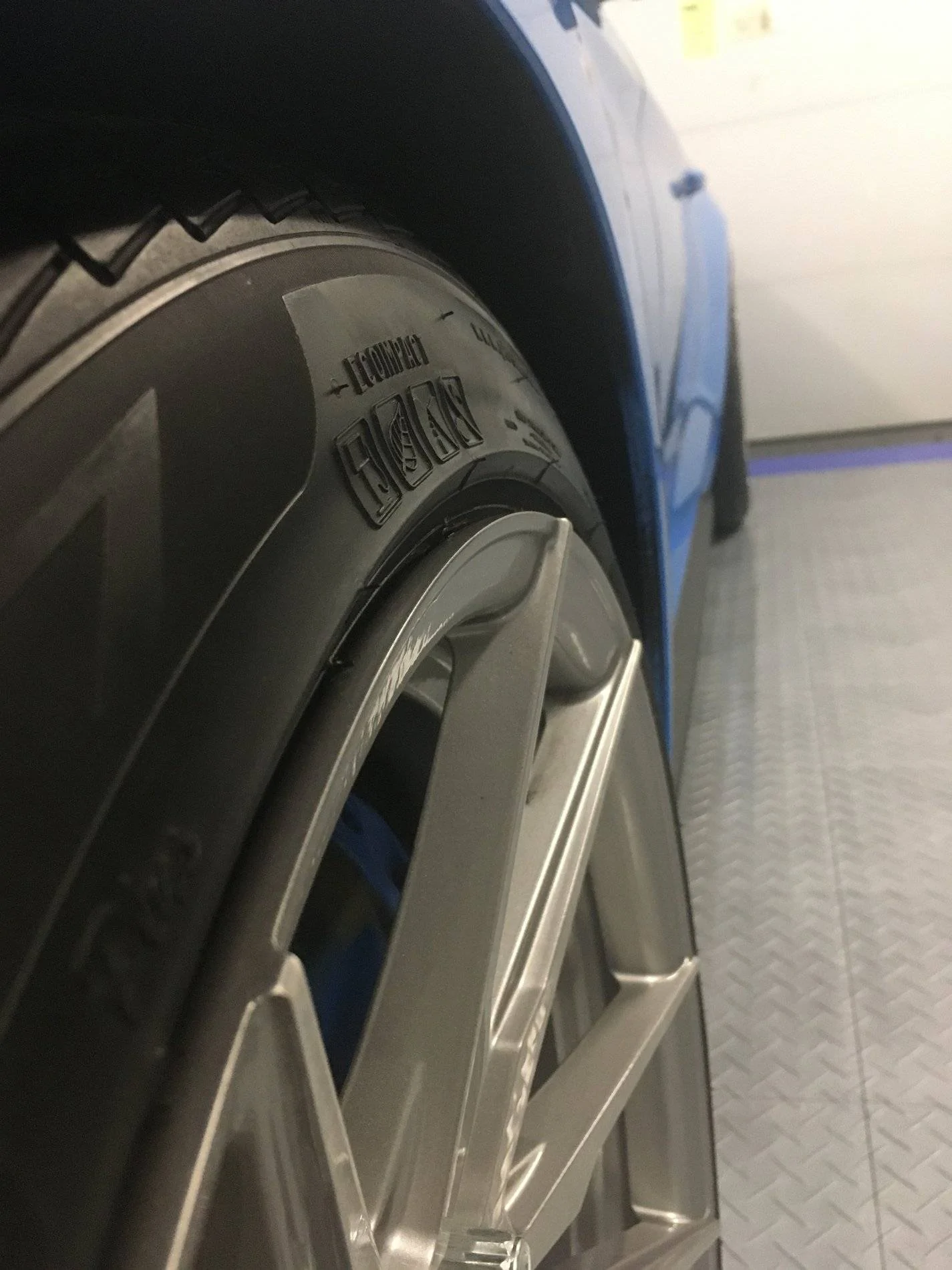

I have brand new wheels 19.5 40 offsetwith 5mm spacers all’s round, it’s 35 with spacer

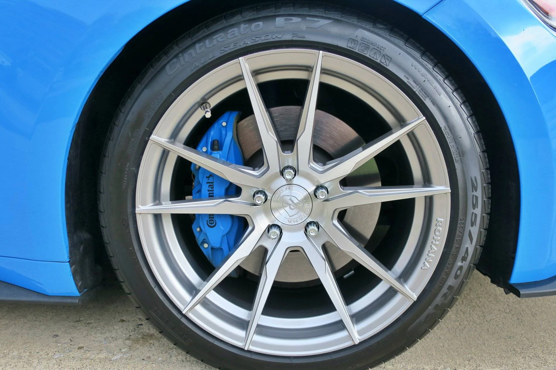

I had my 255/40/19s put on and I didn’t realize it had a gap and isn’t protecting wheels, the charts said 255 is fine on a 9.5 but guess not for me

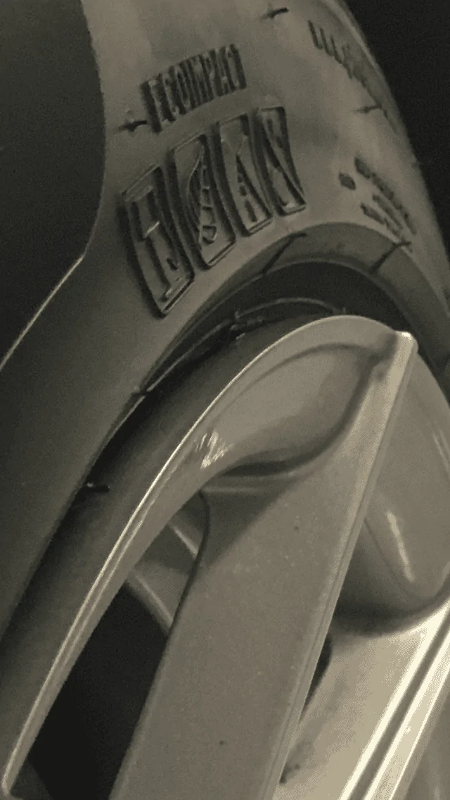

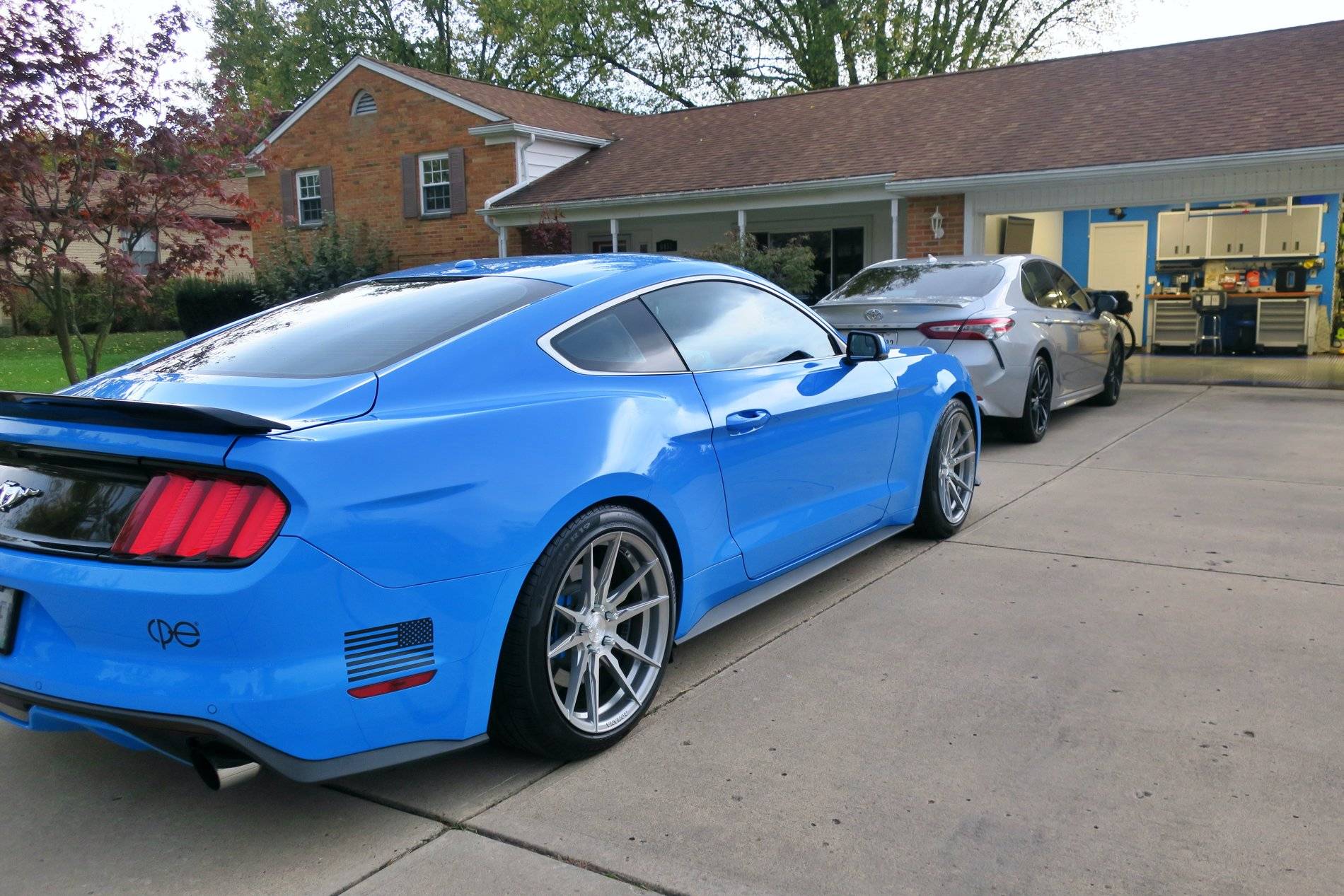

posting pics. I called discount tire and they said a 275 / 40 /19 will fit on my 19.5 with 35 offset all around
will this cause a ton of poke before I order or will itlook good?
Just upsetting a know? I just paid $$ for those rubber 4 months ago or so
will 275/40/19 on 19.5 with35 offset all around cause any issues or look good or dumb. I’m getting new lugs tomorrow too. These are temorary
also, they quoted me 1167 for 275/40/19 in continental dws06 squared and installed and w warranty. They aren’t charging me labor if I get them.
should I look at 30 or 35, I read people online do it. Let me know best option to make wheels work

255/40-19 is tire industry OK'ed for fitment to wheel widths anywhere from 8.5" up to 10" wide, inclusive. That says nothing about either subjective appearance or ability to protect the wheel from curb rash. On 9.5" wide wheels, a 255/40 tire will measure about 260 mm wide at the widest portion of the sidewall. A 9.5" wheel actually measures about 10.5" outside to outside (or ~267 mm). Those are approximate width numbers; actual tire widths and profile ratios vary slightly from the nominal size numbering.
275/40 would be a better fit as far as providing rim protection goes, although you'd probably sacrifice some turn-in (steering) response.

Its your wheels, they have unusually large rim on the wheel face. You need a tire with a large rim protector and even then, IDK if it will come out past the wheel. A +20 wider tire may only be a few mm wider where the wheel face ends (because they all seat to the same bead location on the wheel).
IIRC MP4S have a larger than usual wheel protector. I don’t know how much wider it is than the tires you have tho.
if you do change tires, consider goong to a 285/35R19 instead of a 275/40

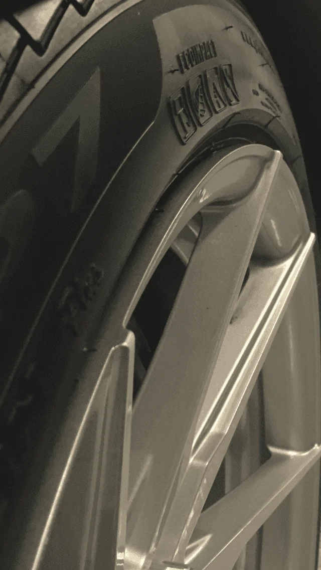

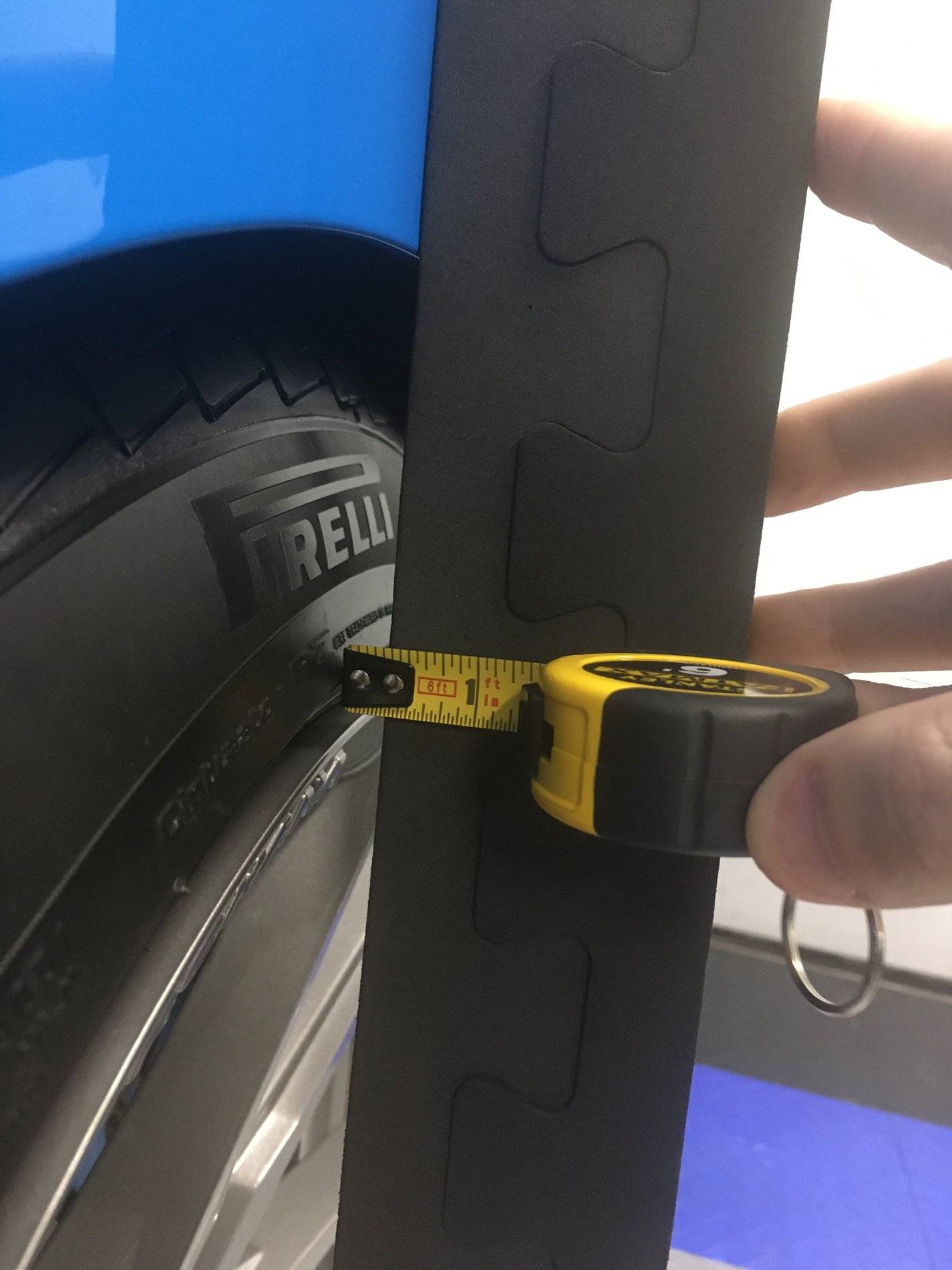

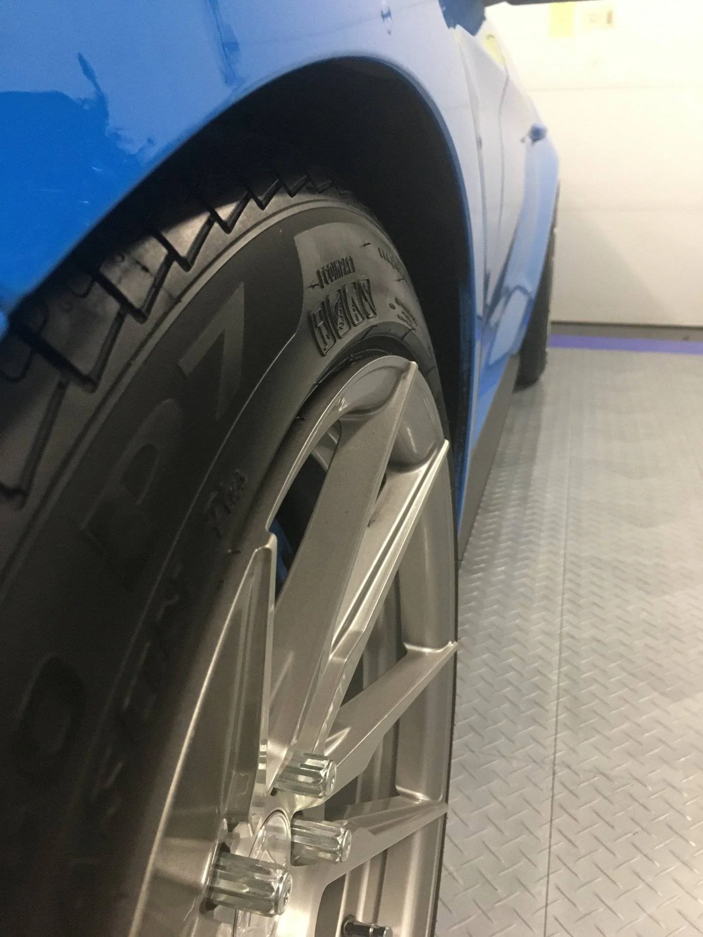

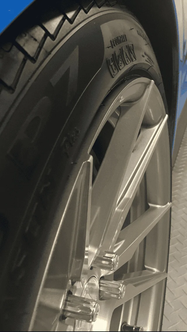

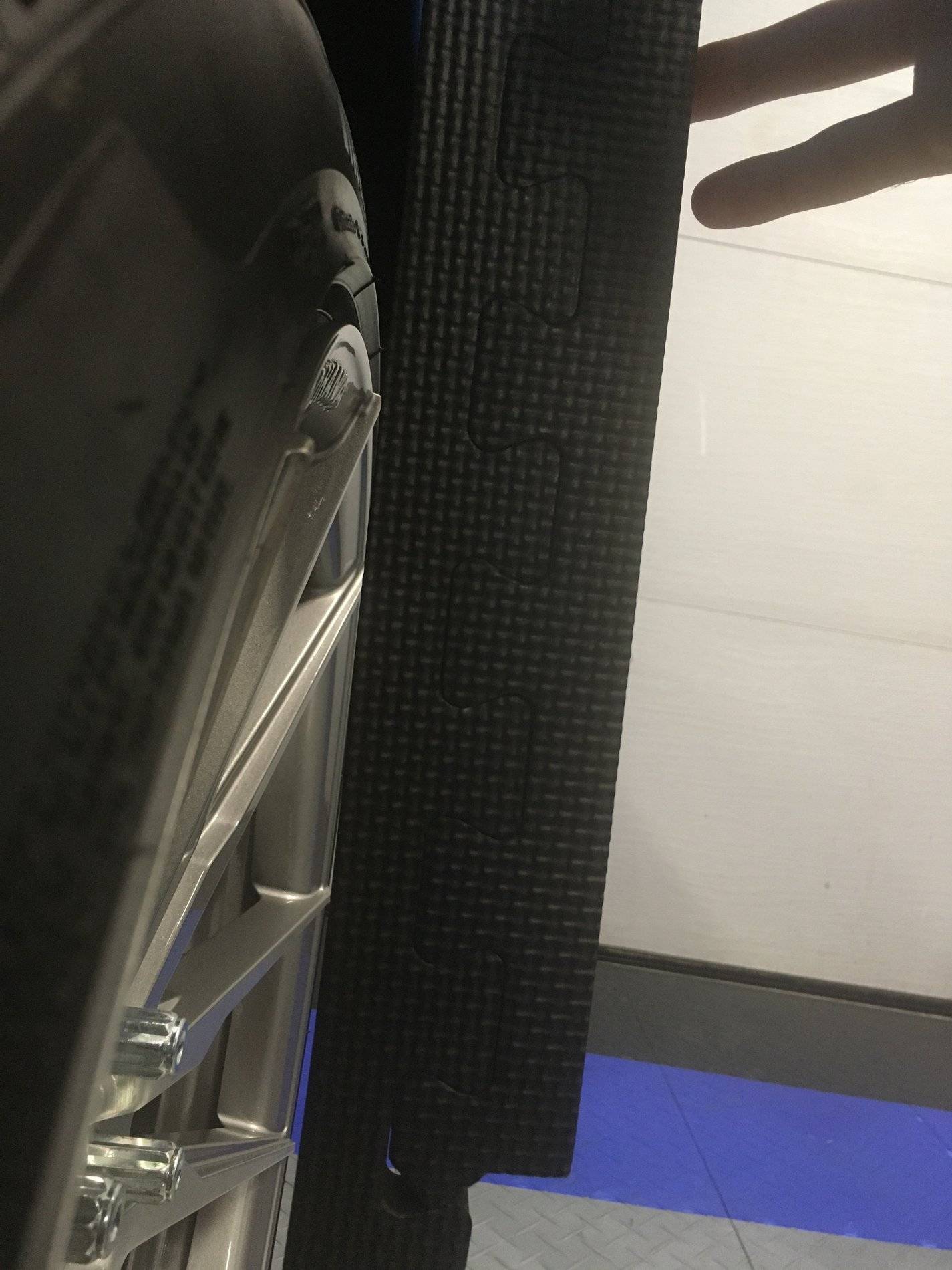

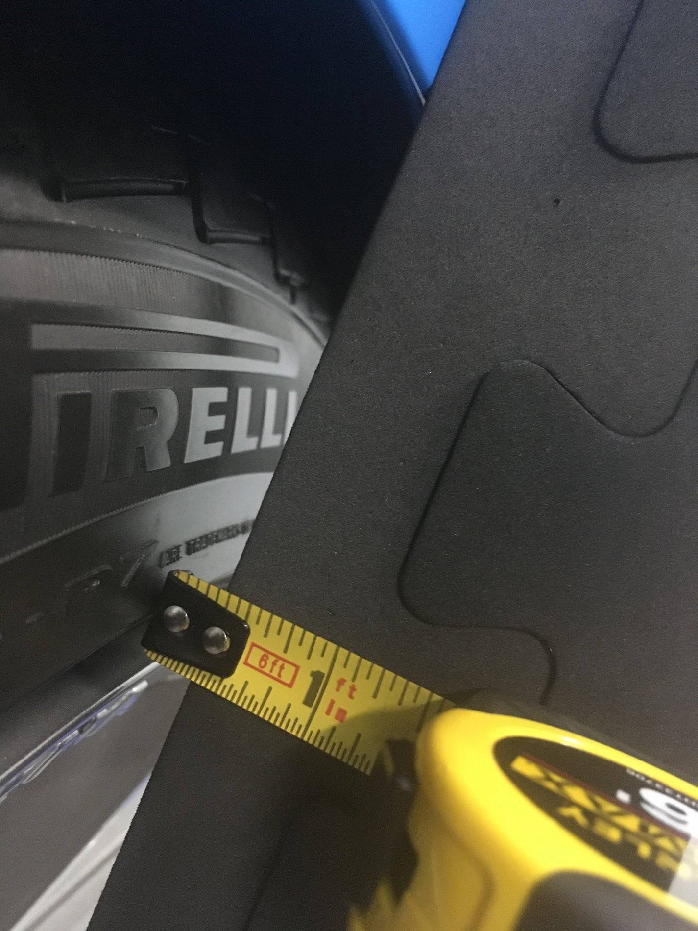

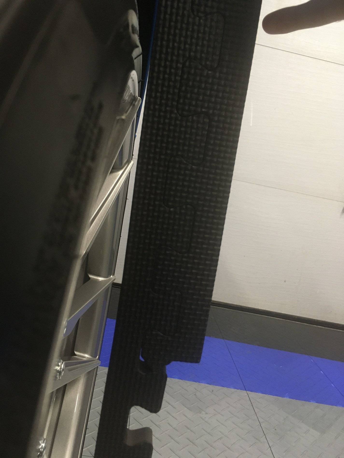

You're at least going to have to lay a straightedge across those spokes and measure how much space exists between the straightedge and both the tire sidewall and rim protection rub strip.
Ideally, you'd pull the wheel & tire and make the same measurement on the back side as well, and measure the overall width of just the wheel (including the extra spoke width).
I think your current tires measure 10.4" wide as mounted, or about 265 mm (in the future, please provide tire mfr & model information, as chasing this information down was a PITA with Pirelli calling so many different tires "Cinturato P7"). A 275/xx tire on 9.5" wide wheels is only going to buy you around 10 mm more section width (5 mm wider on the outside and 5 mm wider on the inside). Probably less than that at the rub strip. A 285/xx tire on 9.5" should get you about 20 mm more section width (10 mm more inside than now, 10 mm more outside). But just based on your pictures, I can't give you any confidence that even a 285 wide tire is going to give those wheel spokes enough protection. And a 295/xx tire needs to be on wheels at least 10" wide.

holy crap that’s annoying and I appreciate all the help. I will go out now and get some photos. I’m thinking I’m going to go 285/35/19 just because it’s that much more protection, as my wheels are weird as fuck.

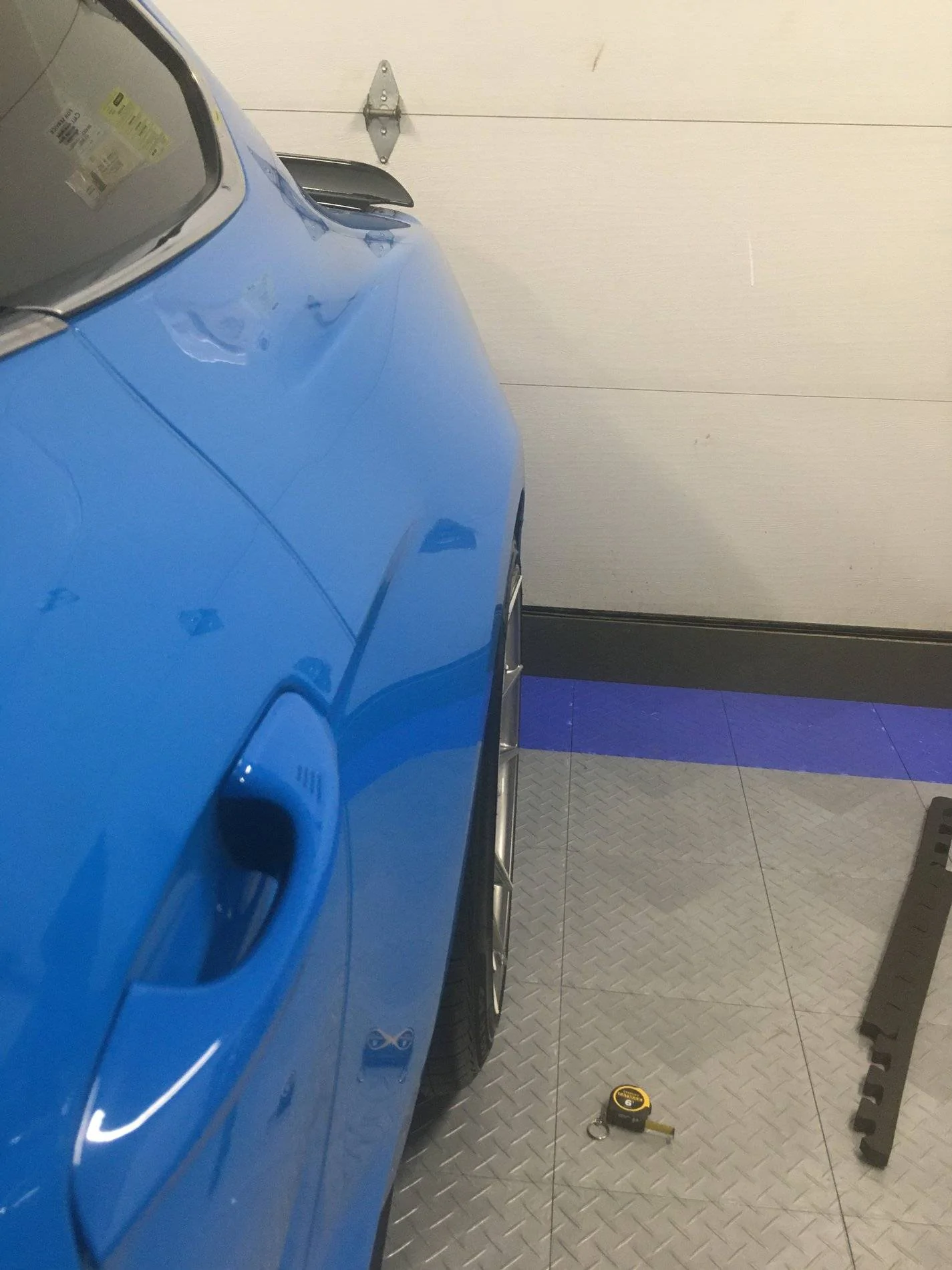

Will that make the front stick out further than rear? I have to have 5mm in front, or else will hits caliper
So rear 40 offset
Front offset 35
Tires all 275/40/19 or 285/35/19 would the fronts be further out than rear? I thought there was only 3mm difference from front back
Took photos

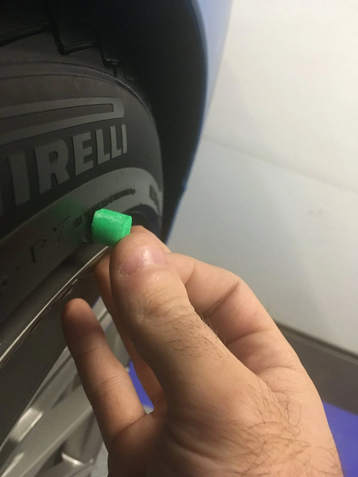

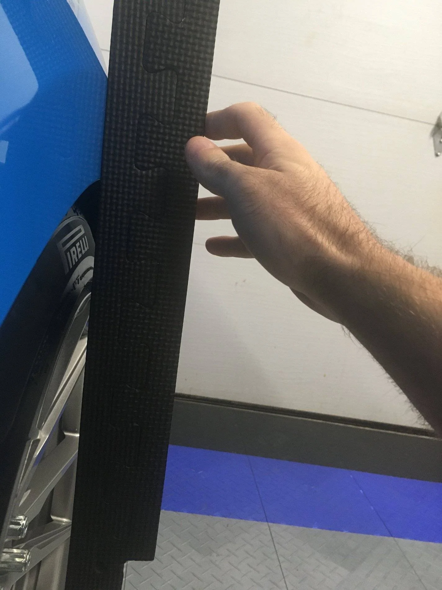

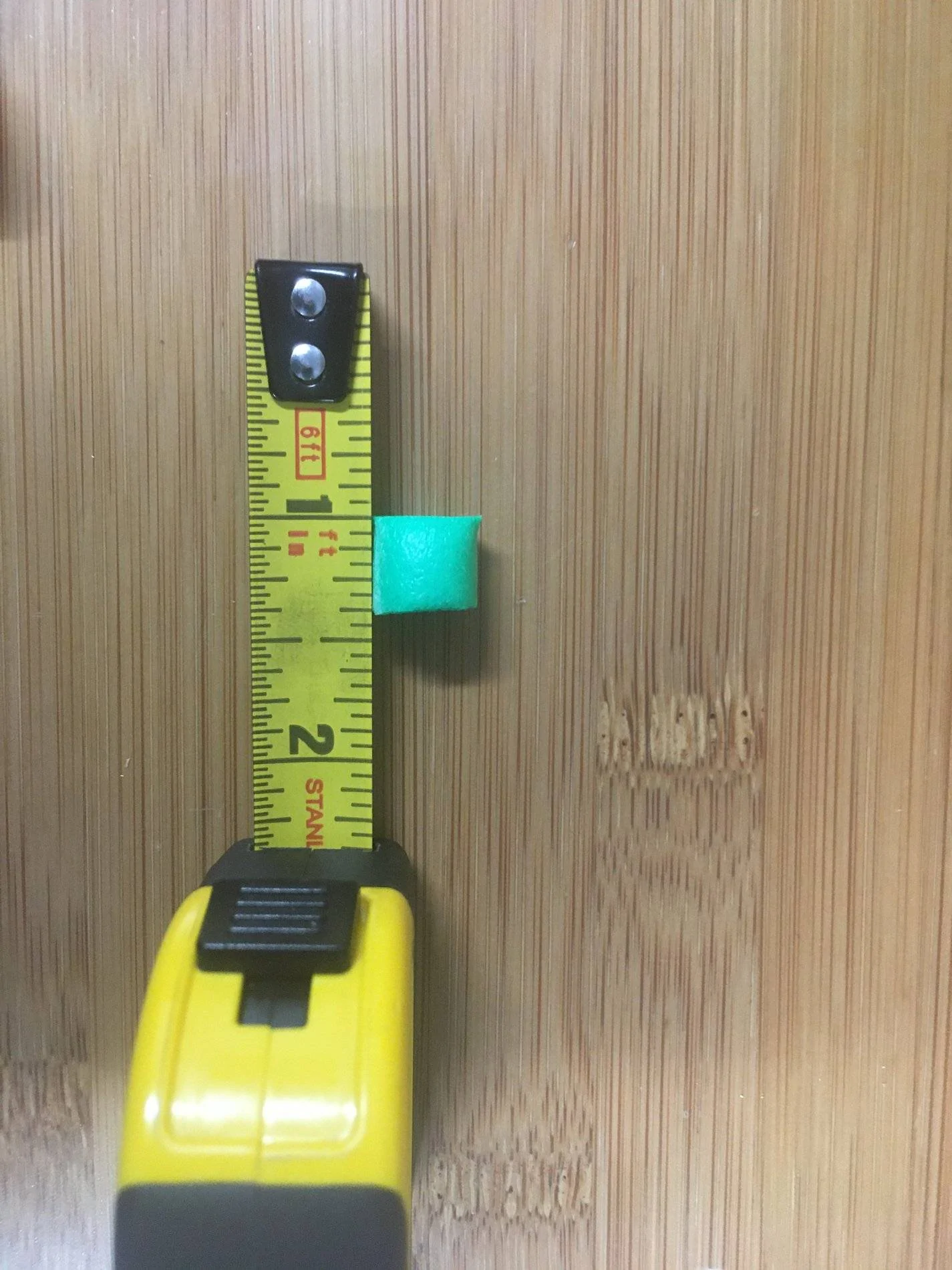

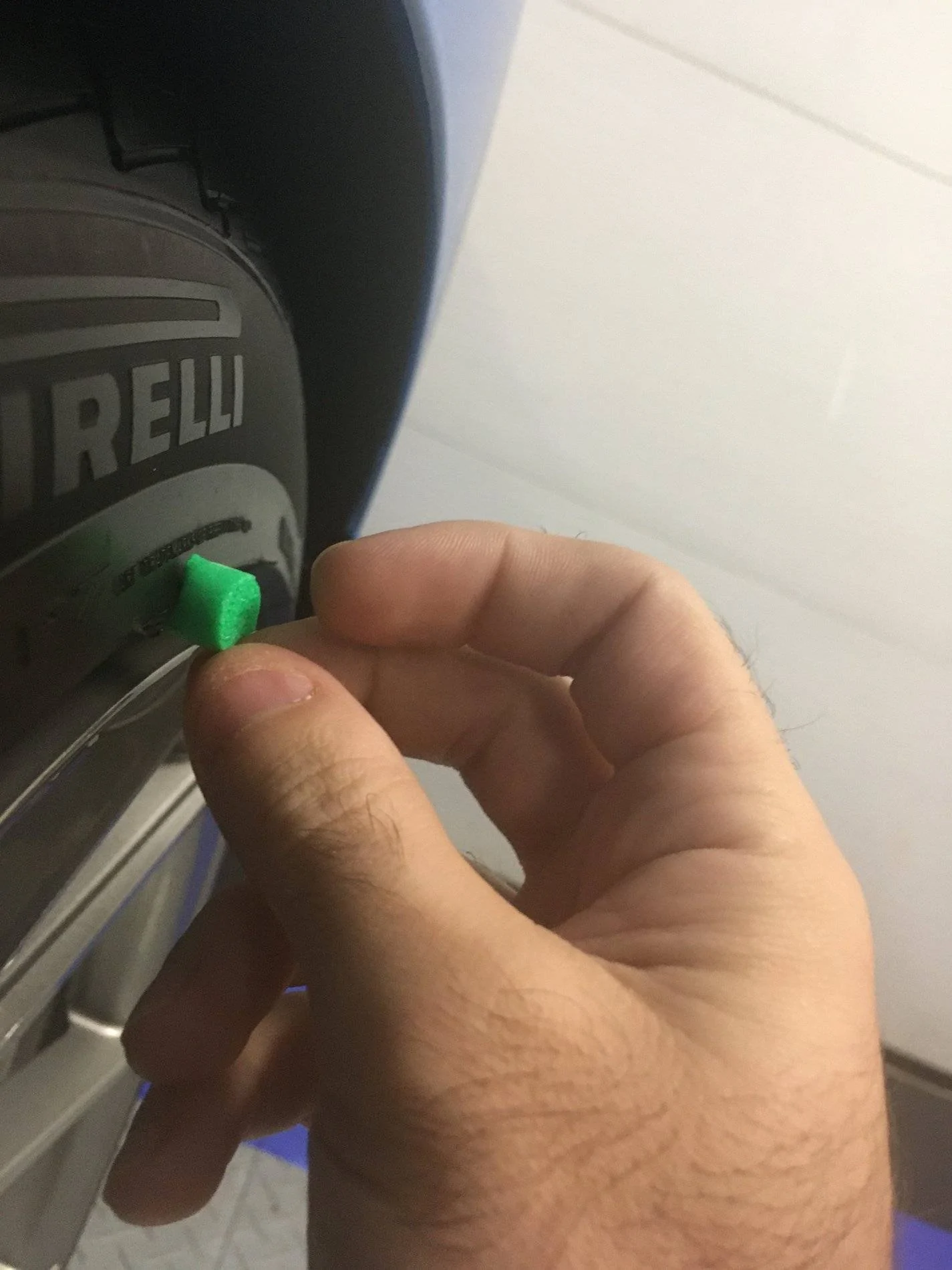

is this an accurate representation of how far out it will become? 20mm I think means each side goes out 10mm more right? So I cut an ear plug into I think .4 of an inch and put beside the lip.
Norm Peterson
corner barstool sitter
Jul 22, 2013
8,852
4,652
Norm
'08 GT #85, '19 WRX
The 10 mm section width gain is going to come in at about mid-sidewall height. At the rub strip, the added tire width will likely be less (because it's more closely defined by the flange's inside surface which isn't changing). I don't know how much you might gain, but I wouldn't expect a lot.
