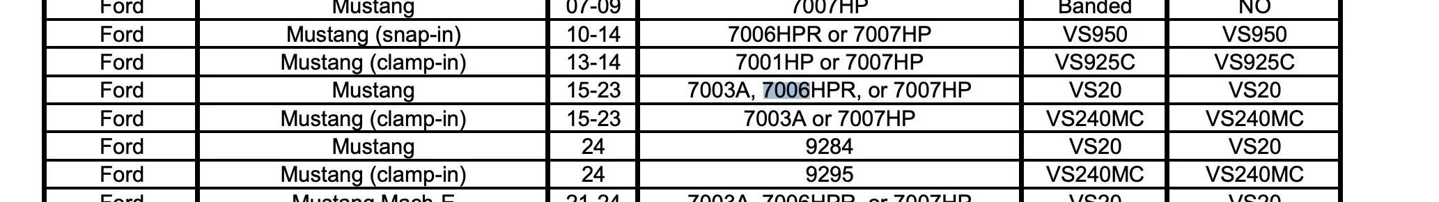

Dropped off my new wheels at costco and had them install tires along with TPSM sensors (they're these 7006HPR Dill sensors). I checked their guide and it's supposed to work with Mustangs.
After bringing them home and installing them I drove about an hr but the sensors haven't synced up yet. I tried using this aftermarket TPMS19 tool after doing the whole relearn procedure but it won't recognize the front left tire at all.
Could it be that my cheap tool is just bad? Should I just go back to costco and have them perform the relearn since I'm assuming they do it for every car that comes?
