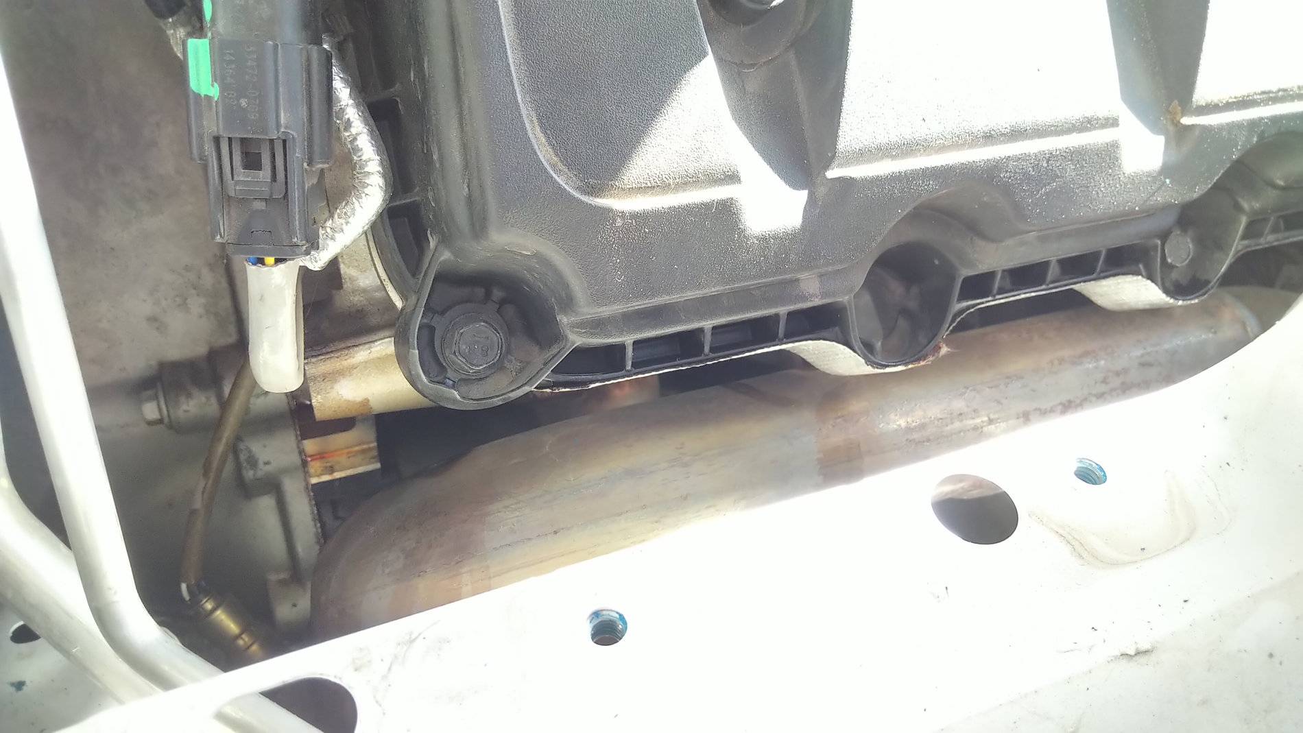

You will have to get underneath to see if that is the leak, it won't be visible from above. Mine had a similar smell, under the car I could see the oil dripping onto the headers causing it.

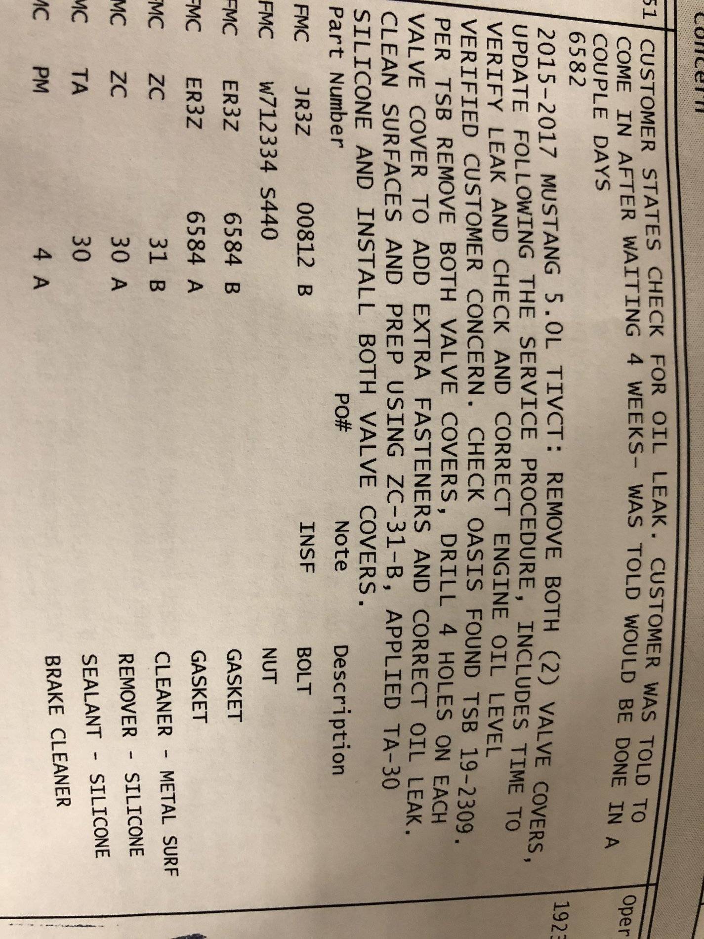

just went through the same thing. was a valve cover leak - ford recently put out a TSB for this for 15-17 models

Thanks for this. Just got my car back today from having this fixed. You were 100% correct.
