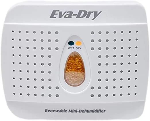

I also have a couple of dehumidifiers in the car (like an EvaDry).
These things will soak up moisture (great in the winter storage months for myself) and can be dried out and reused over again.
