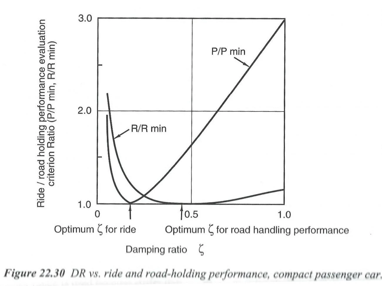

Here's a plot showing (more or less) ride quality and performance vs damping. This is in terms of "critical damping", so it's generally applicable even if the curves varied a bit. Taken from the classic text by the Millikens (father and son) "Race Car Vehicle Dynamics". That funny little squiggle character is the critical damping parameter.

Looking at that plot brings back some faint memories. In college the professor actually called that "critical dampening" symbol "squiggle", I don't think he ever mentioned the real name, but if I recall it was properly called zeta, but that might just have been some slang as well. The reason I was concerned about messing with just shocks applies to "squiggle". In college the target on any system was to get squiggle to be critically dampened meaning =1. Looking at that plot the desire is always less than 1, so I guess by adding stiffer shocks to the system as it was designed just moves squiggle closer to critically dampened. So that makes sense. In college everything was a simple problem, no where near as complex as an entire car's suspension and all the different types of conditions it must satisfy.
It is 'zeta' (lower case), and no, you do not want full critical damping in a road car's suspension (especially at high damper piston velocities where all the short, sharp bumps put them). For the street handling/composure you definitely want something more than the roughly 18% critical damping for optimum ride without going too far past 45% . . . keeping in mind that those percentages might not be perfectly accurate for any specific car.
Adjustables also offer the ability to compensate at least to some degree for gradual wear by their ability to be dialed up.
