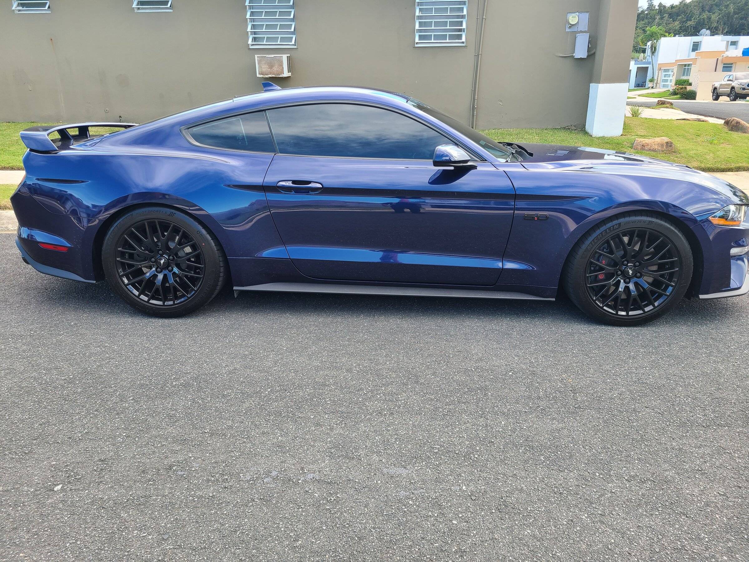

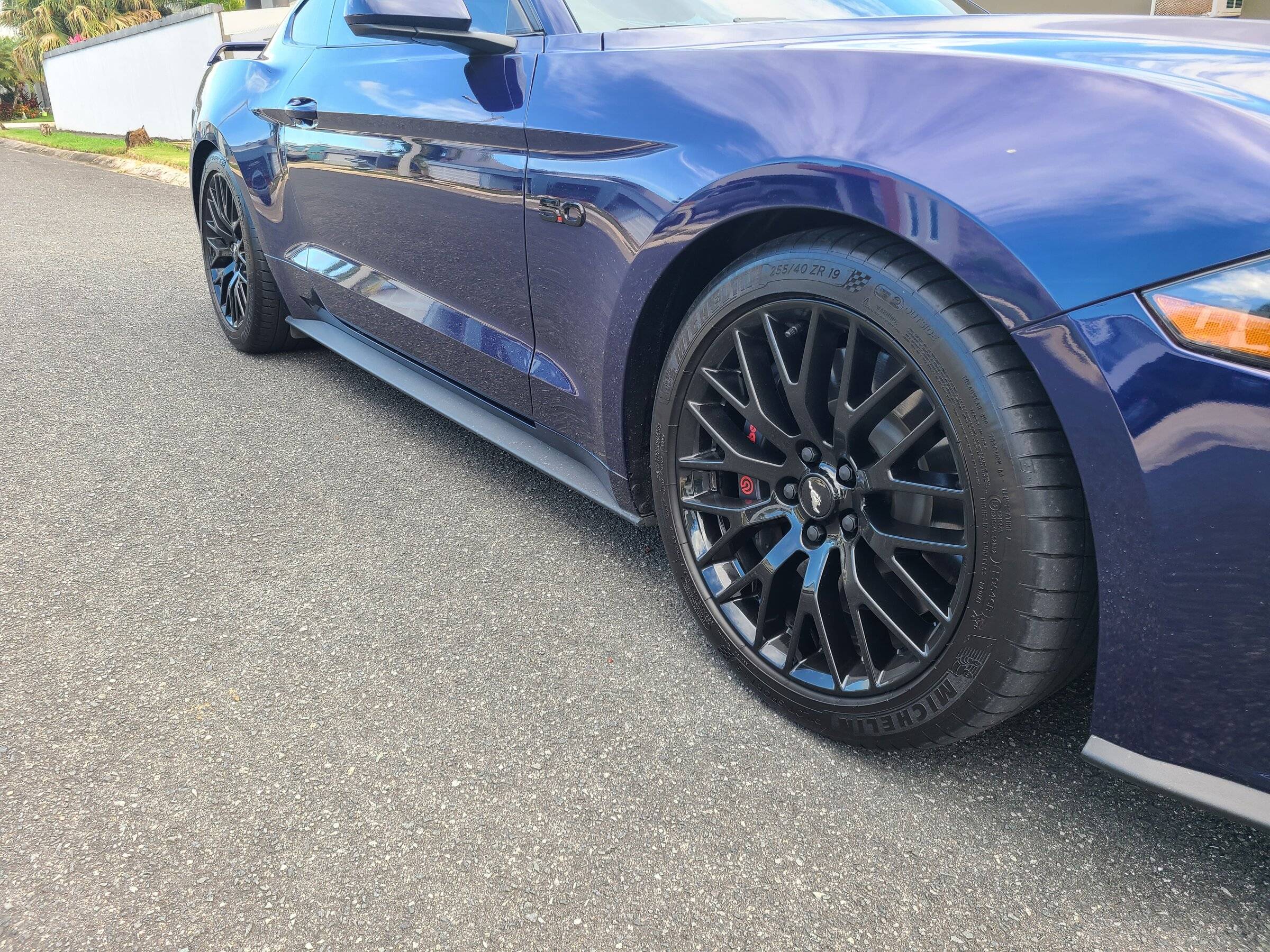

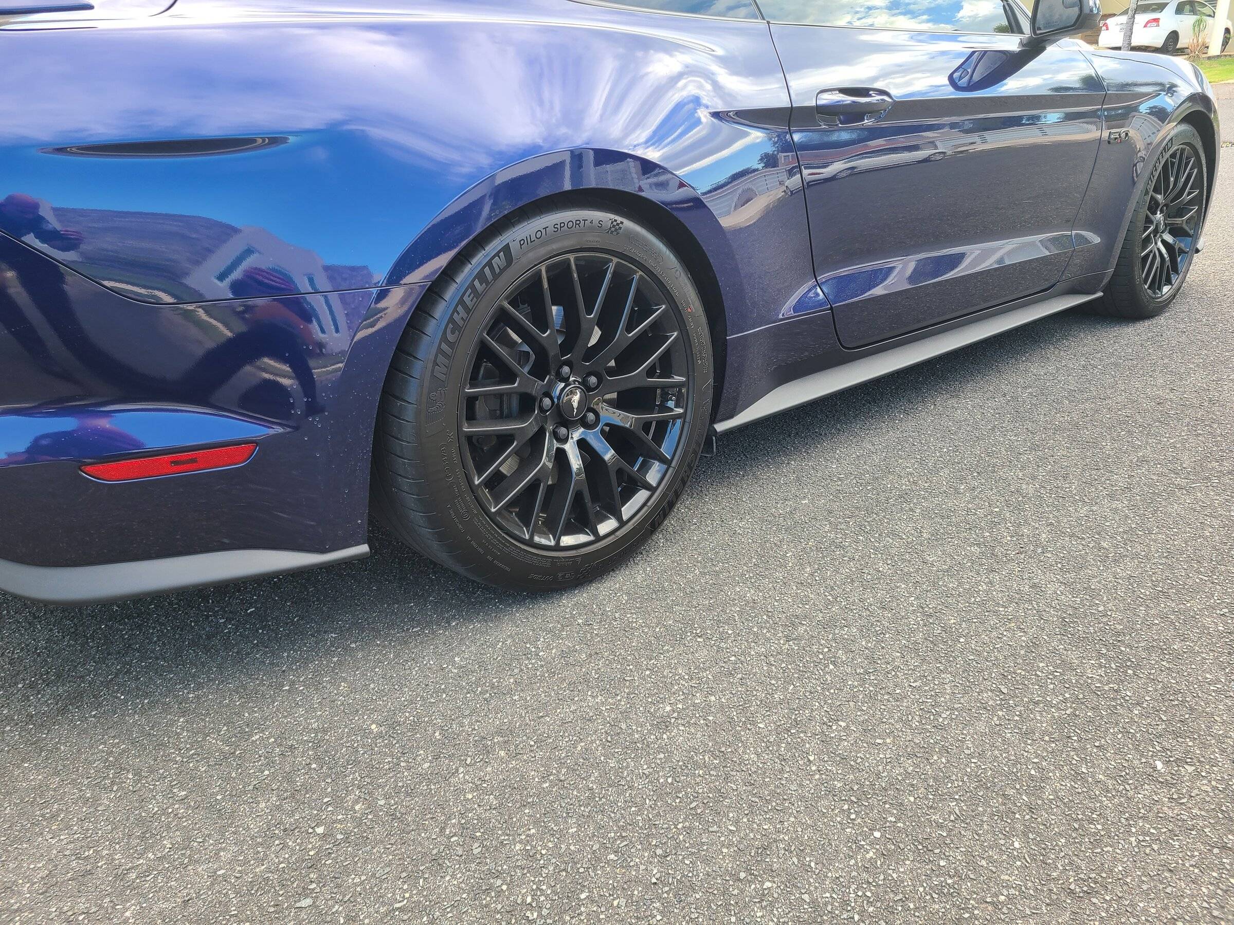

@mtr5.0 The car looks and ride amazing.

Curious.....how much did that drop about 3/4 inch? Also, why new springs with such a drop, just wondering, looks nice!
I didnt change my stock shocks with the sportlines, now you have my attention!!

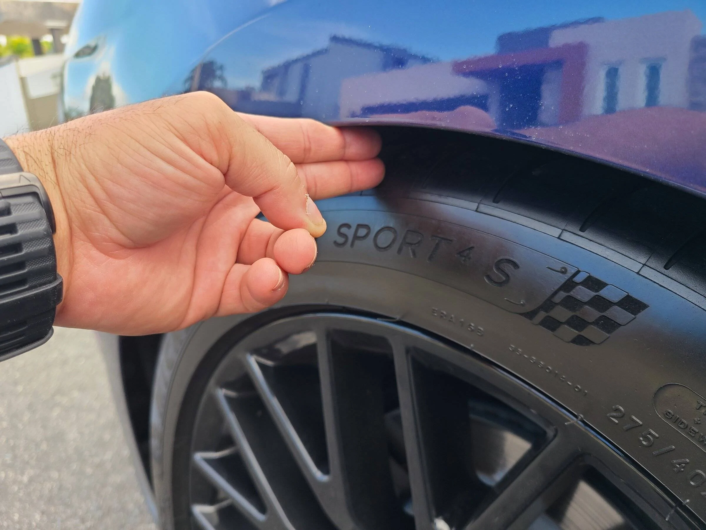

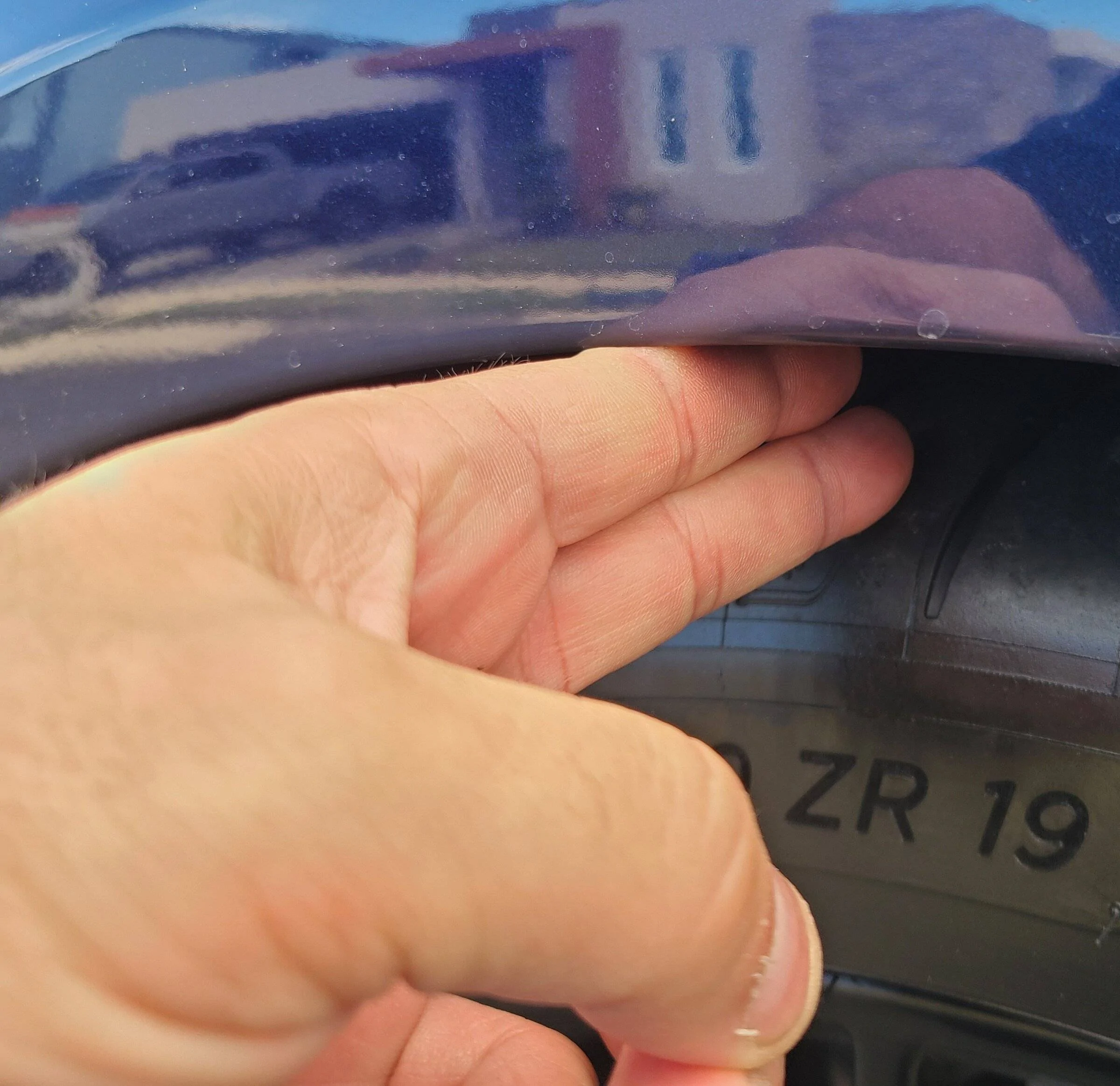

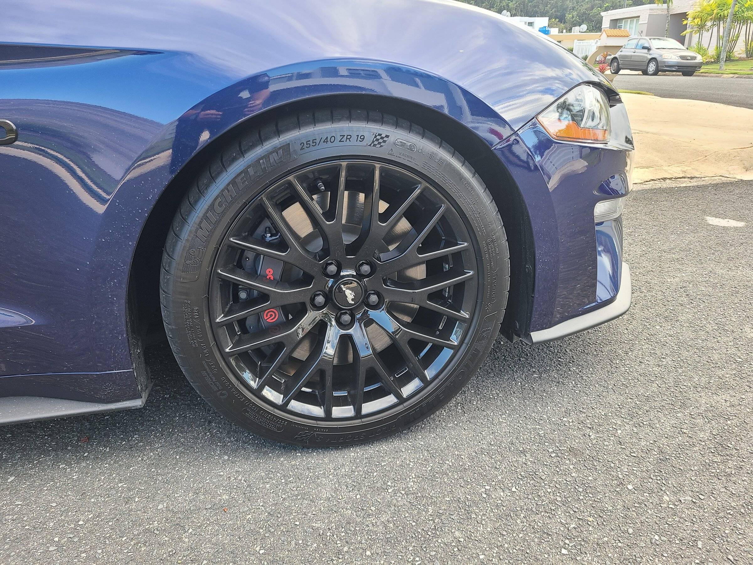

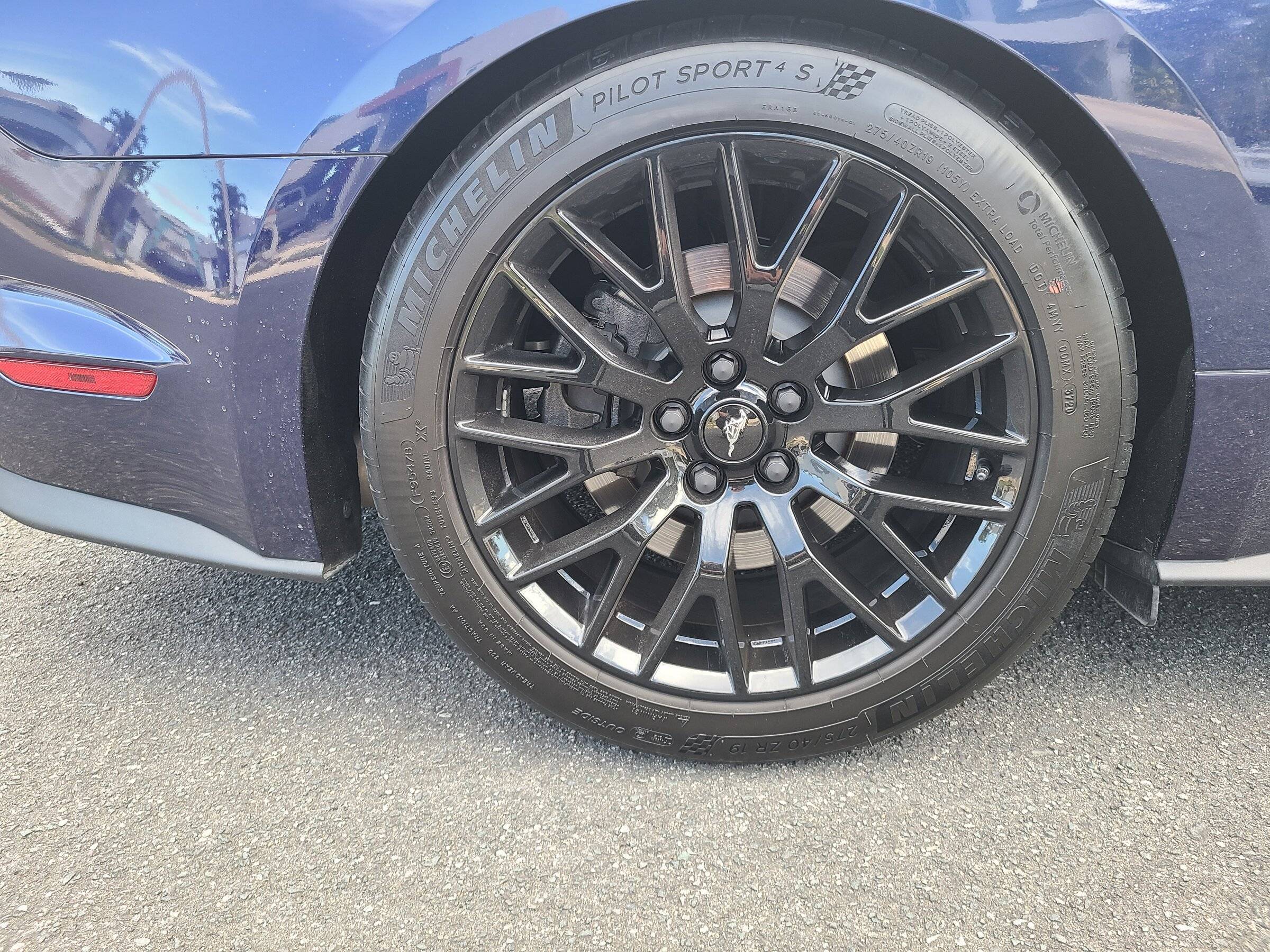

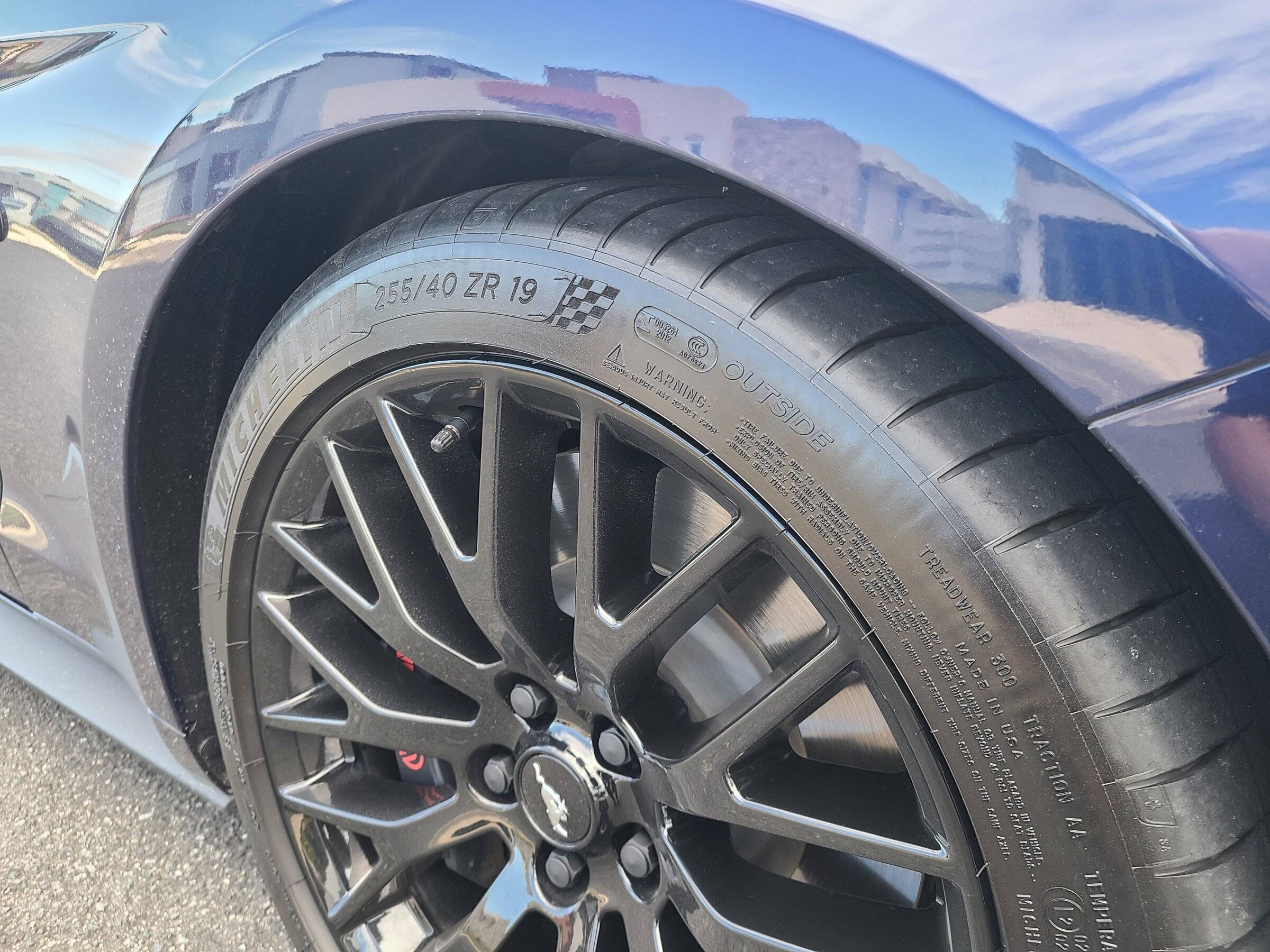

mtr5.0
Apr 12, 2017
167
detroit
2020 mustang GT Shadow Black 401a A10 3.15 gear
I went with the Pro active struts and minimum drop springs. Great ride. No issues.

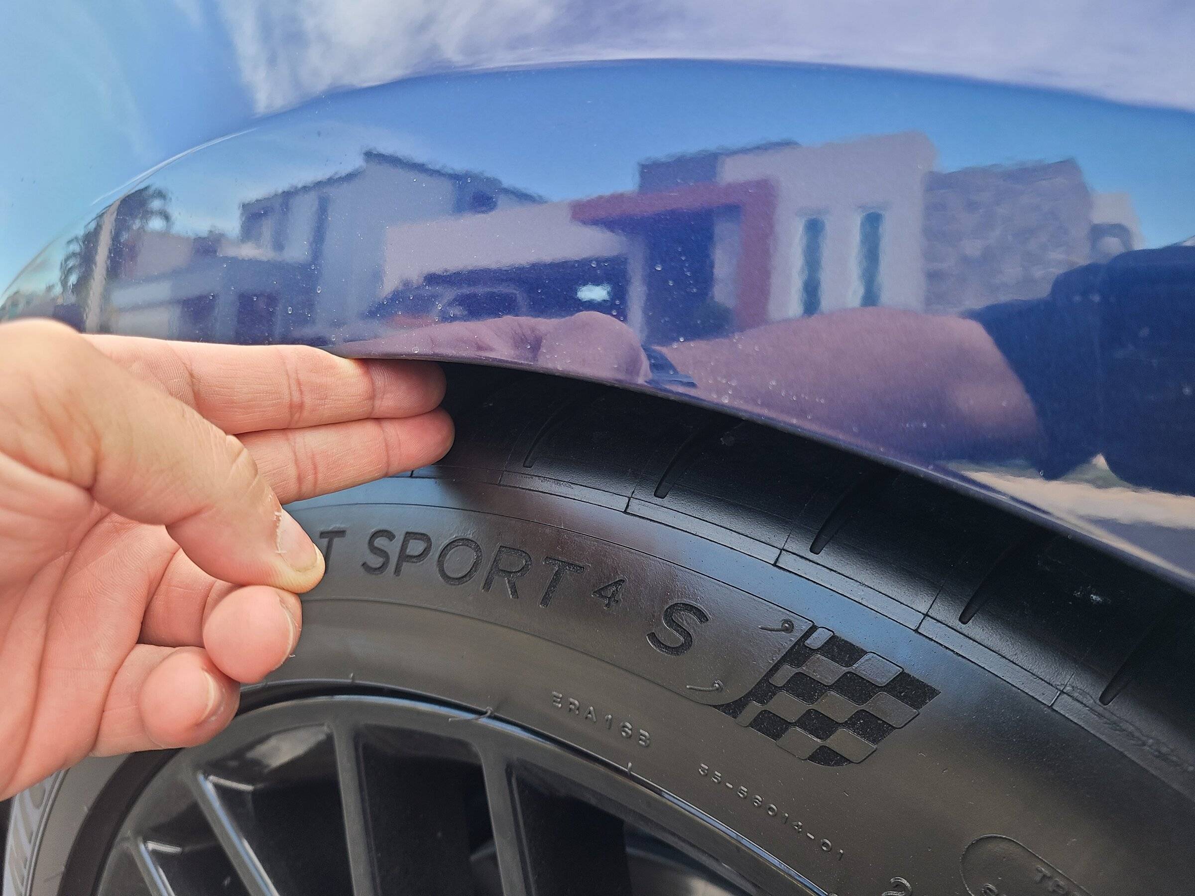

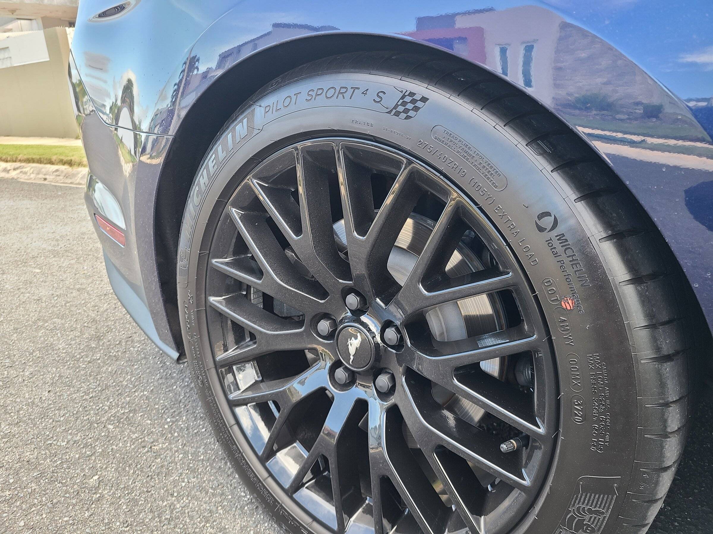

so do you think you got more then a .5 drop with the min. drop springs & Pro-Actives combo ?
im hoping for a little more then .5 inch drop, i have more wheel gap with the wheel/tire
set-up im running ( 26.9 diameter tire ) your michelins are listed at 27.7 " diameter ..
larr12
Jul 9, 2020
1,123
1,723
Alberto
2020 Mustang PP1
I would say around a .5 inch drop.
