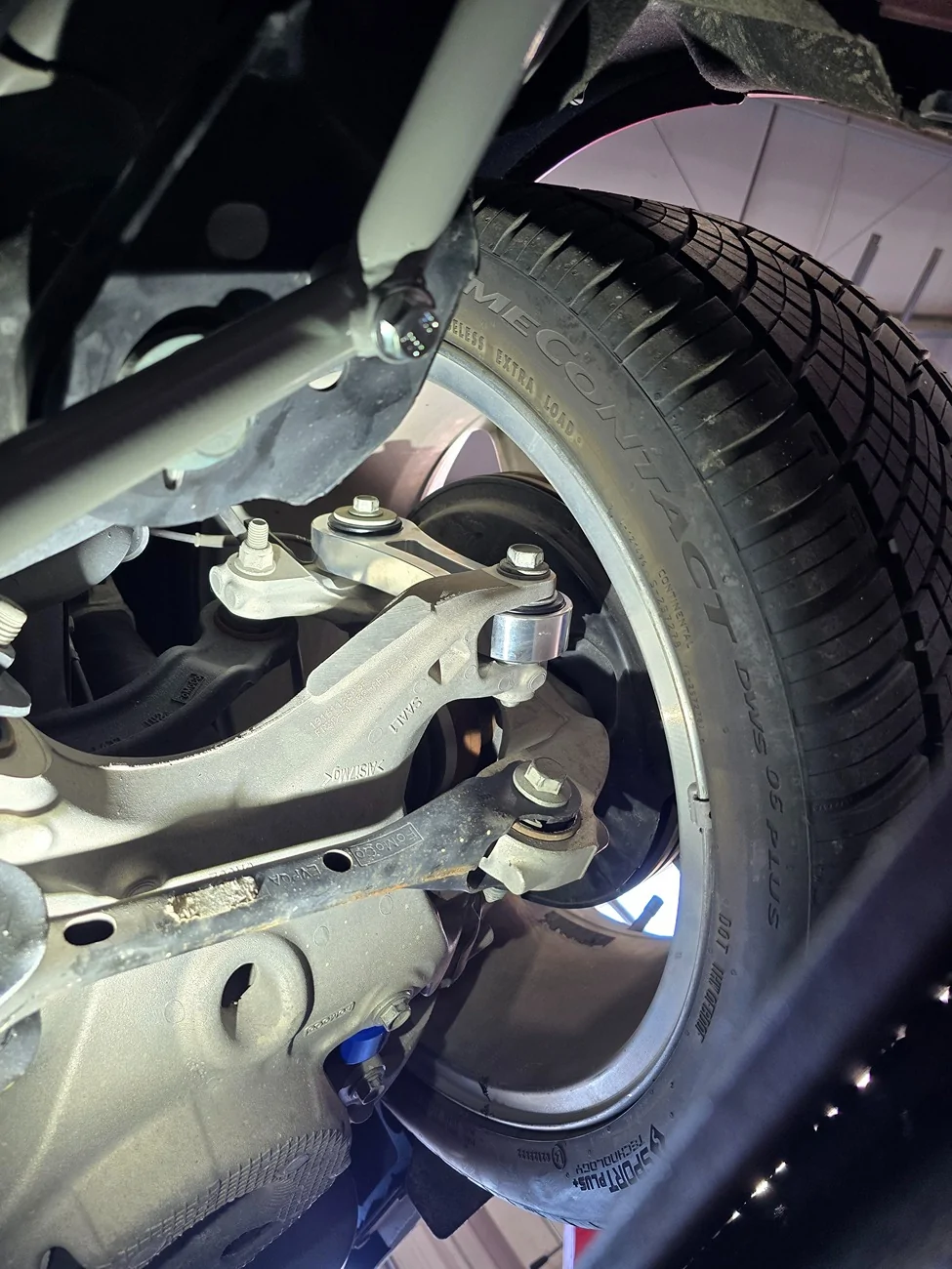

Update:
I got the car back today after all of the Steeda parts were installed.
555-8150 Pro-action shocks & struts (non-adjustable)
555-8223 Minimum drop springs
555-8139 Camber plates
555-4129 Billet Aluminum vertical links
555-5754 IRS subframe support braces
555-4437 IRS bushings
555 4438 IRS alignment kit
It feels solid and drives so much better than before. I only drove it a short time before I had to get back to work, but I'm looking forward to getting it out on the road again soon.

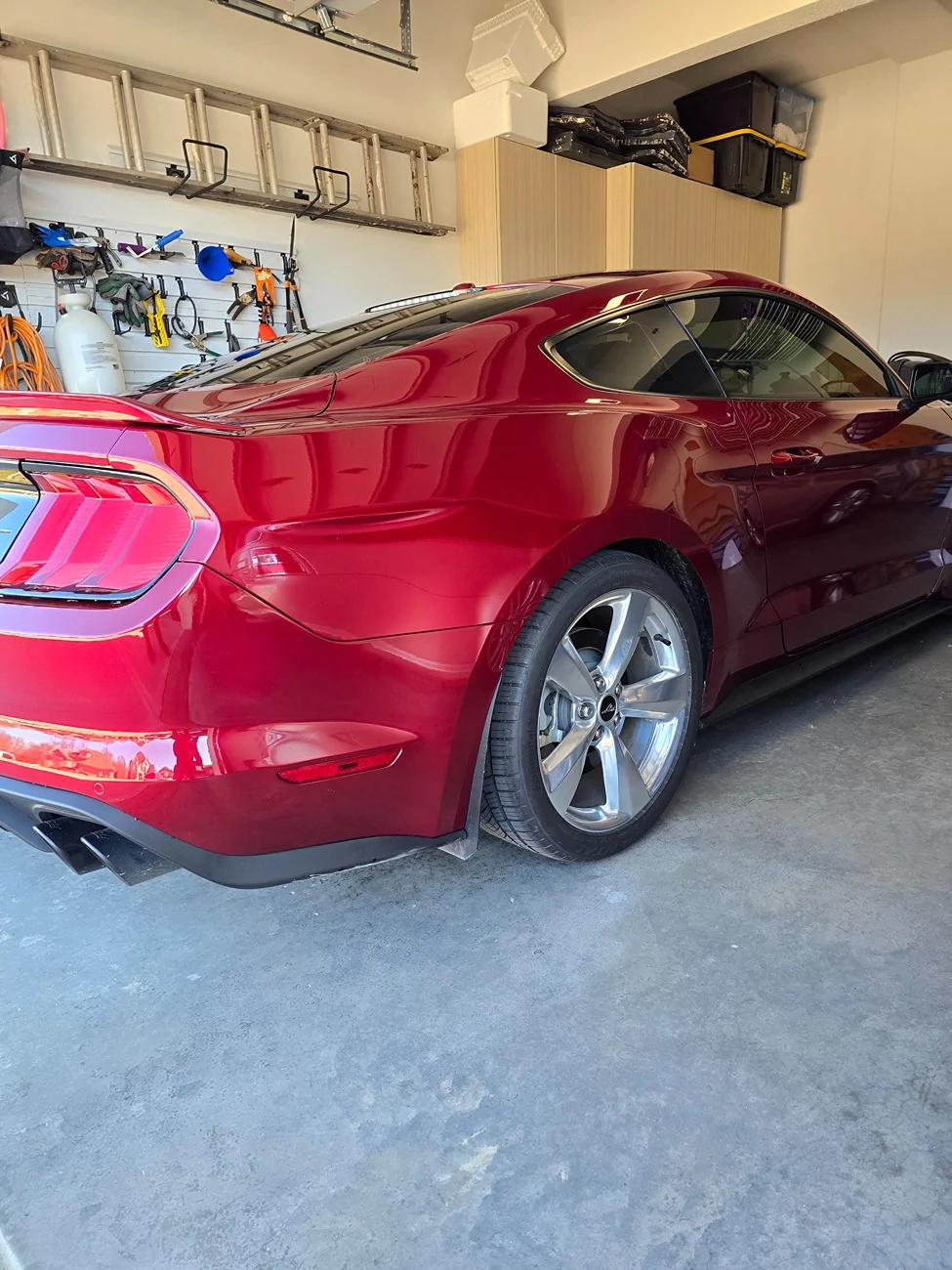

Now that I have had some time to test the car out, I can safely say that the Steeda parts have transformed the car. I used to feel the car fishtail a bit when I accelerated very quickly, but now I can step on the gas and the car only goes where I steer it. @Steeda-Sergio

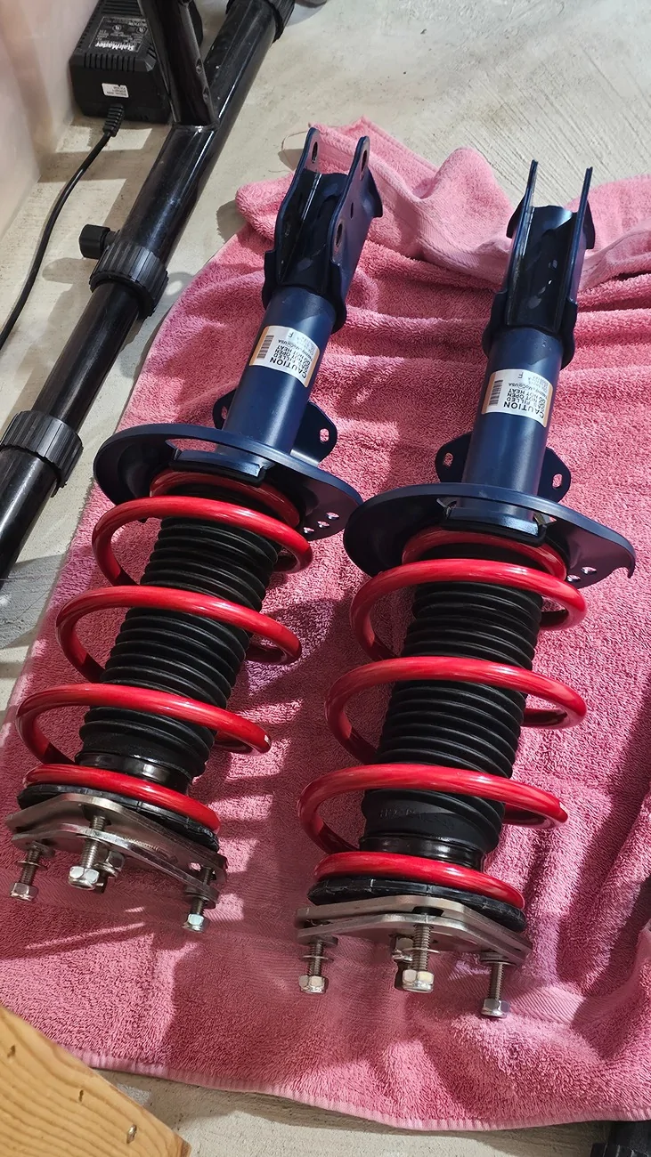

Just to clarify. The kit I’m referring to is
M-18000-F which I pointed out in my original post. Pick your springs of choice and that’s it. This kit is in stock from multiple sources.
That's the kit I ordered. Took 2 weeks to get. I installed my BMR springs and Steeda camber plates last night. Now I have to wait until spring before I install them on my car.
