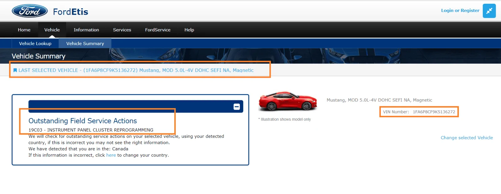

EDIT: I checked here:
https://vinrcl.safercar.gov/vin/
... and got zero (no recalls). Either my Bullitt isn't affected, or Ford hasn't listed it with the NHTSA yet.
Additionally, it may help to check Ford's own ETIS website, where you can enter your VIN and check for any "Outstanding Field Service Actions" - A.K.A., Recalls.
Link:
http://www.etis.ford.com/vehicleRegSelector.do
Pic 1: Screenshot of the ETIS site, where I entered the VIN # of a Mustang GT here, in Toronto, that a dealer has in-stock. (if a unit has no recalls, there will be nothing listed)
