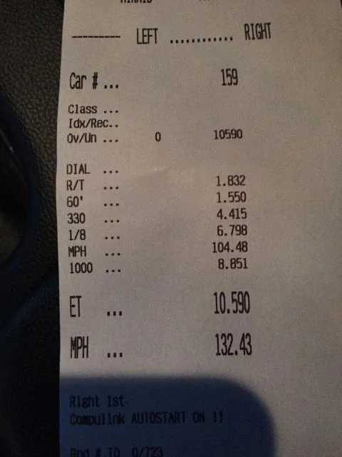

Hi. I hit the track yesterday and I was able to get one pass only because of the NHRA safety requirements. Launching at 2500 and shifting at 7000-7100, the shifts are bucked out. I will get a tune from Ken Bjonnes this week and I am hoping for low 10s maybe high 9s.
Paxton Supercharger 3.48 pulley (12psi)
Fore innovations E85 return fuel system
Circle D 3C converter
Steeda Stop the Hop package
3.15 gears
Full offroad ARH exhaust system
17x10 Weld RTS S71 wheels with M&H 325-45-17 drag radials
Tuned by local tuner

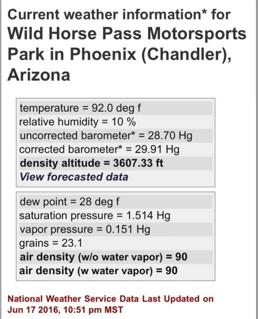

DA is 3600

Nice man! You should rev it higher so you make more boost with the 3.48". Since you're auto I'd go Lund. My time slips don't lie and I haven't seen anyone else come close yet without a converter

3.48 will make more than 12psi on these cars, especially with the rpms
3.6 is the smallest i would do even on the e85 if your doing any kind of rpms.
thats my "safe sales pitch"

My tuner kept the rpms as it came from ford. My gauge and logs shows 12 psi.

You definitely got a ton of room left on a better tune.
This was 2500 DA
Paxton 3.8 pulley
7050 shift points
Headers with stock catback
Circle D 3C
Lund tune 93 octane.
3.15 gears

Nice. I hope for low 10s or high 9s with a better tune in a better weather. This pass was in 92f and 3600 DA.

I saw your car run.. its a beast for sure.. the odd part was you could hear what sounded like the rev limiter at each shift.... I was in the slow as stock white GT that was running around that night...I was hoping to see you run again then I saw you pull off the exit gate... good run!! at one point dragtimes showed the DA at 4400ft... don't know if that is less accurate or not than the NWS?
