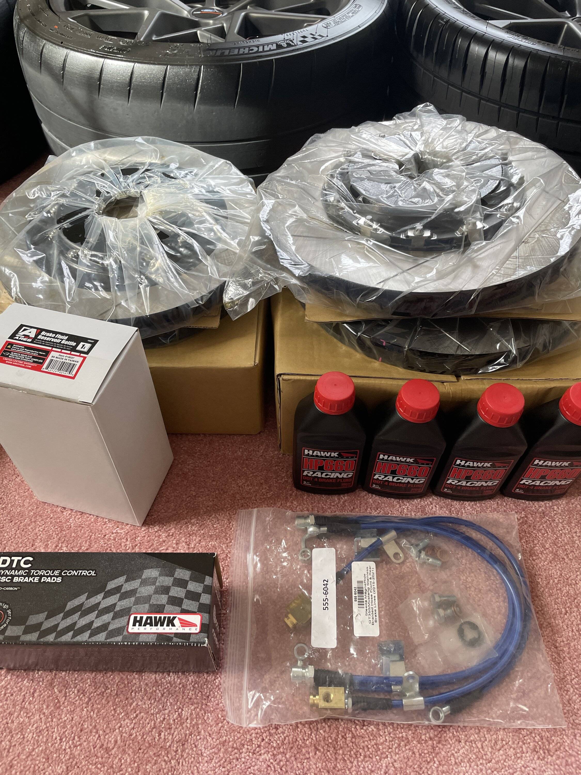

Thank you. What quantity is needed?
Update: From Steeda: " It's recommended to have 3 or 4 bottles for a full flush on your S550 Mustang. "
When I pumped my system dry using the bleed lines before changing to Steeda braided lines. I only needed just under 2 bottles of Hawk HP660 after refilling and properly bleeding the system. (Girlfriend pump and hold method) I had also read 3-4 bottles. Bullshi... Now I have another change ready to roll...
