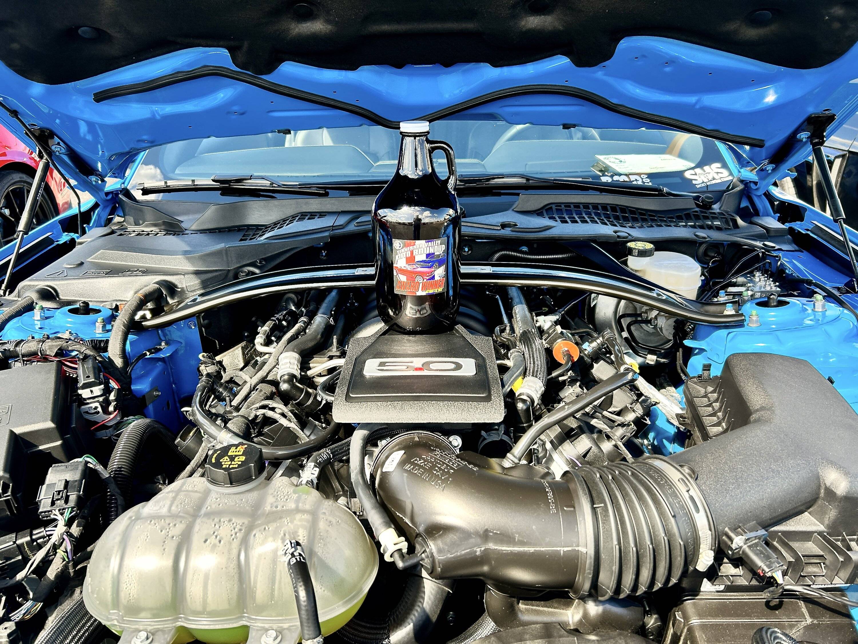

I concur with most of the suggestions. Mine is a 10 speed so I can't comment on the clutch spring but the sound tube delete and carbon filter removal is a no brainer. Mine has 15K on it (22 GT PP) and has had zero issues after removing. The sound tube delete also makes checking the oil a lot easier on a PP car with the strut tower brace. I also removed the engine cover but then I cut the bat wings off it and put it back on. I like the look. Also H pipe/X Pipe sounds really good with the factory active exhaust. I opted for a full cat back though..
PIc of mine with the engine cover "Star Ship Enterprise wings" removed. along with a trophy I won last fall :) .
Not sure how I missed this post but that engine cover looks great. Did you dremel off the wings?
Yeah, it's really easy to do, I just took a sawzall. You just reach into each of the runners and cut in between theIntake runners for all eight. Then from the bottom you can drill out the rivets that hold. It underneath the 5.0 badge. piece of cake. Then just pop back onto the rubber grommets and it holds it just fine.

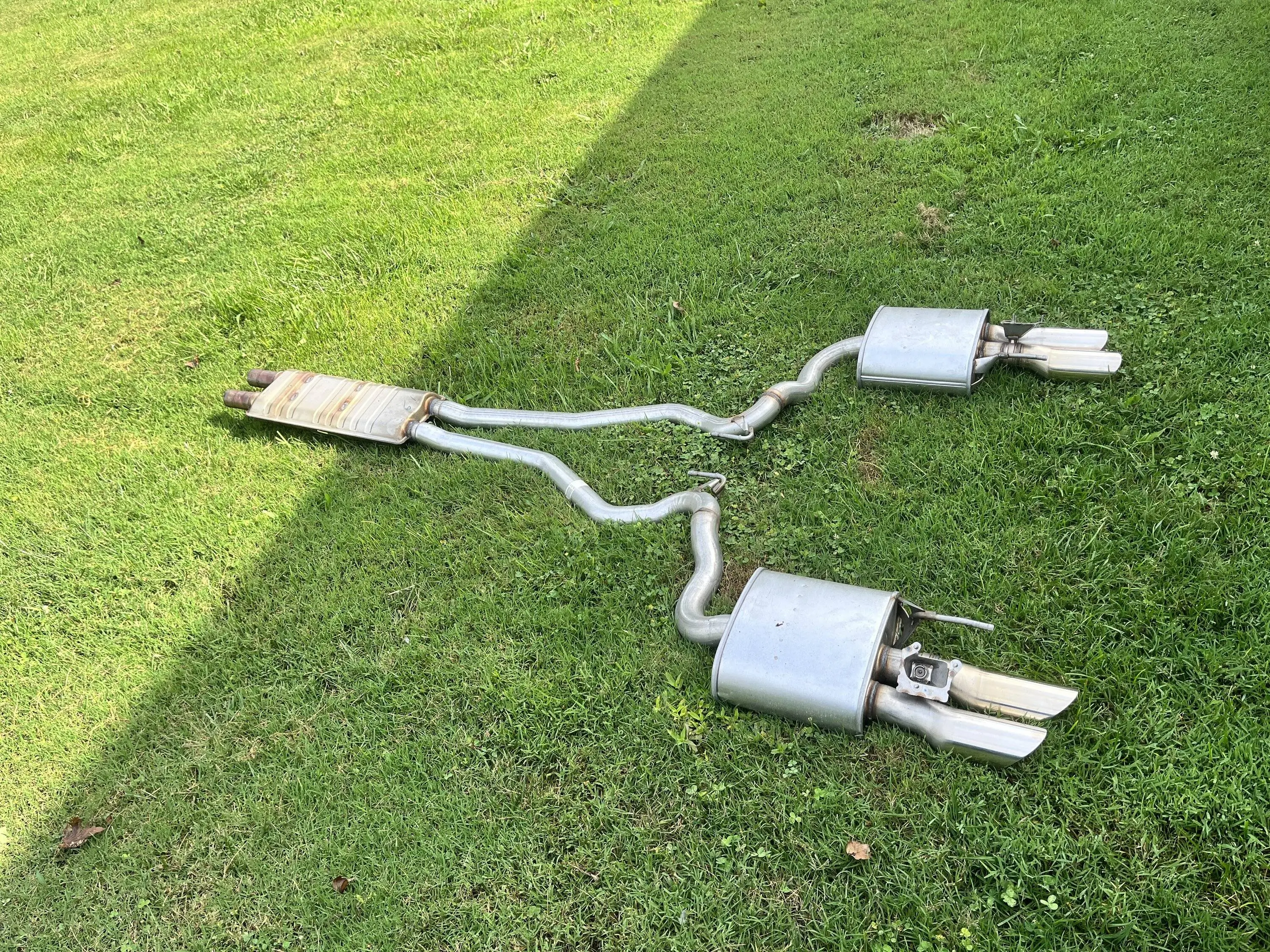

I have the active exhaust, does it still have the suitcase? Haven’t been under the car yet. Thanks for the tip on the spirng
Yep, here is a pic of my complete system removed when I did my Borla Cat Back. Big Ole suitcase thing on the left LOL :)
Torched10
May 15, 2019
107
1,320
542
Atlanta
Bob
2019 gt premium convertible. 2017 caddy xts vsport twin turbo.2011 caddy ext
Nice pics
Nice pics.ill bet it loses 20 hp with all those right angles in the exhaust pipe
