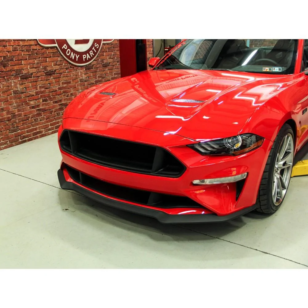

2018 Mustang Cervini C-Series Upper and Lower Grille Installation
Cervini Textured Matte Black C-Series Upper and Lower Grilles for 2018 EcoBoost and GT Mustangs.
[ame="[MEDIA=youtube]Li3pDSq2QzI[/MEDIA]"]
Bill shows you how to install a Cervini Textured Matte Black C-Series Upper/Lower Grille on your 2018 GT or EcoBoost Mustang.
Made right here in the USA, this durable Upper/Lower grille is a great way to step-up the game on your 2018 GT or EcoBoost Mustang.
Acting as a direct-fit upgrade, this polyurethane grille is enhanced with a rich black textured finish that gives your pony a sporty style. Designed with Cervini's aggressive C-series inspirations that improve engine bay airflow.
Without the need for any major modifications, this awesome mod will get you back on the road in no time.
*Fits ALL 2018 GT and EcoBoost Mustangs.
*Will NOT fit Shelby GT350 or GT350R Mustangs.
Upper Grille Note: This Grille does NOT feature provisions for emblem installation.
Lower Grille Vehicle Fitment Note: This lower grille is NOT compatible with Mustangs equipped with the 'Safe and Smart' Package or Adaptive Cruise Control.
Tech Tip: 2018 EcoBoost Mustang owners will have to remove the factory shutter system in order to complete installation of these grilles.
Don't hesitate and purchase this upgraded Cervini Textured Matte Black C-Series Upper or Lower Grille for your 2018 EcoBoost or GT Mustang today from CJ Pony Parts!

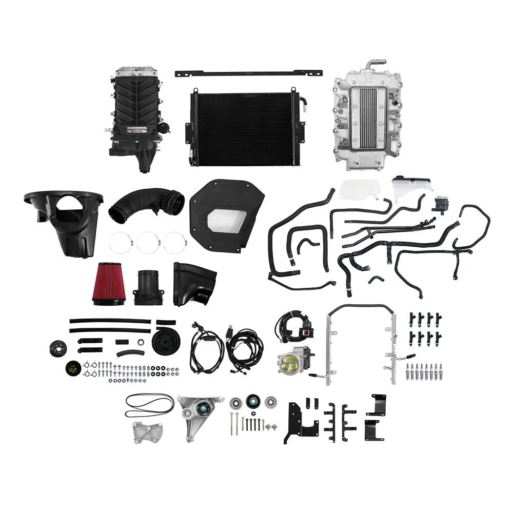

Roush Performance Phase 1 Supercharger Kit INSTALLATION on a 2018 Mustang GT
Roush 700 Horsepower Phase 1 Supercharger Kit for all 2018 5.0L Mustangs.
In this video, Bill will show you how to install the new Roush Supercharger Kit on your 2018 5.0L Mustang.
[ame="[MEDIA=youtube]ElAGkp4ydeQ[/MEDIA]"]
Raw power is just an install away for your 2018 5.0L Mustang. Roush delivers an impressive 700 Horsepower and 610 lb-ft of Torque with this badass Phase 1 Supercharger kit.
Compatible with your Manual or Automatic tranmission model, this kit features everything needed for an OEM installation on your 2018 Mustang GT. Intake, injectors, cold air kit, the supercharger itself, and everything necessary for a high-end install, this kit has it all.
TVS R2650 is at the heart of this supercharger kit at only twelve pounds of boost, making the 700HP easily in its larger design.
After the better part of a weekend, and closely following these video instructions you'll be back on the road in no time.
Tech Tips:
- 5W50 oil is required after installation.
- The use of fuel additives (i.e. octane boosters) is NOT recommended.
- Premium fuel (91 octane or higher) is required to prevent “spark-knock” or detonation under certain operating conditions.
- Operating your engine without the Roush PCM recalibration will result in engine damage or failure and will void your warranty.
*A 3-year/36,000-mile Limited Powertrain Warranty is included but ONLY when properly installed by a Ford dealer or an Automotive Service Excellence-certified technician.
Please Note: This Kit and the included Roush Calibration is NOT compatible with any 2018 5.0L Mustang meant for distribution outside of North America.
Order the Roush 700 Horsepower Phase 1 Supercharger Kit (P/N: 422090) for your 2018 5.0L Mustang from CJ Pony Parts today!
Note: This item is not CARB (California Air Resource Board) exempt and is not legal for sale or use in the state of California.

Hello Bill
Can I ask why this couldn’t be fitted to a UK car please?
Two reasons, 1 - The calibration that you would receive from Roush is only designed for use with vehicles meant for North american distribution, I am sure this could be worked around through custom tuning. And 2 - Fitment in general has not been verified by them. Due to the design differences on RHD drive vehicles, there may be some additional or different components that may need to be used. This is why they released a RHD conversion kit with the 2015-2017 Supercharger and they may do something similar with this, we just don't know yet.

What’s the reason for this?
Likely the same reason the grille delete won't work. Sensor location. The heat exchanger appears to mount in that location.
That and when the adaptive cruise commands 50% throttle (that is now supercharged) to catch back up to the car in front of you, it might make your asshole pucker.
We have since updated our product description online. According to Roush, this kit will be compatible with the Safe and Smart Package/Adaptive Cruise. They made sure to include that in the supercharger program this time around.
