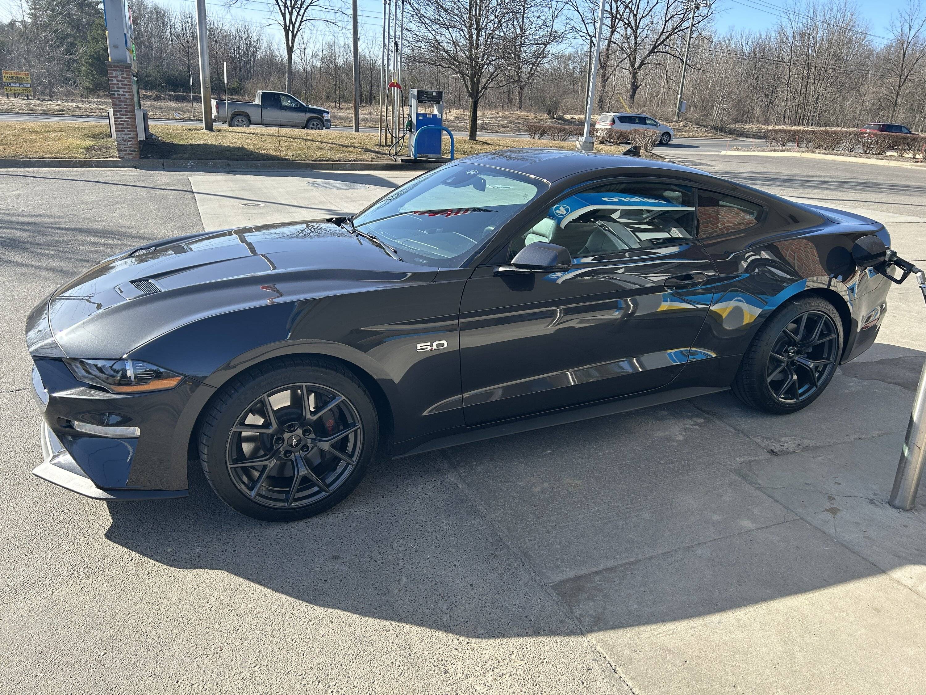

This is what I got, love it so far looks factory

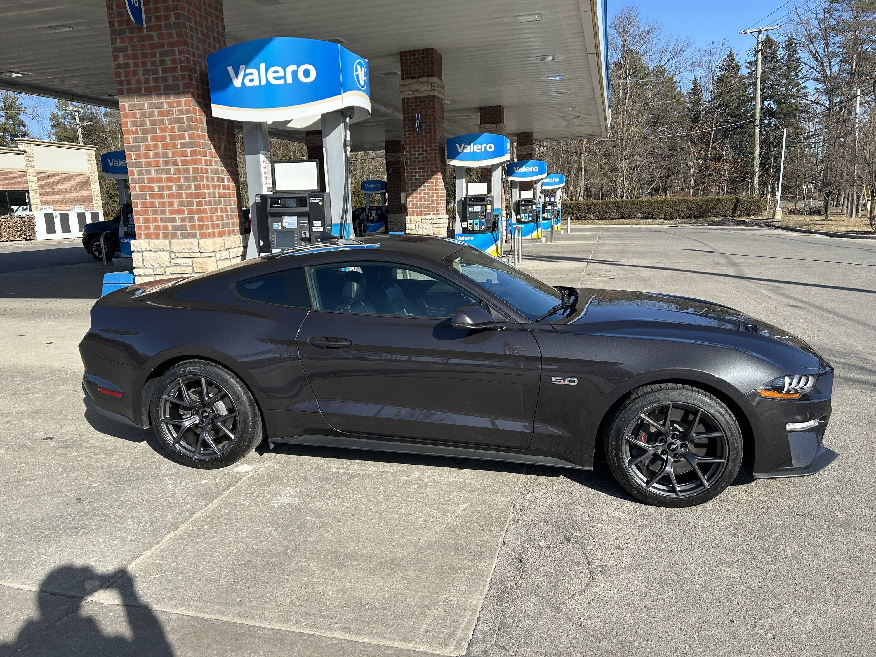

Here’s the car as it sits now with the PP2 wheels and Michelin super sports
