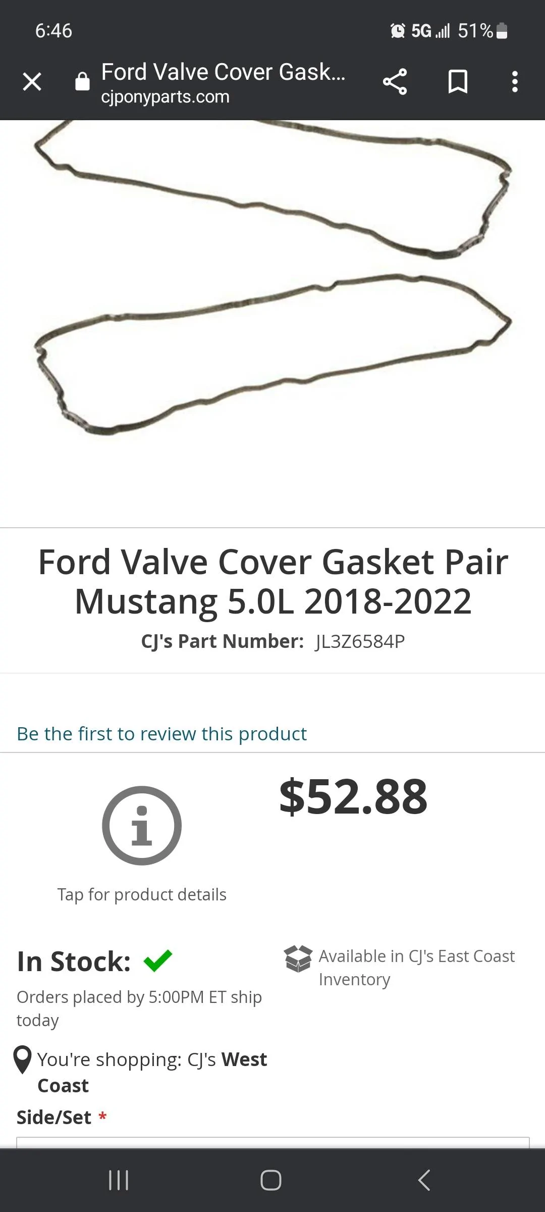

They sell just the gaskets so I doubt you have to buy covers to change them, especially on a car that's only 4 years old

This would seem to indicate otherwise. It looks like you get the gasket and bolts when you order a valve cover but they are separate pieces.
https://www.tascaparts.com/oem-parts/ford-valve-cover-passenger-side-rh-jr3z6582a
On other aftermarket sites the gaskets alone run about $45.
