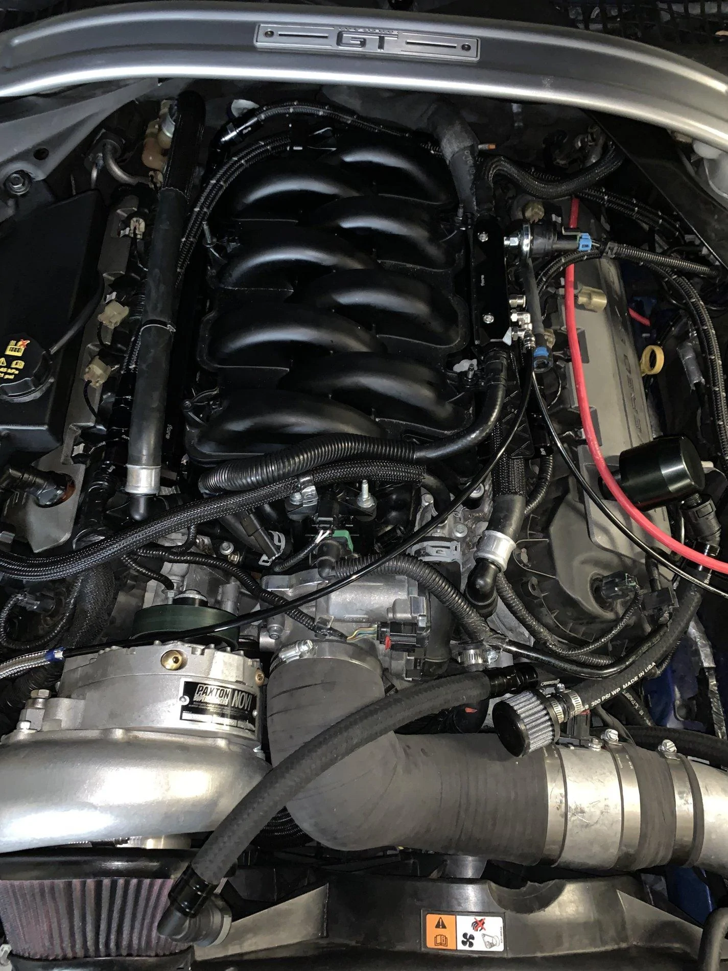

Kona 18
Delete the 4 way, run a hose from the manifold port straight to the vacuum block, then from the vacuum block to the brake booster. IF the hose on the manifold is larger than the vacuum block hose, use a reducer fitting to make it smaller. Any left over ports you cap
