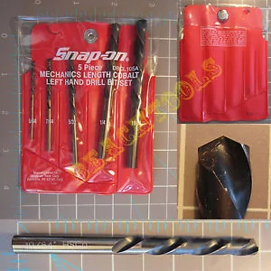

Something else to consider on extracting is left hand drill bits. They are quite nice as you operate your drill in reverse. I've extracted many bolts with Snap On left hand drill bits. Many times the bit itself will back out the broken bolt without even using an extractor.
Exactly what I used (along with a CNC machined guide) to back out the crank bolt I snapped off on my Terminator. Came out in like 2 mins.
