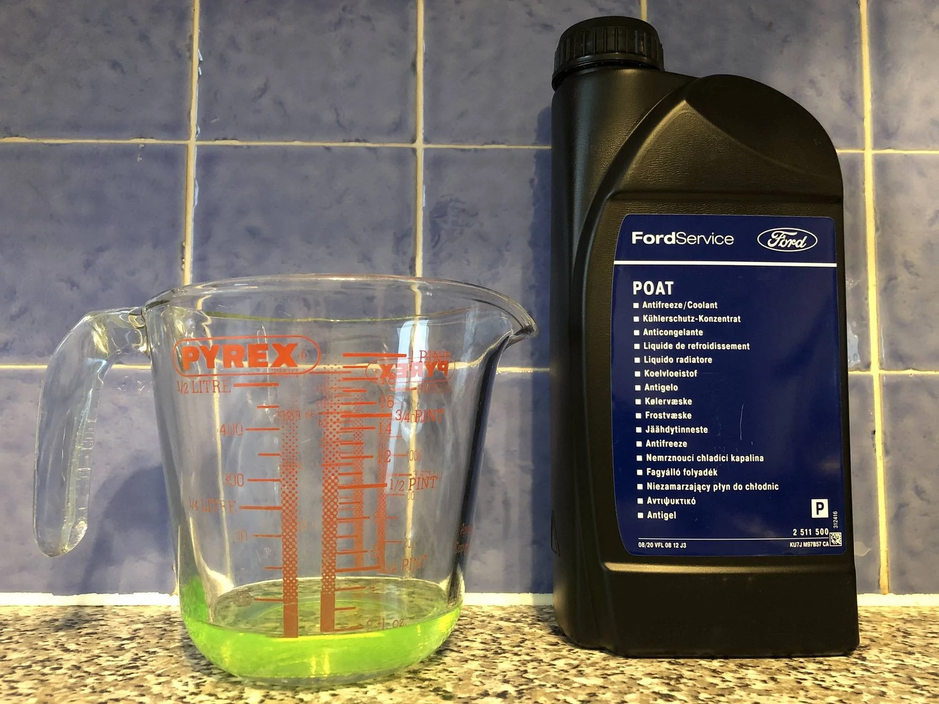

I don’t know why they call it yellow, as supplied by ford it looks green to me ... ?
WD :like:
I cant speak for fords logic (or lack thereof)..but my guess
1) they already have two IAT coolants that are green/labeled as green (premium and specialty green respectively, is speciality green IAT too? idk tbh.), they don't want to release a new OAT that is also named some sort of green as that may be even more confusing than the current situation, and might lead to people mixing OAT and IAT coolants and having an issue.
2) from what I've seen, orange, yellow, and green are also common colors for OAT coolants, they didn't want to bring another orange color in to replace the outgoing orange, maybe? and there is an HOAT (gold) coolant that is already yellow in color.
So MAYBE, they named a "green" coolant Yellow as an OAT to minimize confusion? I think any way they went with it, it was going to be confusing though. Unless they went with a purple color like some brands do.
This is from my limited knowledge and trying to make sense of it. lol

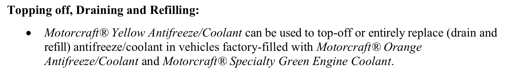

They're wrong. See the attached PDF.
Oryx
May 14, 2017
143
74
GA
2017 GT
This may help understand the ford coolants and compatibility

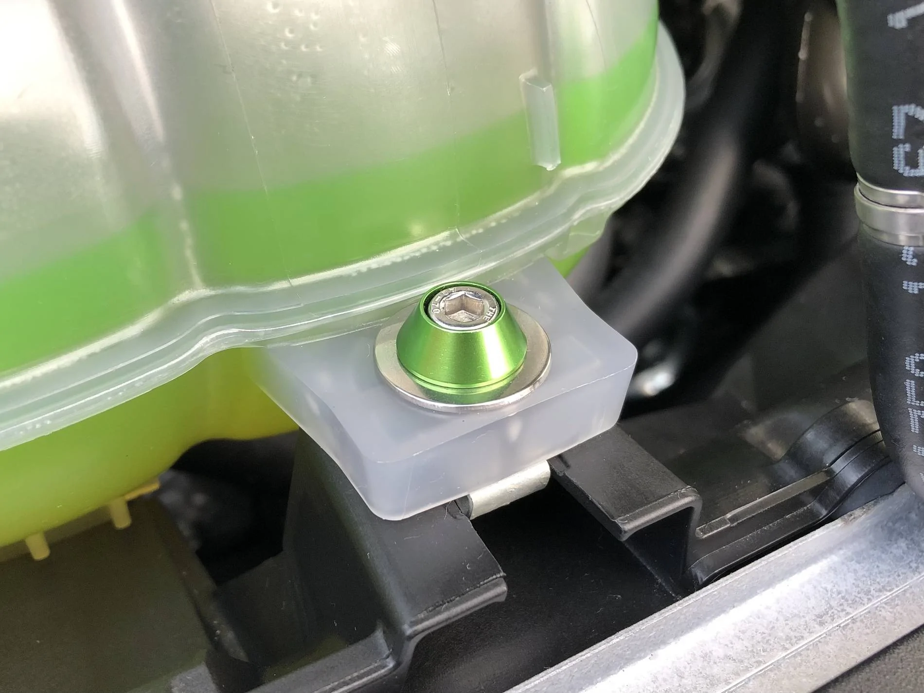

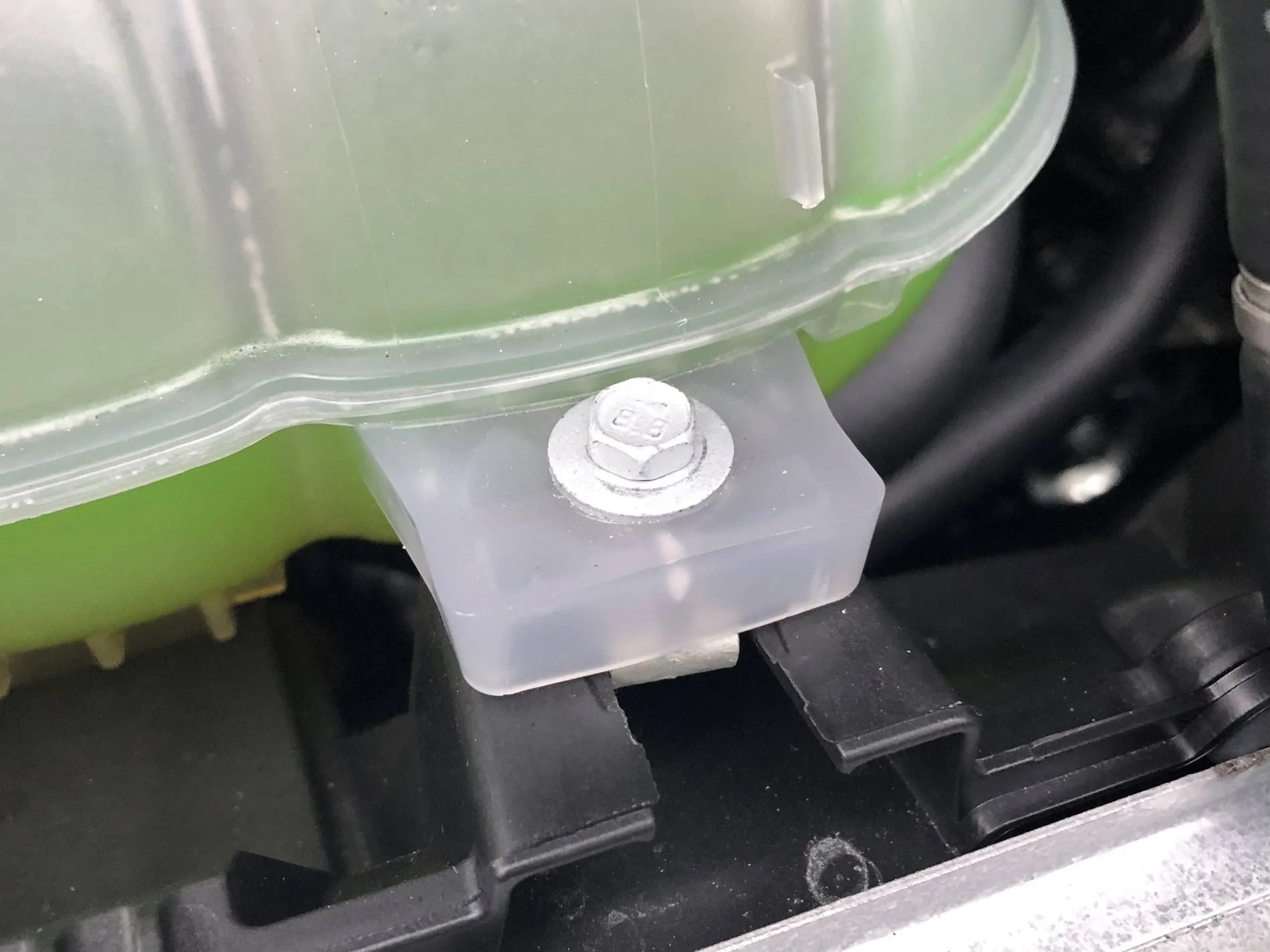

I topped mine off today with some Mountain Dew ... lol
It had done the initial drop from new, took around 350 ml to get it up to max on a cold engine.
Whilst I was at it, I took the opportunity to swap out the factory bolts :
To something with a bit more colour to match the coolant and the paintwork (and straighten the mounts / neaten the plastic) :
