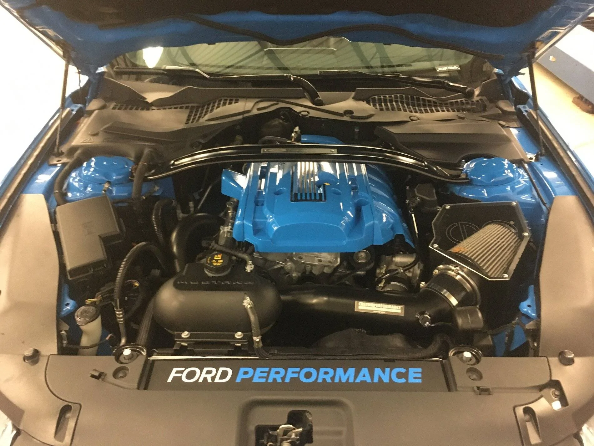

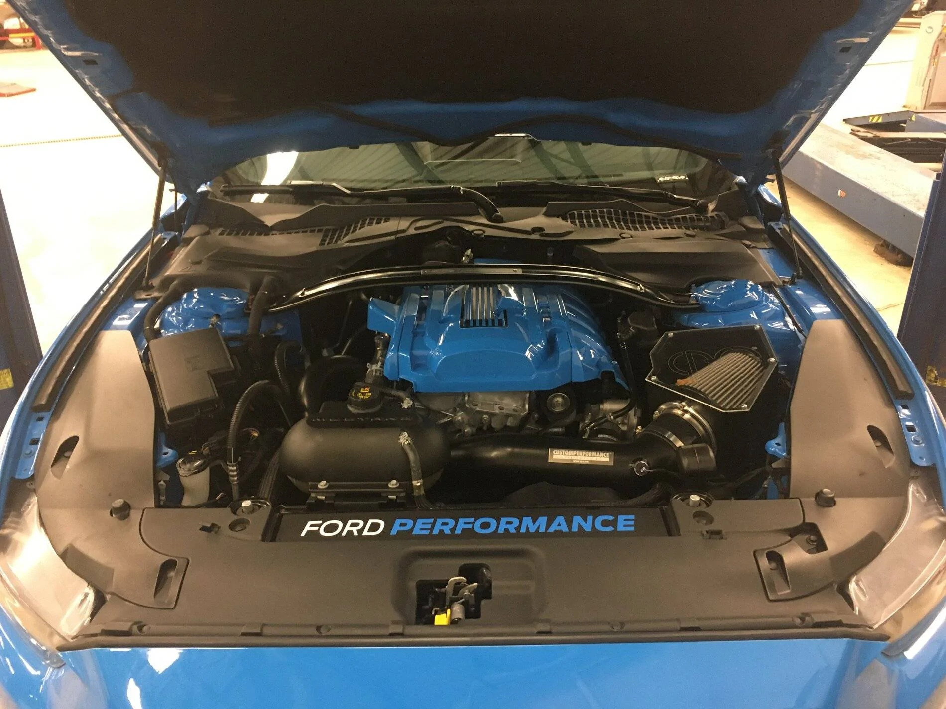

I like that black cover too, where did you find it?

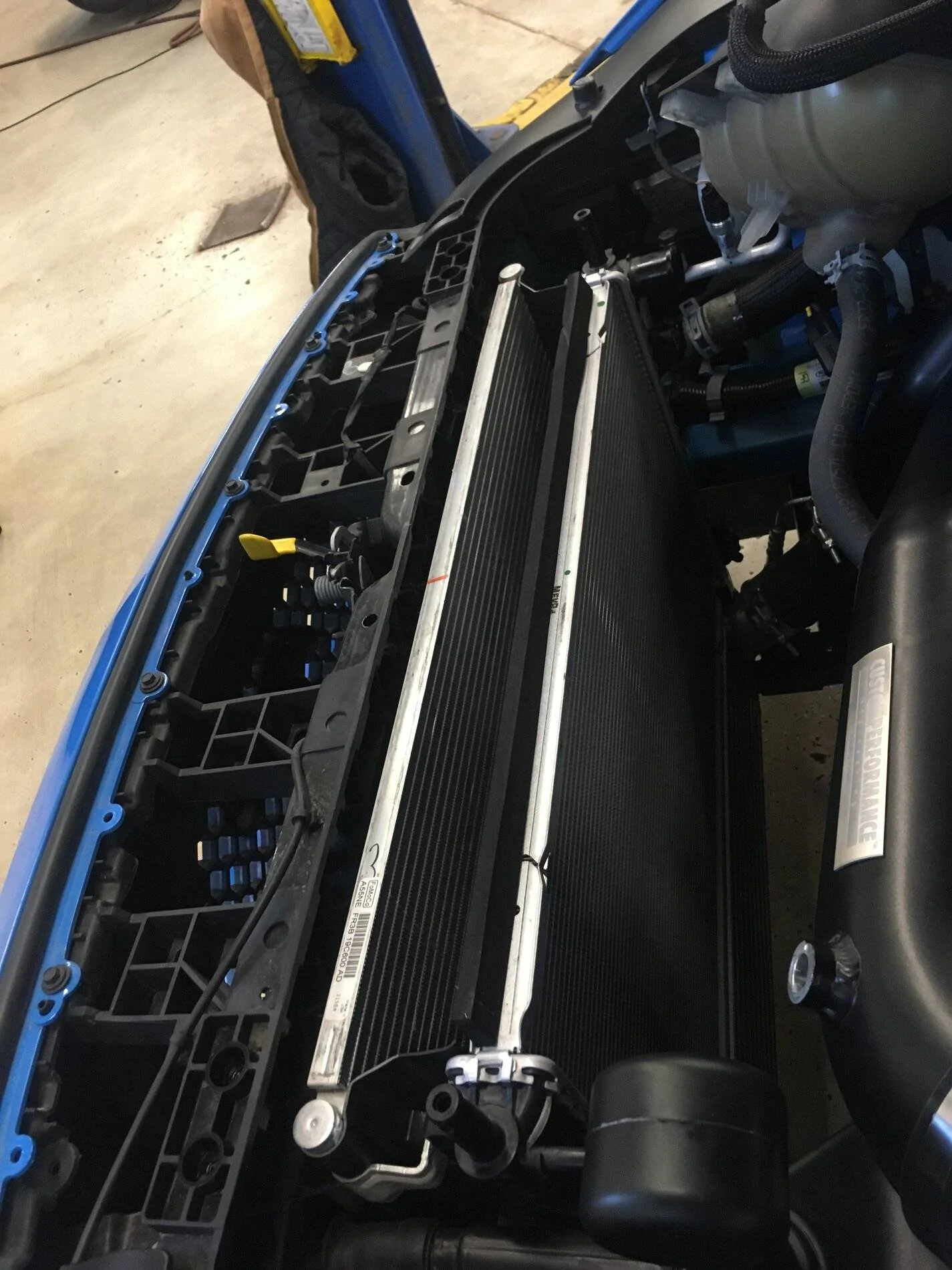

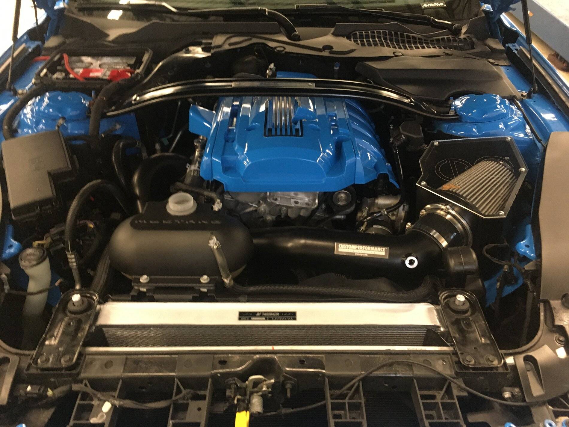

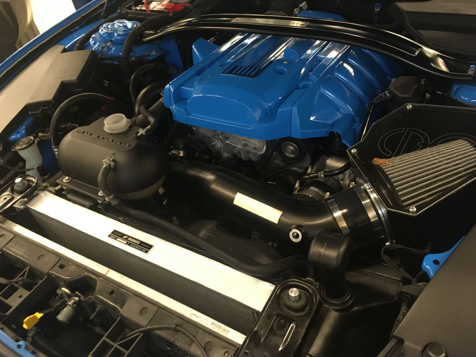

I like the black cover I have. I changed radiators yesterday, I had orange in system. I poured 2.5 gallons of new yellow into my system.
