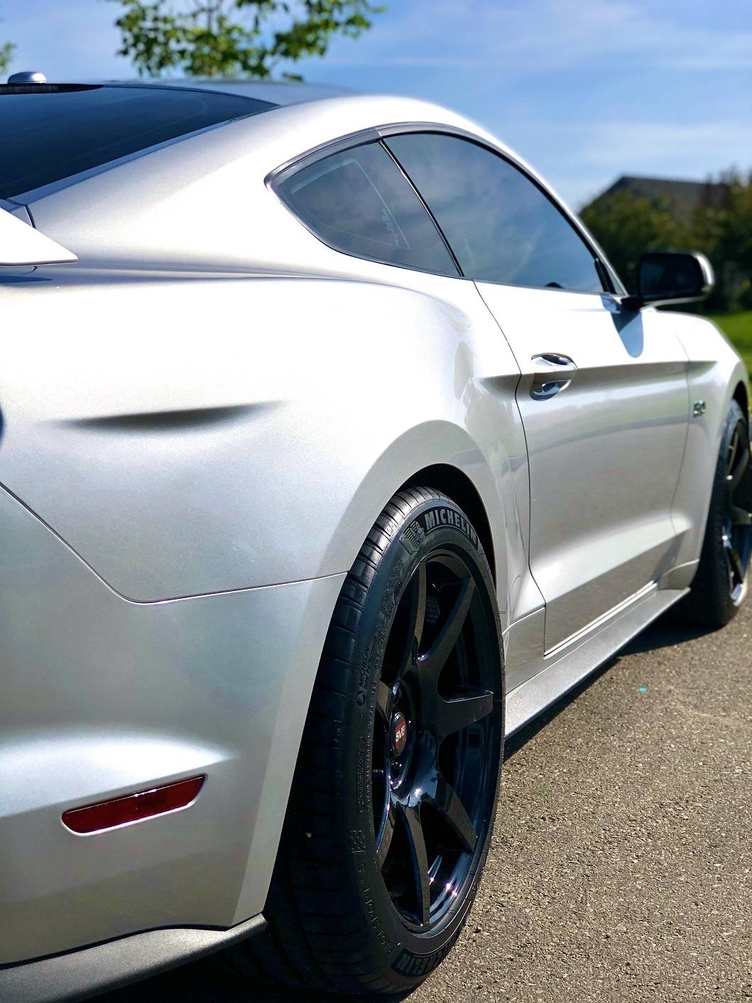

Agree that a 20x11 +35 will poke at the rear quite a bit - combined with the tire it would look funny IMO on stock suspension. For comparison, 19x10 +35 the upper outer lip of the wheel is essentially flush with the fender on stock suspension, and the tires poke slightly out from there. Due to the camber and the shape of the side of the car, they definitely poke at the bottom but it's a nice look without being silly IMO. Here's my SVE R350 19x10 +35 (all around):
