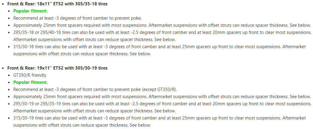

Hello All,
I have a 16 ecoboost. No brembo brakes. I plan on getting a staggered set of KMC district wheels in silver Part numbers KM68520512435 and KM68528512435. the Fronts being 8.5s and the rears 10.5. They are both offset 35 mm. i wanted to go 10.5 all the way around for the deep concave look all around but the supplier im ordering them from was pretty much no help saying "we cant advise that". Ive seen Gt owners do it that is why i asked. I will live with 8.5's up front if needed but i plan on running Mickey Thompson Street Comps all around, 305/35r20 in the back and 255/35r20 in the front. i am not lowered. Will this setup work? the supplier said yes, but he couldn't even tell me if i could run 10.5s all around so i dont find much confidence in trusting him. I know this was lengthy and probably a no brainer, but i just wanna be sure, as i cannot return the wheels when ordered.
