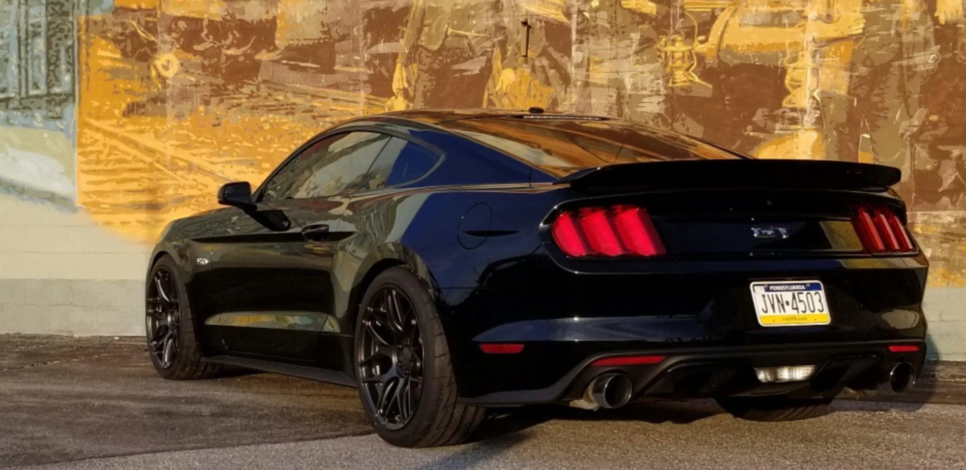

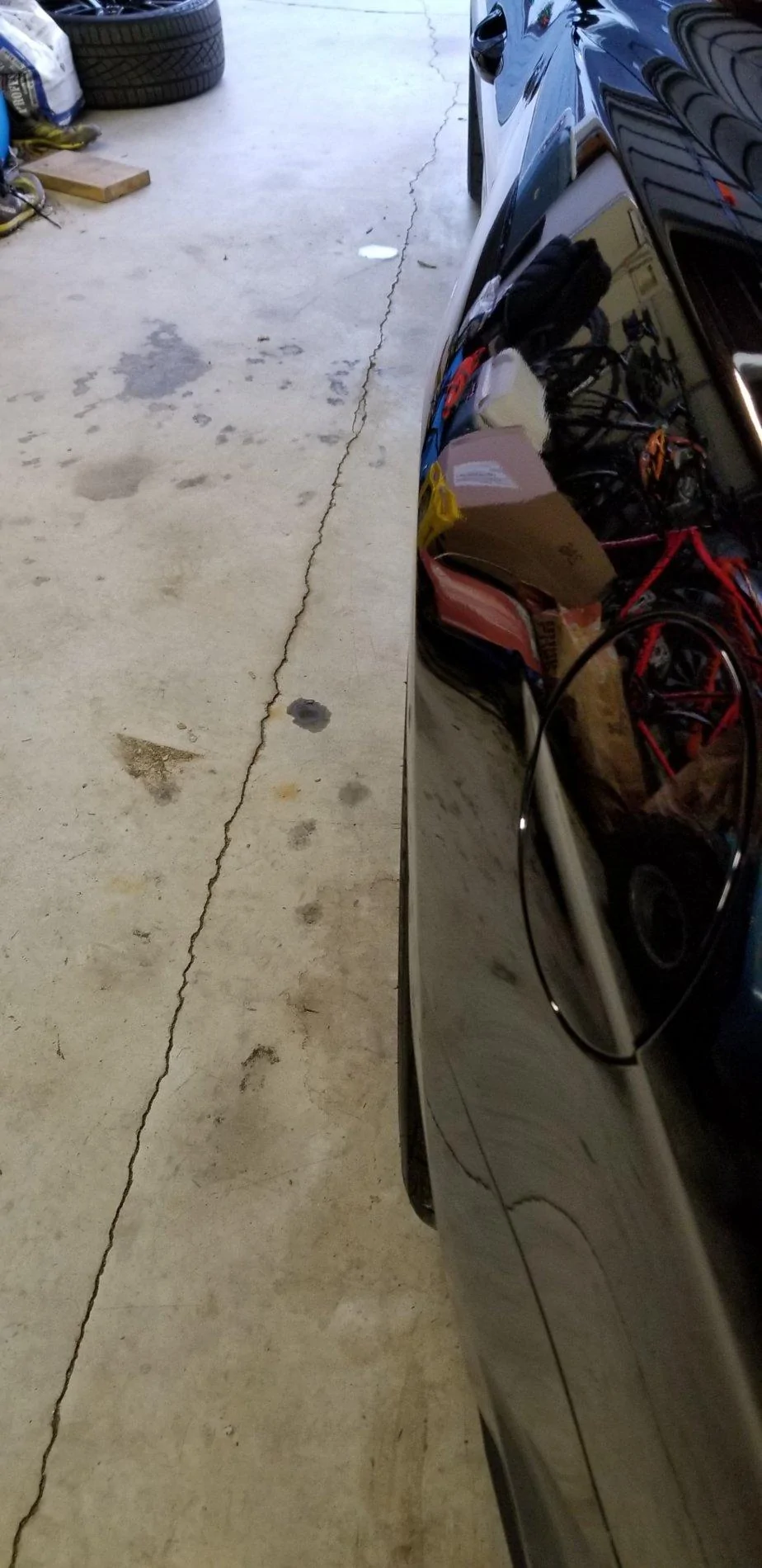

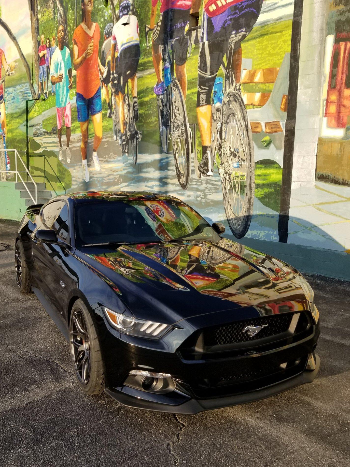

Here's my set up, Rovos Pretoria 20x10 et 38 with Indy 500's 275/35-20 sqaure. I got a great deal on them but I did alot of research to make sure the fitment was what I wanted. Im not a fan of poke but I love flush! Next set of tires I'm going up to 285's now that I'm sure they will fit, they will put me right at flush!
